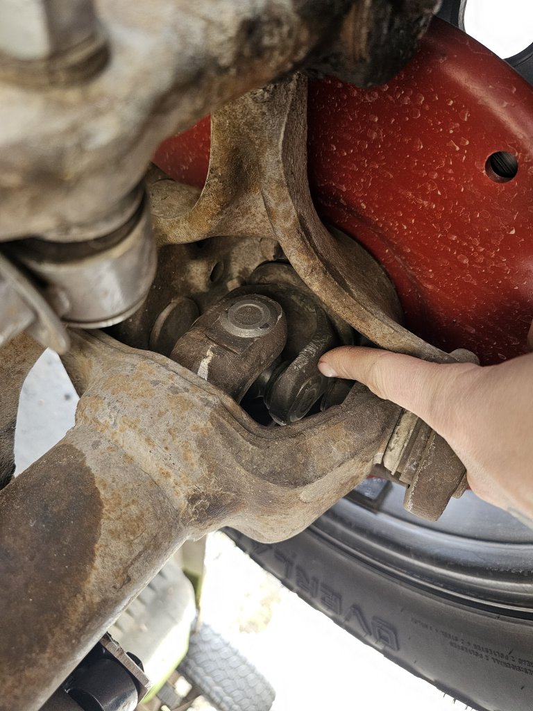

What part are you calling a "pinion"? I think we need pictures
Sorry, I'm referring to this yoke that joins the axle at the u-joint
Okay. That's your axle Shaft U-joint. The pinion yoke is where your front axle meets the front driveshaft. With full time hubs your front end is always spinning everything, even in 2wd. I'm guessing it's your front driveshaft because it wasn't making the sound before the lift kit install. Remove front driveshaft and see if the sound goes away.
