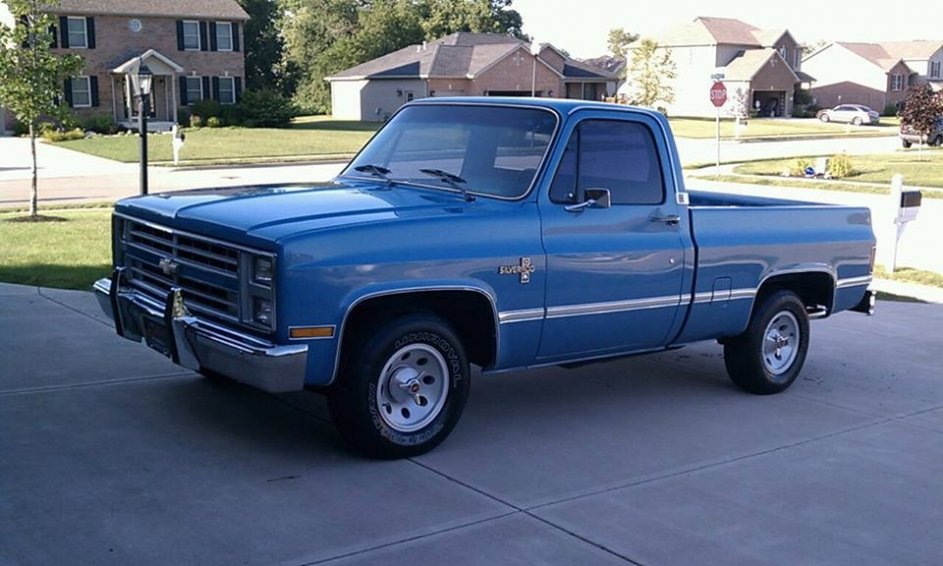

My '86 c10 swb left the factory rolling on steel rally's and 235/75-15's. Now it has aluminum GM van wheels (I think). My current tires are shot, so it's a good time to change wheels as well. 2 questions:
1) If I'm looking for original style Rally's, I'd need a 15x8 w/ 4" back spacing, 5X5 pattern, right?
2) Those of you running stock rally's and BF Goodrich Radial T/A rubber, what size tire do you use? The catalog doesn't list the 235/75-15 size as available.
I'll attach a pic of my truck so you can see my current rims. They'll be for sale (cheap) once I have the new ones on-hand. I'm not a fan of the spinners ;)

Those aluminum wheels you have are correct for that truck too, my Burb left Flint with those.

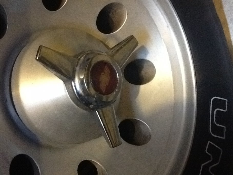

On the tire size question, I think I found what I was looking for... 255/70-15 looks pretty good to my eye. I found some pics on another site of a truck identical to mine with the rally wheels and the BF Goodrich tire size I just mentioned with white letters out and in.
I'll try to post the pics...

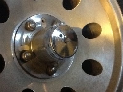

Bucket--> no idea what kind of spinners they are, but here are some pics. I believe the backplate is supposed to be mounted behind and through the wheel. But my previous owner mounted them in front with the lug nuts now jammed on top of them. The flanges will likely need to be hammered flat after I get them off the truck.

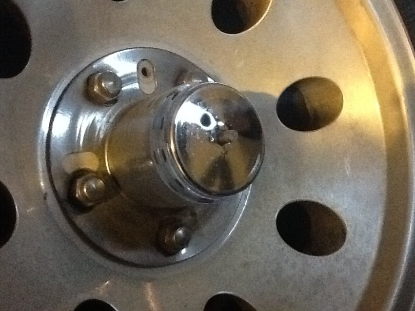

Spinner backplate
...backplate pic

Ooohhhh.... that's a combination of parts that aren't meant to go together. The chrome centers are meant to mount behind aftermarket wheels, then the spinners screw on the end and you tighten a set screw behind one of the blades, so they don't come loose. Those domed caps are for a different set of aftermarket wheels... maybe for a set of old Welds or something.
