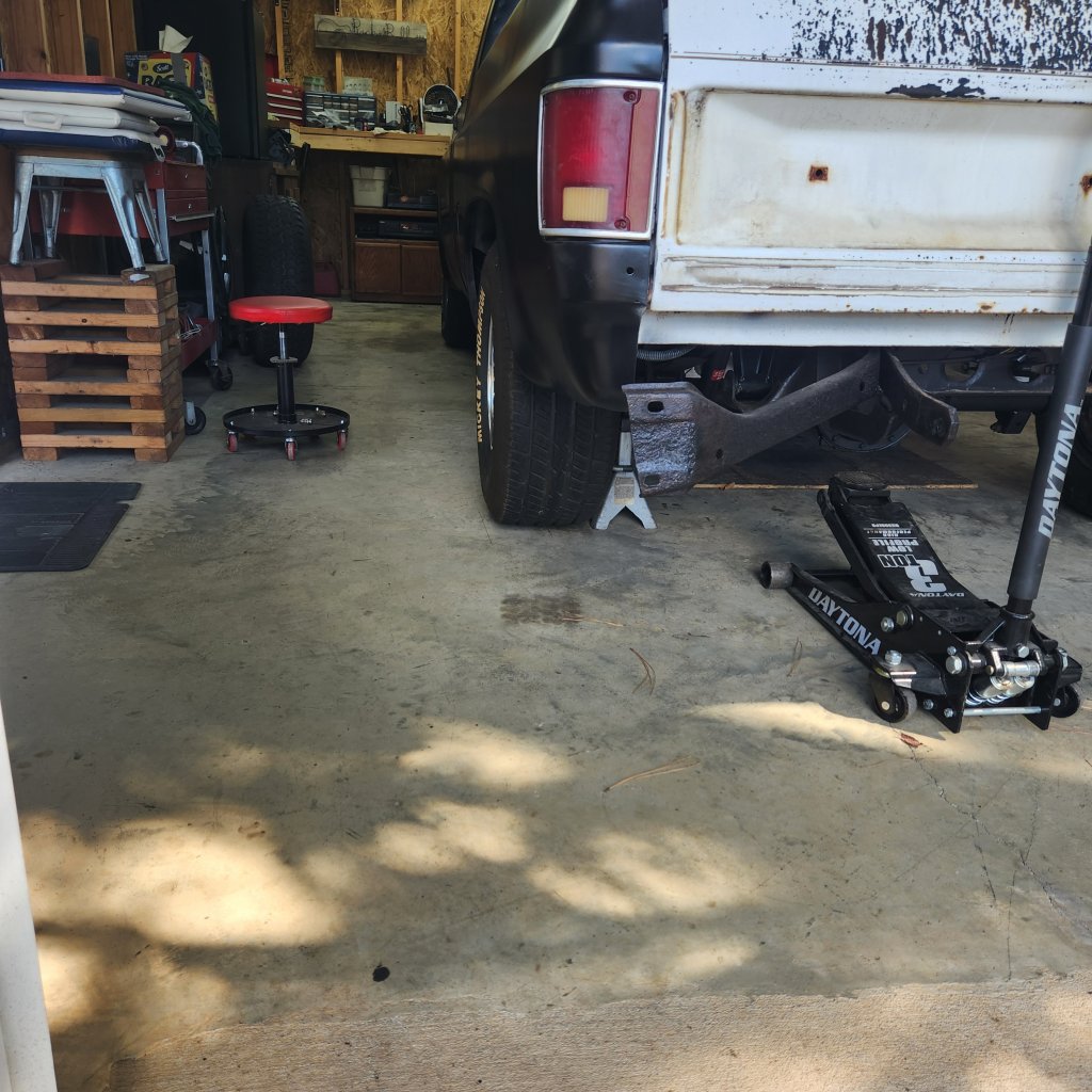

Ok, trying to get an idea of how the 10" 275/60-15 might look on the back. Side wall would be a little more vertical on it but I think the depth would be about right. This is the 275 on an 8" wheel off of my Camaro. Bolt pattern is different so I can't mount it but setting up against the studs is close. Only took me 2 weeks because I lost the key to the lugs and had to get a new one.

Thanks for the pics. That helps. I'm not quite as low so I plan to stick with the 60's. I think the 235/70-15 I plan to go with on the front will fit similarly to the rear with tire to rim width ratio. Should both look pretty vertical. Just need to get some more body work done and then I will order. His truck looks good by the way.
