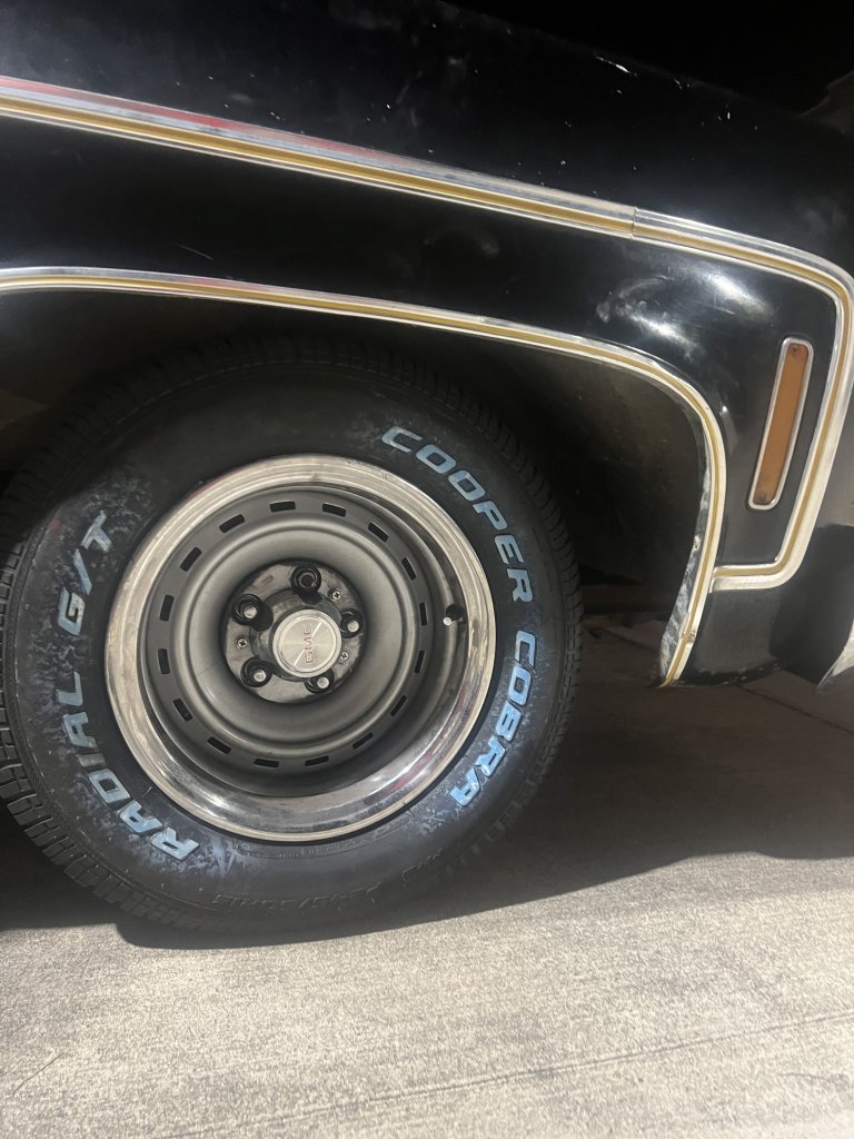

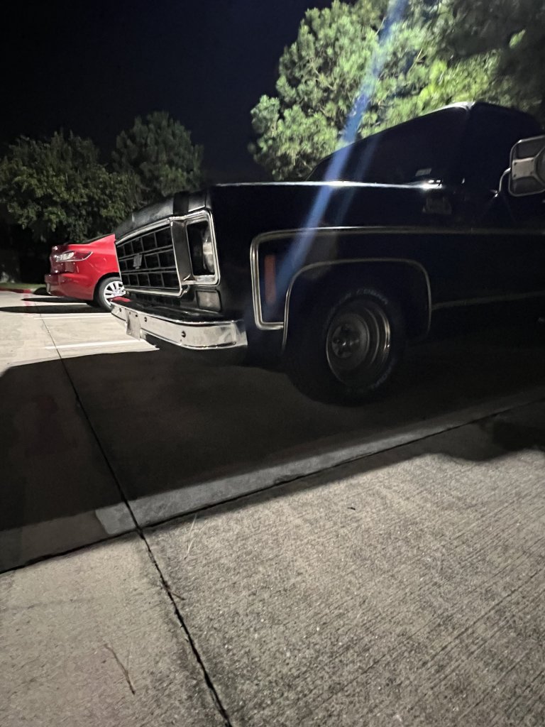

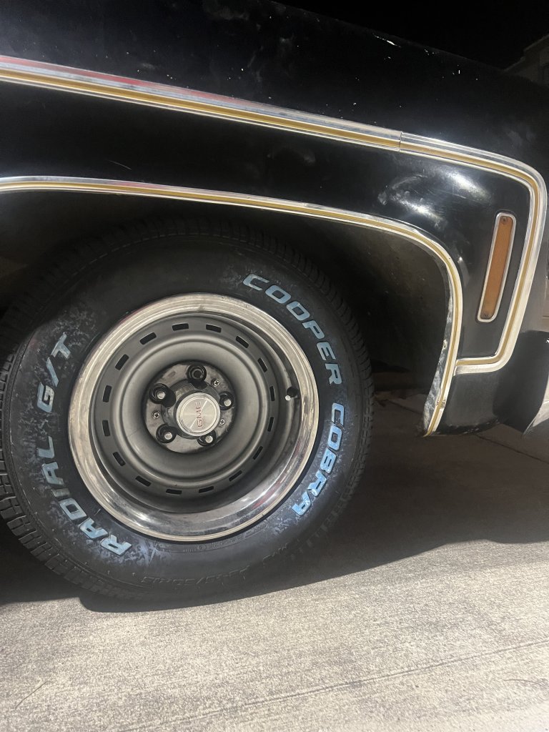

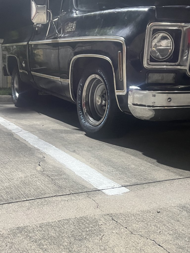

I dropped my truck 5 in the front and I was so hesitant on what tires I would run. After months of research and going back and fourth. I went with the 245 60 15 in the front and love the look. It gave me plenty of clearance. If you are running aftermarket lowering spindles then you have to grind lower control arm for it to clear and not hit the wheel on the rally 15x8 TRUST ME I leaned the hard way lol

THIS IS WHAT I NEEDED!!! You just gave me so much relief to my anxiety lol. I am doing the 5/7 belltech drop, and I ended up going with 255/60/15 cooper cobras. I really hope I don't regret this entire move. LOL
