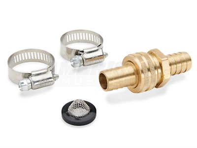

here's a little contraption I'm going to be putting on the truck, this is a coolant filter that goes in the inlet line going to the heater core, I got the idea from the Mustang forums, it keeps all the junk particles that are floating throughout the cooling system from getting into the heater core and plugging it up.

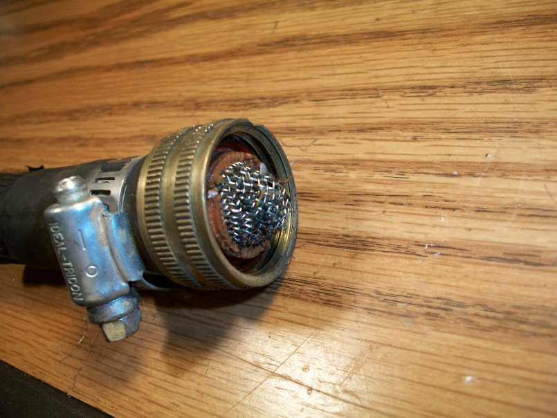

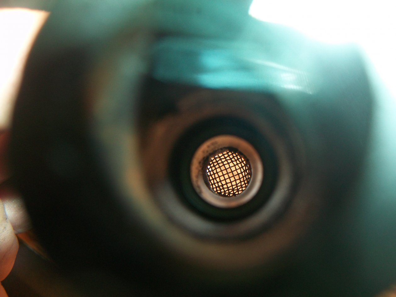

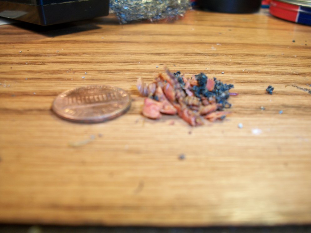

the pictures below are of the filter I've been using in my subaru for the last 40,000 miles, I haven't cleaned it in about 25,000 miles and noticed the other night coming home from work that my heater was blowing cold air, a good indication that filter plugged up, so I pulled it out today, took a few pictures, and figured I'd show them off ...I got a pretty good pile of junk out of it (next to the penny in the picture)
that orange-ie looking stuff is actually part of the gasket seal, I trimmed it up with an exacto knife to get it better flow, the black stuff is what was plugging up the filter. it even had what looked like a couple of pine needles in it not sure how those got into the cooling system though.

yup, that's all it is, garden hose ends, and the filter is what you use for a washing machine supply line.

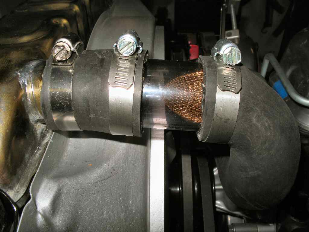

as far as the bigger filters, I use those to, I just haven't posted pictures of them yet ...there's two main manufacturers, Gano out of California, and Tefba out of Australia, I use both, the subaru has a gano filter in it, the one I have for the truck is a Tefba.
I prefer Tefba although I think they are a little high priced. (about $75 each) I got a special deal when I got mine, $30 each, I got one, and my brother took the other one to use on his Datsun 240Z with a chevy 350 conversion, that car can use all the cooling help it can get!
both filters are inline, but the tefba has a lid on it that makes cleaning it a very simple process.
the gaino I use in the Subaru I think might be a more efficient filter, but you have to pull the radiator hose apart every time you want to clean it.
the tefba has a bypass if it plugs up, the gaino doesn't, so you have to really watch them, if the normal operating temperature starts to rise, then the filter is starting to plug up, so I have to keep an eye on mine, but never have had an issue, and my subaru runs cooler than most, even when pulling a trailer, so I'm happy with the filters.
the first time I ran a tefba filter was in a jeep with a 318, it had about 90,000 miles on it when I first installed the filter, and that was right after I replaced the radiator in it and I had to clean the filter something like 3 times in a period of an hour and a half before I could even drive the jeep because of the debris in the system that was caught by the filter, and I went through the exact same thing with the subaru, but had to clean that one twice in an hour before I could drive that car.
I've had the filters in the subaru for the last 40 thousand miles and have not had any issues at all, and I do a lot of hard driving with that car.
it's my daily drive to work car (100 miles day round trip) and my weekend getaway car which can see an easy 500 miles a weekend when I'm out of town.
if you're not real vigilant about keeping an eye on those filters, you would be better of using a heater core filter only, if that plugs up, (which it will, and often at first) you only lose your heat, if the big inline filter (the Tefba or Gano) plug up and you ain't payin attention, it could cost you an engine.
when I first install the bigger filters, I watch it like a hawk for the first couple of hours before I even back out of the driveway, you will be cleaning it out no less than twice in a two hour period - guaranteed.
you would be amazed at how much debris and junk is circulating through the cooling system of your car or truck.
