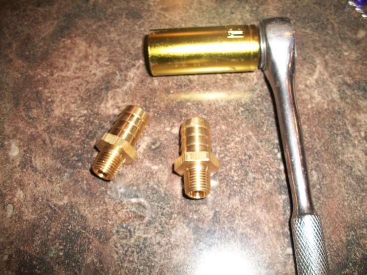

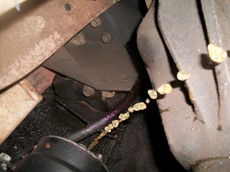

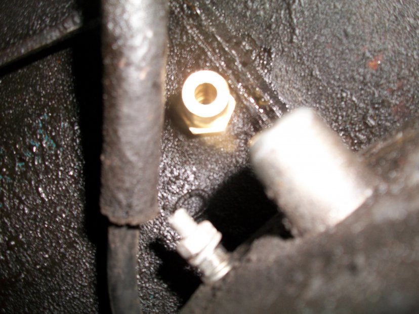

I got the lower block drain ports unplugged, (they were nasty and it took a few trys with a good screw driver to get them draining) about a gallon of nasty brown crud came out, I then installed my fittings for the garden hose, now to get the garden hose hooked up, it's kinda tight under there trying to do this in a gravel driveway with a bad back, somewhat painful, but I'm getting there :)

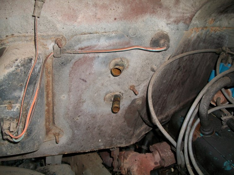

oh yeah, the heater core is completely disconnected from the engine, I'll be back flushing that separately. But using the same method.

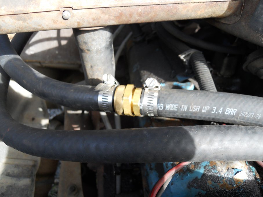

today, I got the hoses hooked up to the lower block, now I need to button up the top of the block and the hose outlets then I can start flushing, I'm thinking I might run straight water through it at first before I use any of the chemicals to get as much crud out as I can before I start recycling it into a big garbage can.

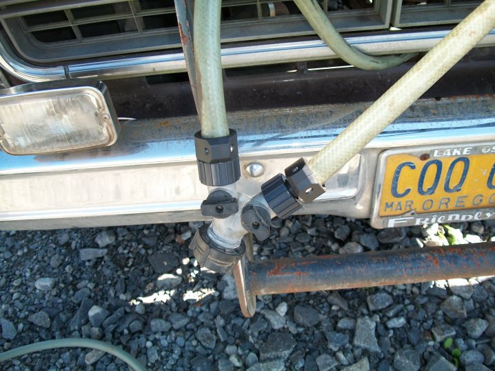

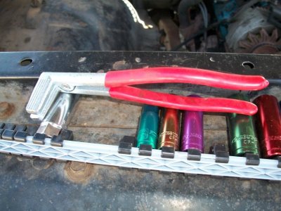

here's a picture of the "Y" adapter I'll be using, I'm also posting a picture of the battery terminal pliers I used to spread out the end of the garden hose so it would easily slip onto the barbed fittings, with those pliers, and a little WD-40 squirted into the hose ends, everything slipped together fairly easily.
I ended up butchering up one of our garden hoses for this job, (hope granny don't find out) when I'm done, we're going to have one garden hose with a few splices in it ....... if granny says anything, I'm pleading the 5th ..I don't know noth'en, I didn't do it, nobody saw me, can't prove noth'en!

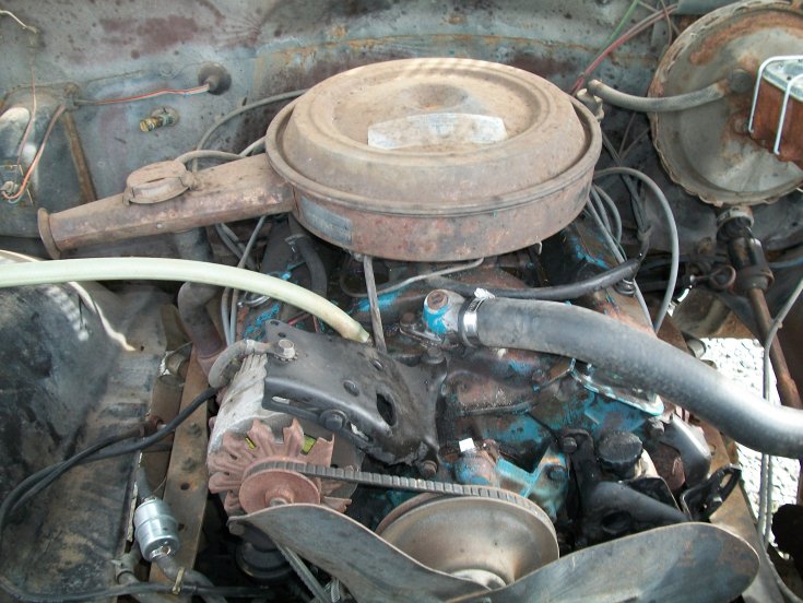

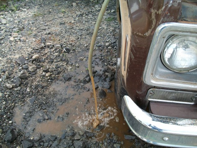

let the back flushing begin!!

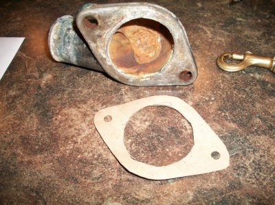

I got busy today and got something done, I made a temporary gasket for the thermostat housing out of an old toilet paper roll innards
finished plugging up the radiator hoses and other outlets and hooked a drain hose to the intake fitting for the heater core, and turned on the water.
then all that really ugly nasty brown stuff started coming out.
I'll probably let it run for a good couple of hours tomorrow before I do the chemical in the garbage can thing.
from there, I'll do some more engine clean-up, put the new water pump on it, do a little painting, then stick it all back together :)

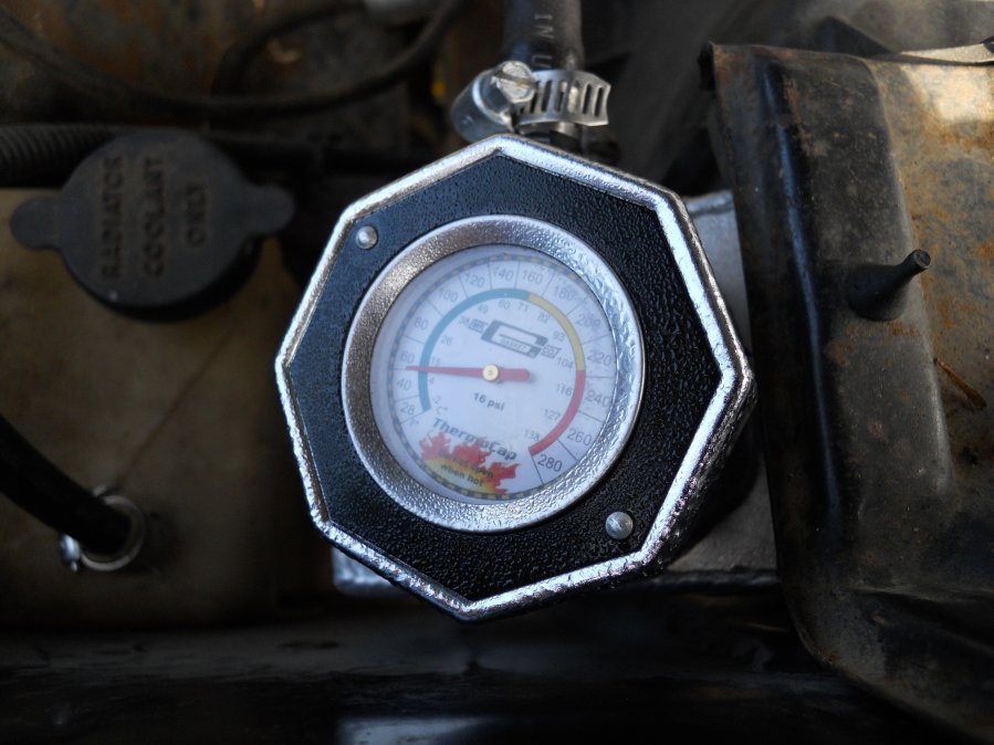

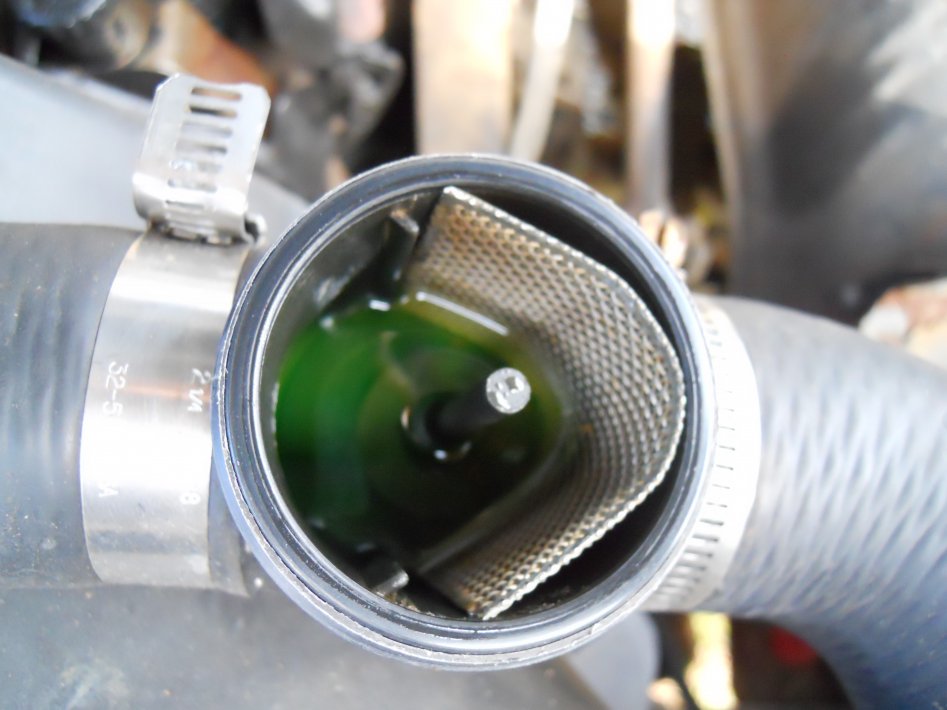

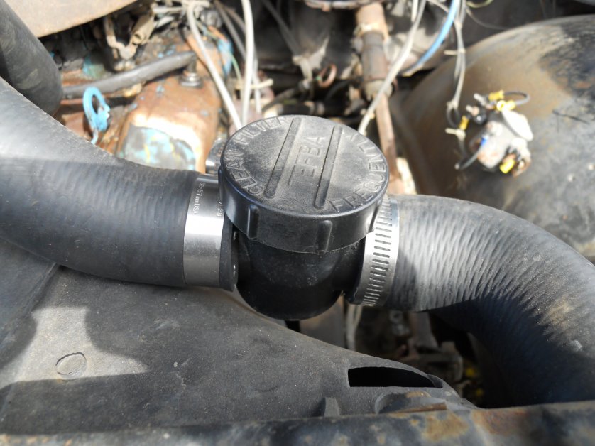

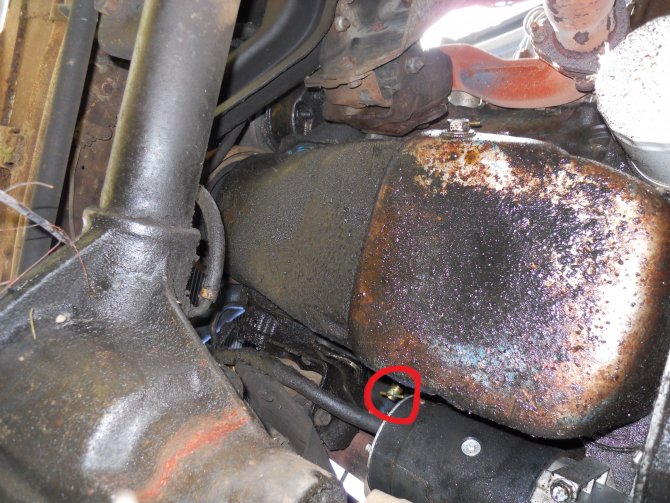

after some additional flushing, and replacing the lower block drain plugs with marine engine petcocks, I added a tefba filter, and another filter on the heater core hose, plus a radiator cap with a temperature gauge built into it, the truck runs good now, no over heating or coolant loss issues, and the Tefba filter is picking up a lot of junk out of the system so the junk isn't being circulated through the engine, radiator or water pump.

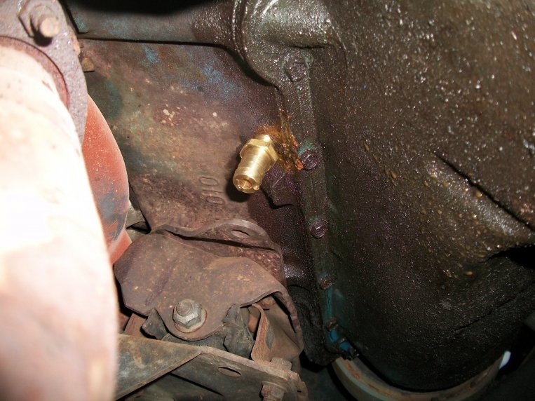

I used some Mercury marine inboard block drain petcocks on the lower block (circled in red)

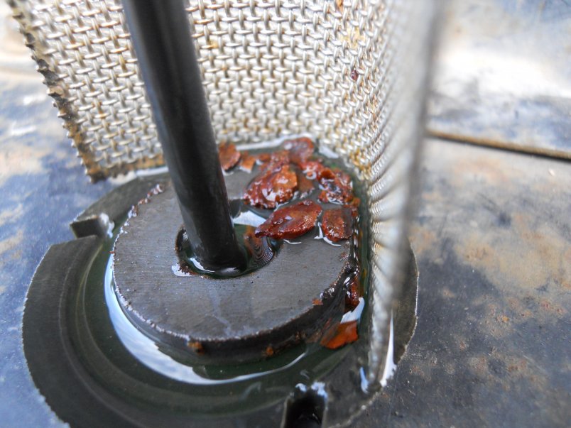

and here's a picture of some of the junk that the Tefba filter has been catching and preventing from circulating through the system, I've already cleaned the filter a couple of times, and this is what's accumulated after about 30 minutes of running since the last cleaning.

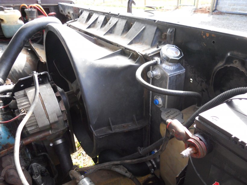

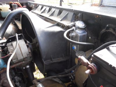

I was asking about dropping the oil pan over at the square body page on facebook, dropping the pan looks easy enough, but those guys said if I'm going to do the pan gasket, I should also do the rear main seal. that sounds a bit risky for a guy with my limited experience, one little slip trying to get the old seal out and I could gouge the crank, then I'd have all sorts of problems, so I'm going to think twice before I attempt that kind of repair.

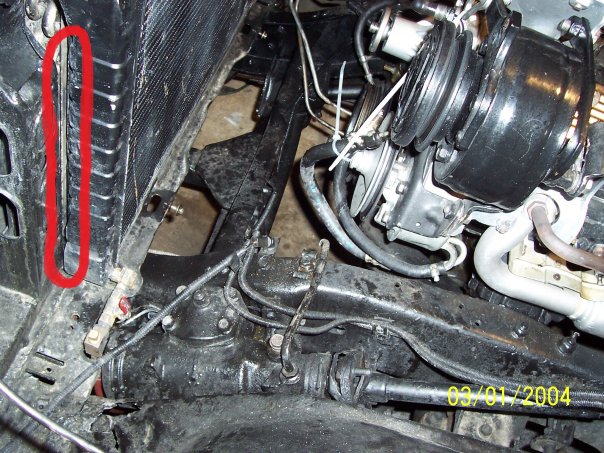

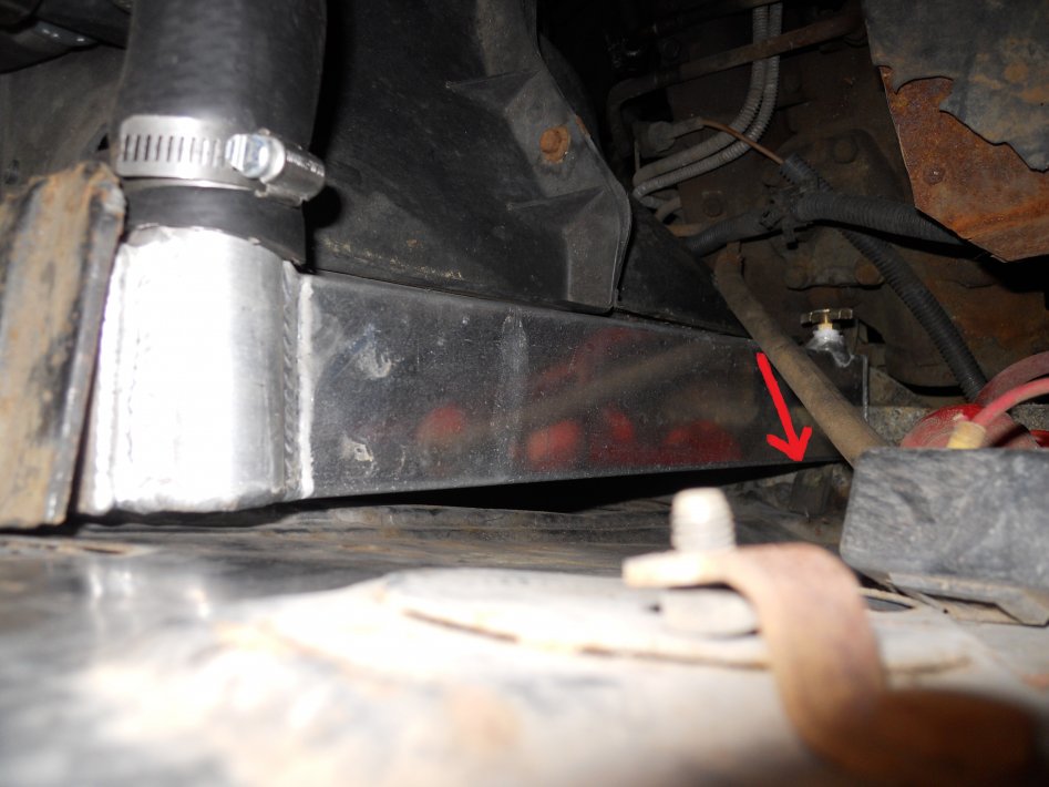

I was also looking at your picture of your radiator and it looks like it's sitting flush up against the front of the radiator support (circled in red in your picture) - if you look at the picture of mine, I think I got it a little out of whack, I'm thinking I should probably try to re-set it? take a look where the arrow is pointing. it's angled out away from the radiator support at the bottom.
