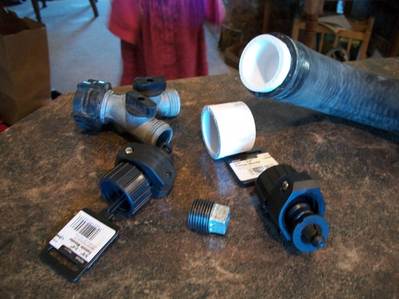

I haven't been able to put any time this weekend into the truck, but i did make it to Home Depot.
going off of chengny's idea to plug up the block except for where the fluid is going to come in, and go out, I got the following stuff
the flush drain is going to come off the 5/8 inch heater inlet off the manifold, so I got a 1/2 inch iron pipe plug to put in the heater return line on top of the water pump.
I also found that if I leave the lower and upper radiator hoses on the engine, an 1-1/4 inch abs pipe plug fits perfect in the end of the radiator hose, so that plugs up all the outlets except the one I'll use for the drain.
I also dug through some junk in the shop and found a garden hose "Y" adapter, so I got some fittings for it so I can butcher up some old garden house, and make an adapter that will fit those two lower drain ports on the bottom of the block, plus I need to cut a length of hose to go from that 5/8 fitting in the manifold and run it down into the bucket I'll be pumping the cleaner into and out of.
everything came from Home Depot, so I didn't have to drive all over town gathering stuff up.
I figured I'd show a picture of what I got just in case someone else gets the idea of doing a back flush like I'm about to do on mine.
I think I still need to locate some junk garden hose (maybe from the free section off craigslist?) and also want to work something out for a water pump ....I'm still thinking on that one.
and it wasn't more than a month ago I hauled a bunch of old trashed garden hose off to the dump, now I'm thinking I shoulda held on to it just a little longer.

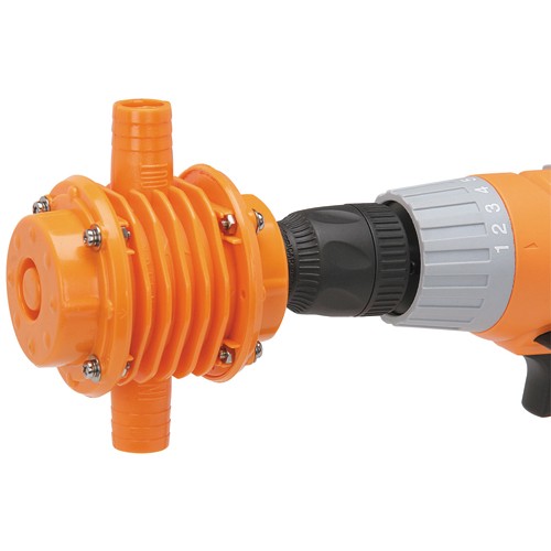

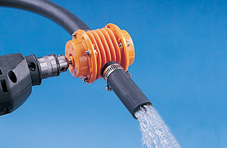

ok, here's what I'm goning to do for a pump, I think this is my cheapest way out.
this little bad boy will pump up to 650 GPH, costs less than 12 bucks, and I can pump just about anything with it, and chuck it up on my 1/2 inch wrist twisting high powered drill.
and if i bust it doin the job ...hey I'm only out less than 12 bucks.
http://www.harborfreight.com/heavy-duty-drill-powered-pump-98384.html
first a word about Harbor freight, knock them if you will, but there's some bargains to be had at that place and you can't really go wrong with them. although i wouldn't recommend buying parachutes or birth control devices from them, just about everything else is a safe bet at least through the first use.
I never go into that place without a pocket full of coupons, you can always get something for free, and at least a 20 to 25% discount, which would bring that little pump down to $11.25, I think that's a fair price for something if it works, and the pump has some good reviews to.
I always go here for the coupons, print them up off the computer, then hit harbor freight on my way to work. the current coupons are always located at the bottom of the first post.
http://slickdeals.net/f/1276399-Harbor-Freight-Coupon-Thread

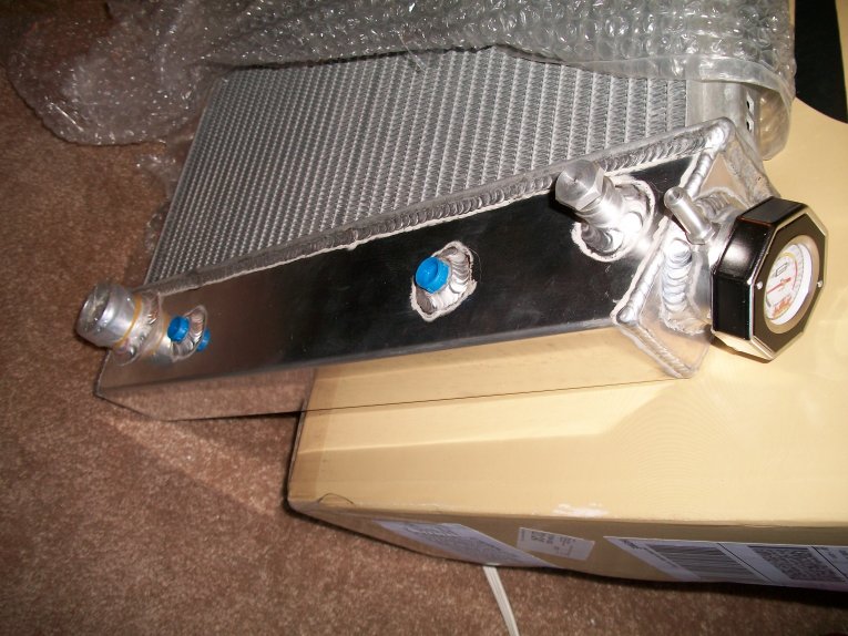

here come some more pictures of the new vs old radiators.
one of american eagle claims to fame is that their radiators have more rows of cooling tubes then the copper brass counterparts, so I counted the tubes in both radiators, and yeah, their right
the old 3 row brass copper radiator had 40 rows of 3 tubes, and the new aluminum had 42 rows of 2 tubes, but as you will see in the picture, on the aluminum radiator, the very bottom tubes are blocked off, which leaves the aluminum radiator with 41 rows of working tubes. still 1 more then the copper brass radiators it replaces.

Does the one you bought have the tranny cooler provision? Even if you're not using it now, it's possible to cap it off for future use, right?
oh yeah, I actually wanted one without the transmission cooler, but they all come with them these days unless you have something custom built without the cooler, mine came with the tranny cooler, I have a 4 speed manual transmission so I won't be needing it, so I'm just going to to leave it capped off and forget about it, but the tranny cooler is built into the radiator and very well sealed, so capped off or not, it won't make a difference.
personally thinking about it now, I kinda like having the cooler plumbing in there because at some future date, I might experiment around with it, maybe try to turn it into a hot water heater or something? might work to heat up some water for a quick cup of coffee? who knows? but I'll do some internet searching and see what other ideas people have come up with for it.
meanwhile, looking at the two photos I posted, you can see it's a well sealed unit.
It most definitely looks tightly sealed. I'll definitely be going with either AE or Champion for my rad replacement (which should be over the next few months)

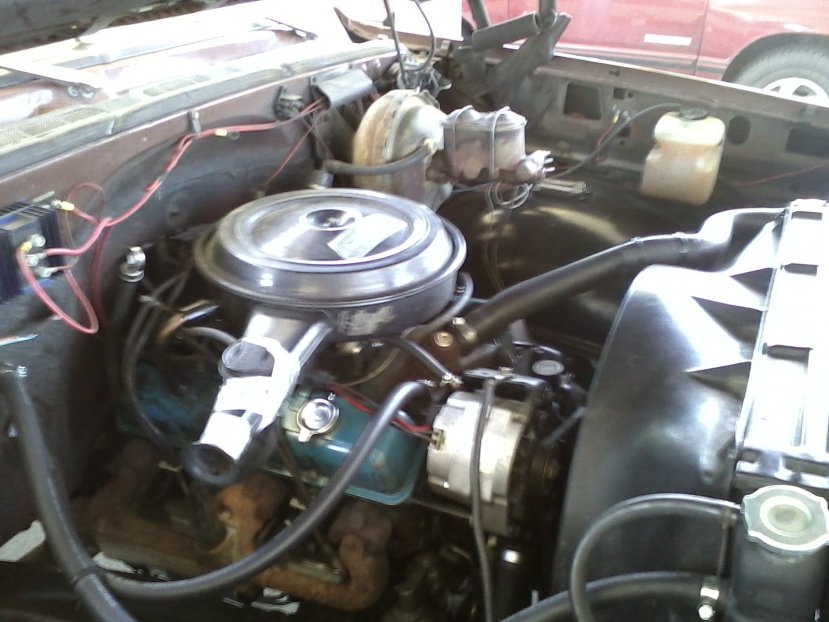

on another note, while up at the gas station today, I found a truck identical to mine, right down to the color combo, and the guy let me take a few pics, I'd be happy if mine came out half as nice as this guys
