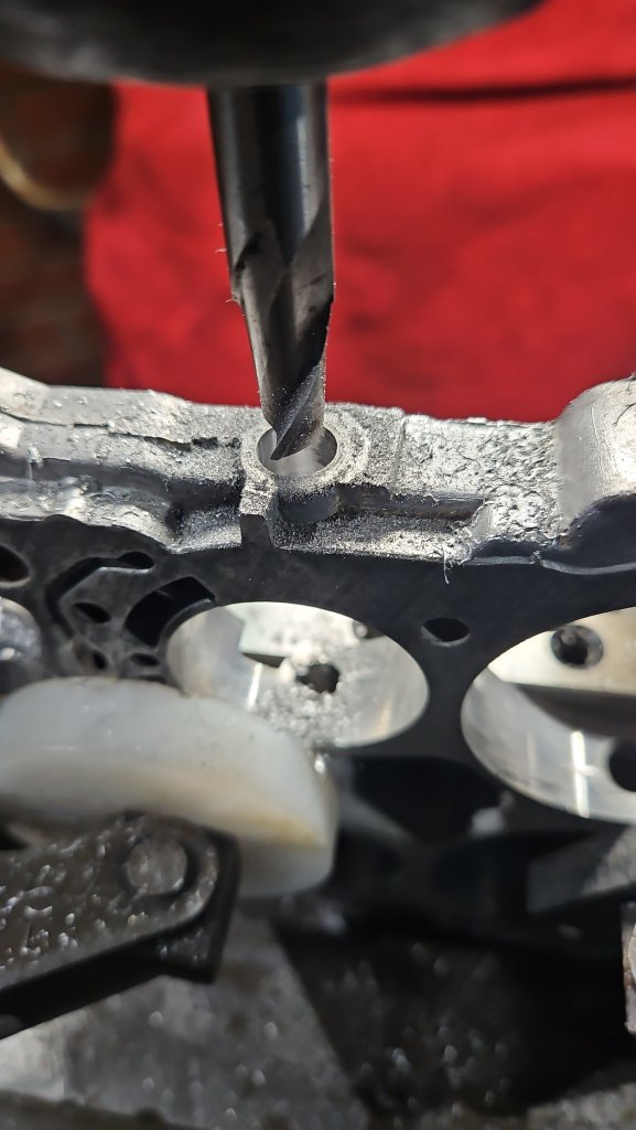

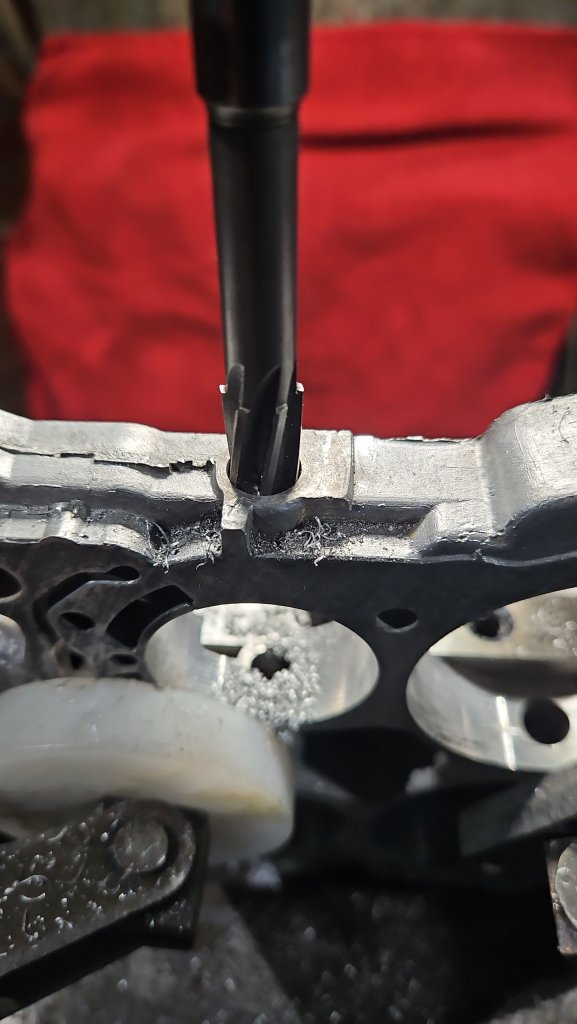

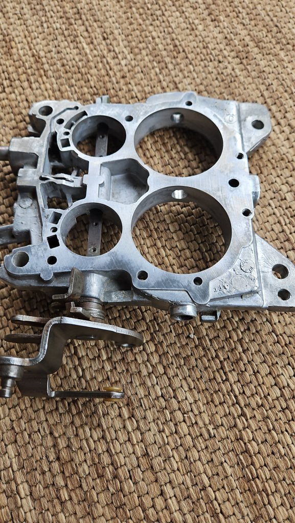

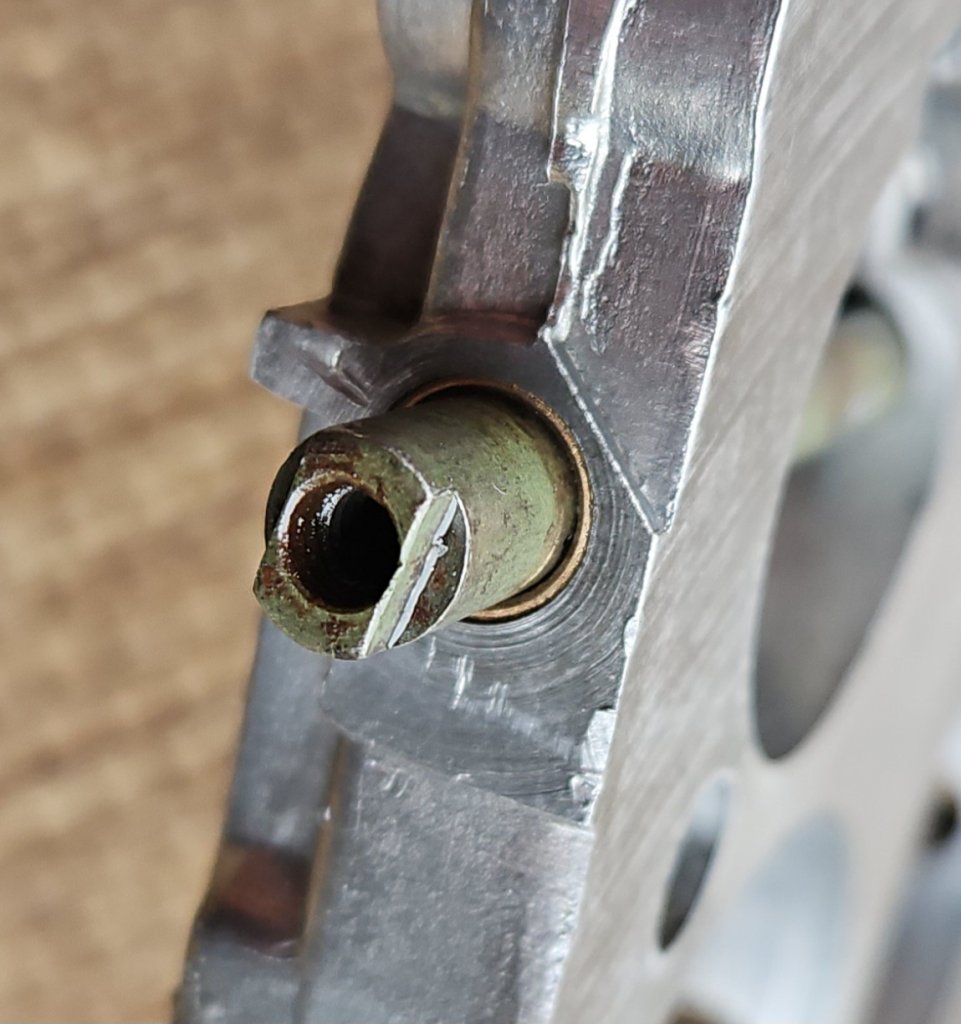

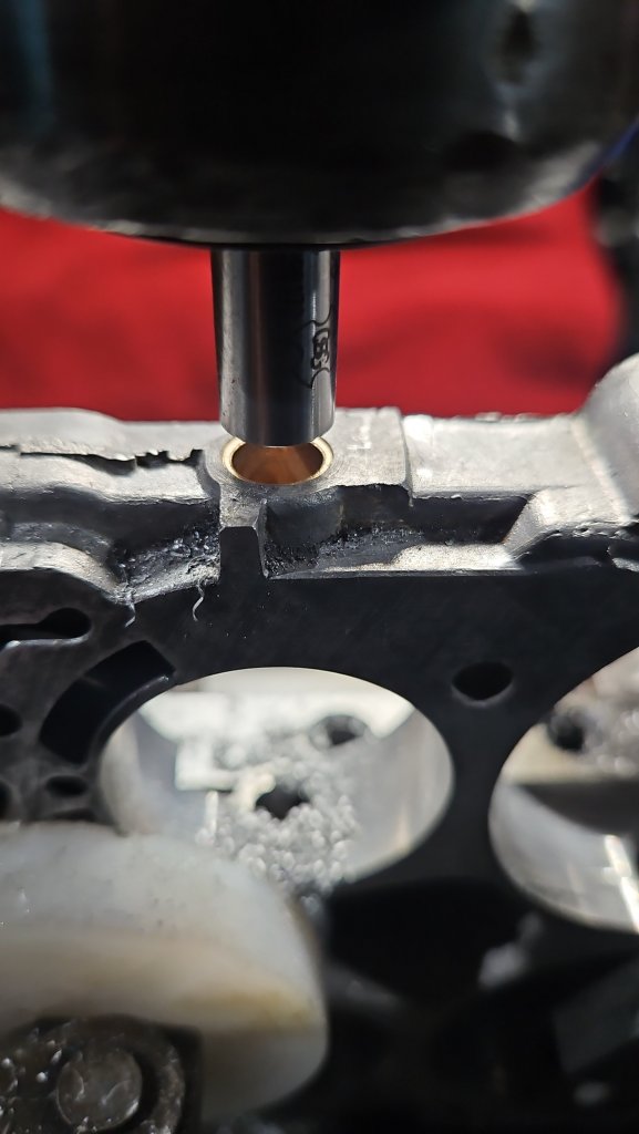

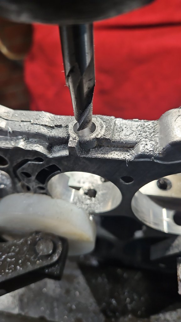

This is the setup on the mill to bore and ream for the bushing.
Prior to machining, I checked the bore and shaft with gauges and a mic.
The shaft is 0.311.
The bores checked 0.318.
A nice slip fit for a rotating shaft is 0.0015-0.002.
And at 0.002 end, you start to feel play in the fit.
My shaft and bore had a "stand back and toss the shaft in" clearance. (.007)
Had I installed a carb rebuild kit and bolted the carb on, it would have never run right. And just to be clear, you can easily see daylight through a .003 gap.
If light is getting through, so is air.
The shaft is 0.311.
I think I need to get this process done on my TBI throttle body - there is definite play on the butterfly shaft. This is also a common problem on the 50 year old SU side-drafters found on British cars (which I also need to get done).

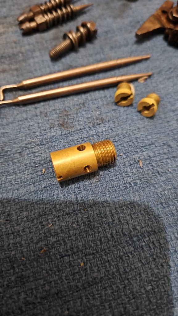

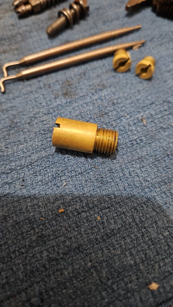

So here is one mod I like and I got the idea from a rebuild kit I had seen.
The float seat had been slotted to assist in fuel flow.
So I cross drill mine, unless the rebuild kit comes with a modified seat.
