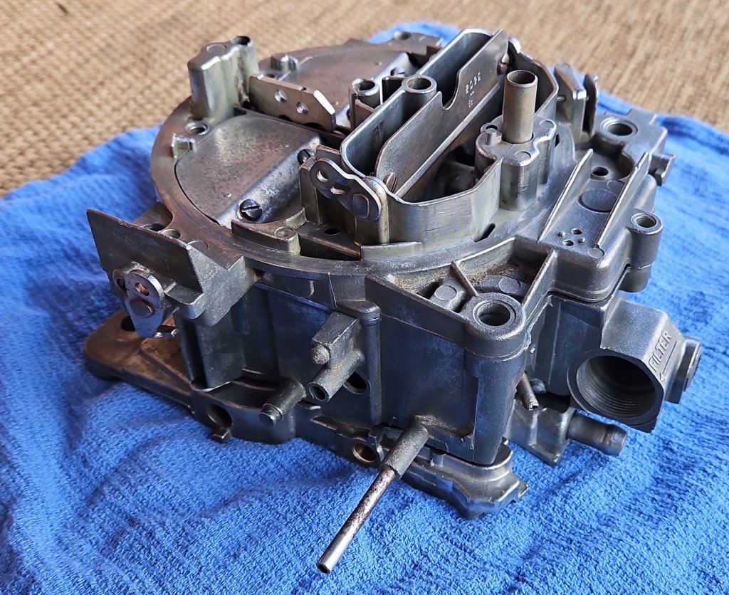

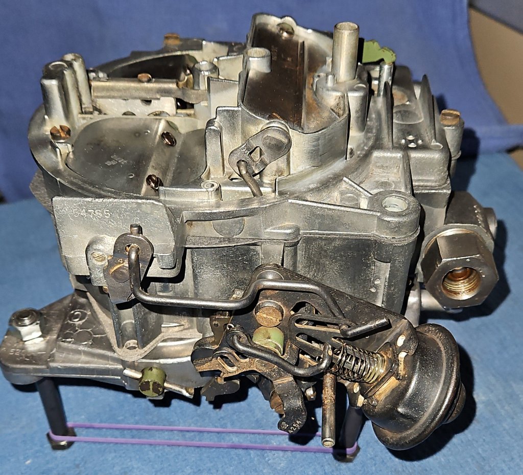

So while I wait for the carb rebuild kit to arrive, time at the soft wire wheel removes the crust and brightens things up. If it was much warmer out, rustolum silver paint would be shot on all steel parts. But since it's only 25° outside, I'll have to do something else.
I have thought about bluing the steel parts, which would look kewl, but eh, idunno...
We'll see...

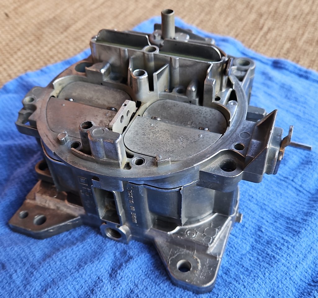

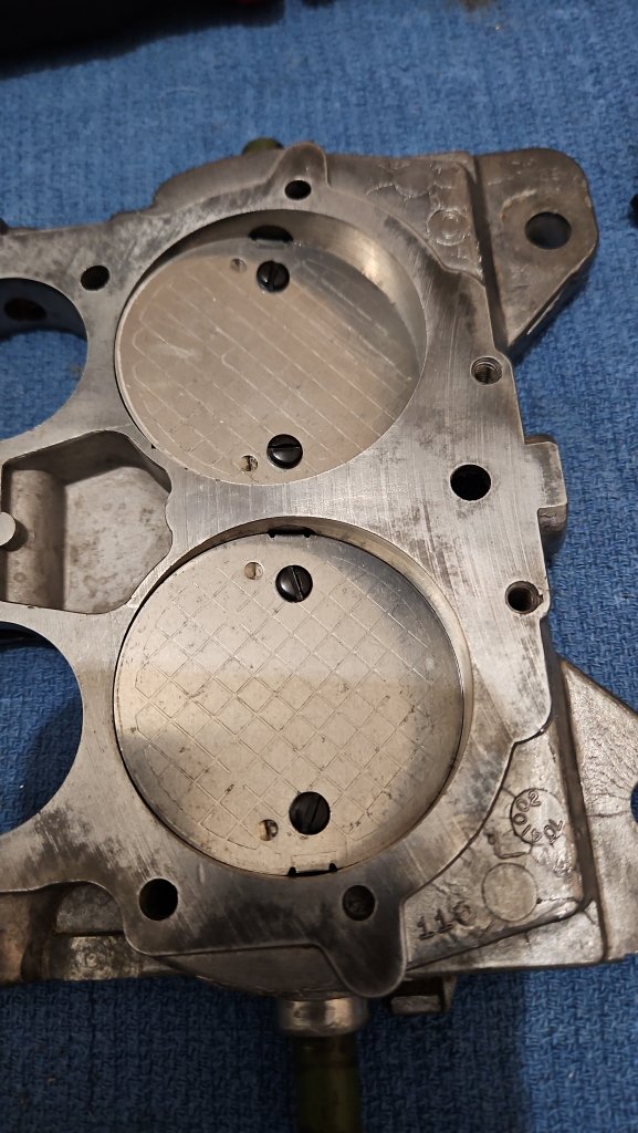

Cliff's rebuild kit came Friday, but I was a tad busy this weekend to get after it.
Cliff's kit included a spring, screws and cam for the secondary upper butterfly.
It only took about 15 minutes to get the upper butterfly out and cleaned up.
Cliff will also include a 6-32 screw upgrade for the lower secondary if you wish to drill and tap the shaft for it.
That upgrade only took about 10 minutes to accomplish. Eezee, pezee.

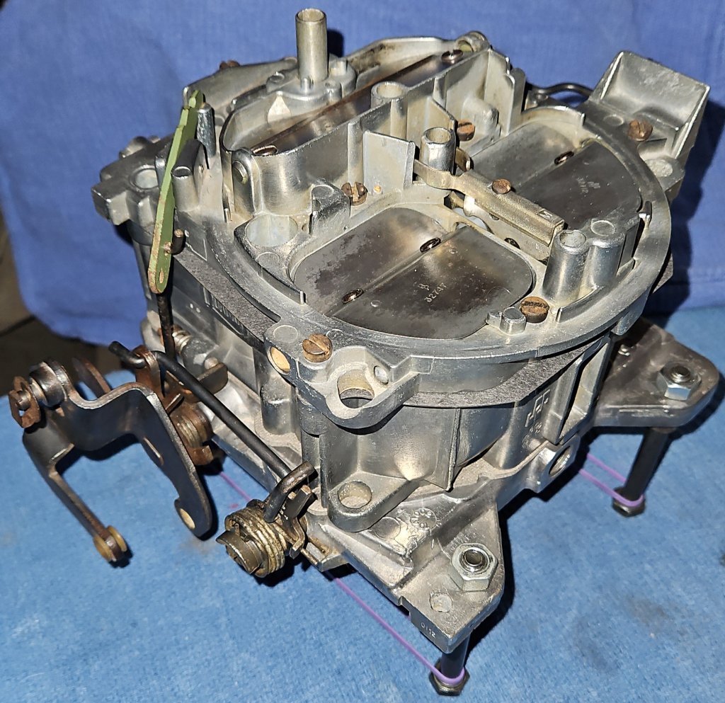

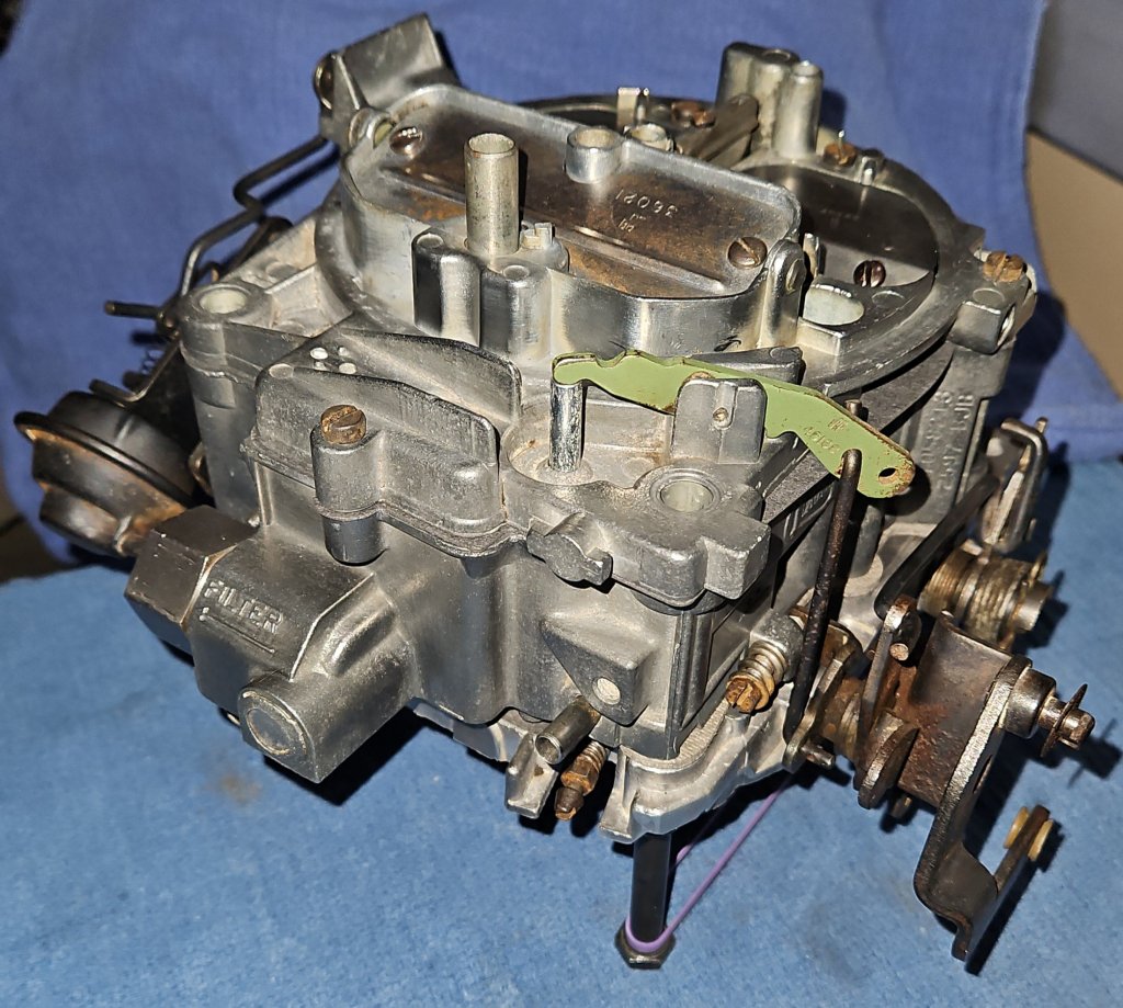

Buttoned up and ready to tune.

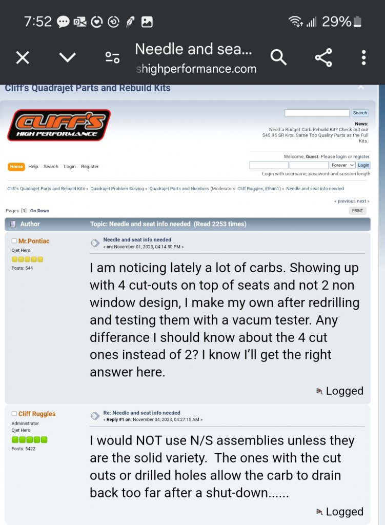

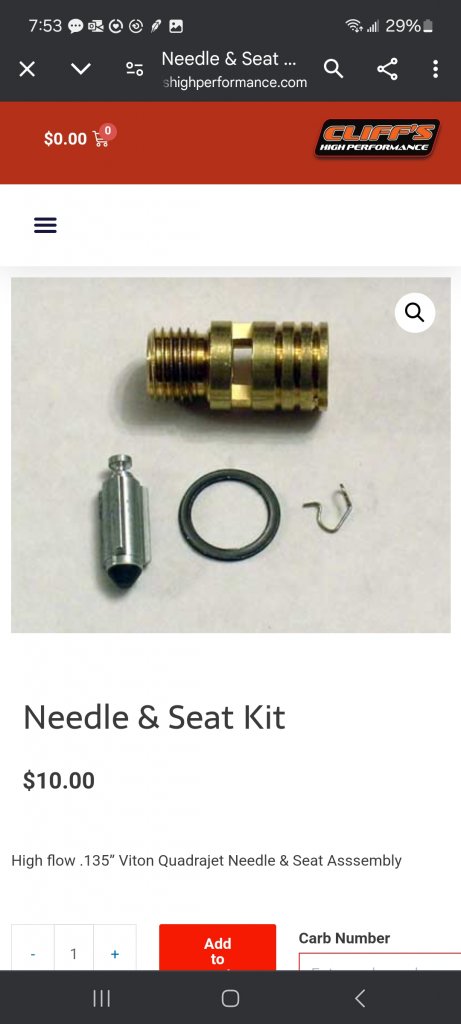

Gravity...
If there is any little bit of a leak on the check valve in the pump, it will siphon the fuel right down to the air break point in the fuel bowl. So if you have the full height solid seat, that amount is the full seat height. If you have windowed it, now that amount is all the way to the bottom of those windows. You never notice the amount in the fuel lines being siphoned down because by the time the engine has run long enough to use up all the fuel in the bowl, it has pumped the fuel lines back full and started filling the fuel bowl back up. If you find yourself having to crank the engine for an extended period before it starts after sitting for any amount of time, this is likely what is happening.
This^^^ and also if just a little fuel evaporates the float moves,the needle opens and the fuel drains all the way to the window. If you have a return style fuel pump the fuel drains through the return line unchecked,unless you have a working factory fuel filter with a check valve. According to Roe and Ruggles there is no performance advantage to a windowed needle and seat,and Rughles specifically says not to run them.As I recall you can redrill the orifice diameter of the seat for more flow. P.S. nice work on the carb rebuild
Well lookie here, I'm getting mixed signals,my vote is still no on windowed needles and seats. But look at these screen shots.
