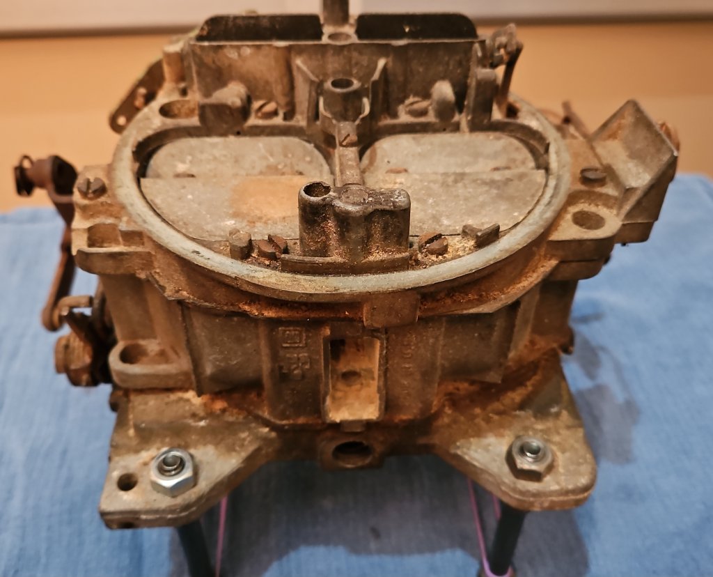

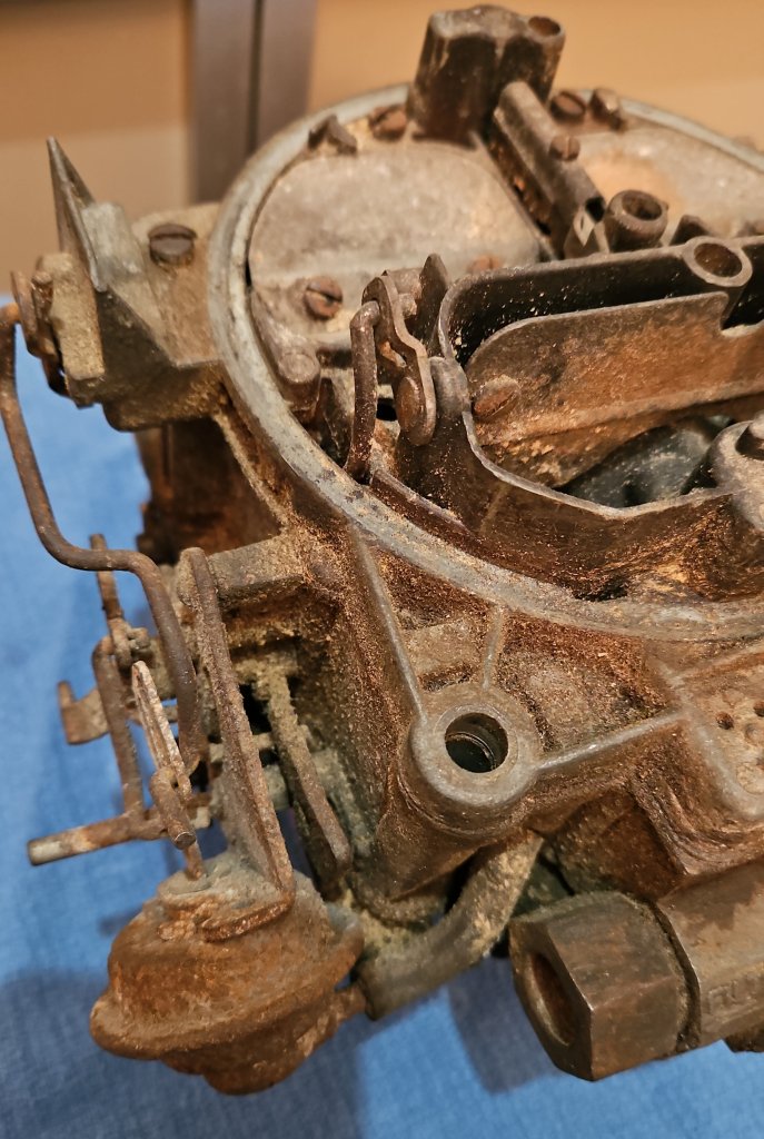

This is the newly aquired 1705 8213.
I Think I will nick name it, "Krusty".

This is probably the crustiest carb I've seen, ever.
And I've been playing with carbs since I was about 12.

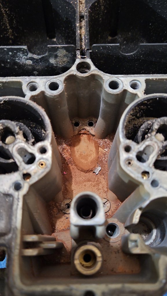

Here's a pic with the top of the carb off, looking down into the fuel bowl. There's at least 1/16" of rust dust in the bottom. No wonder it was pulled off. The guy probably blamed the carb for the crappy gas in the tank.

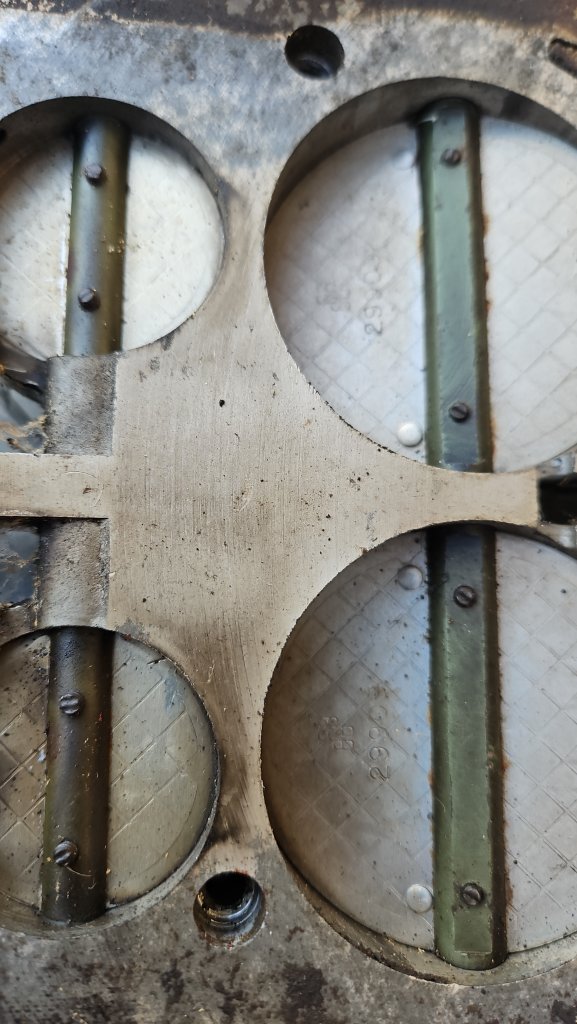

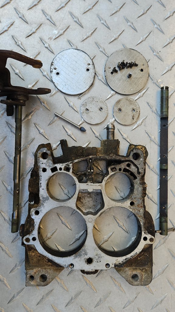

Update:
Using a Dremel type tool and a blue mounted stone, the staked part of the screws was dressed off. That done the screw easily came out which allowed the shaft to be removed.
Had the primary shaft not been loose in the bore, I would not have bothered with tearing it down this far.
And now for a little fun...
Just like on a U.S. dollar bill;
Can you find the hidden spider?
