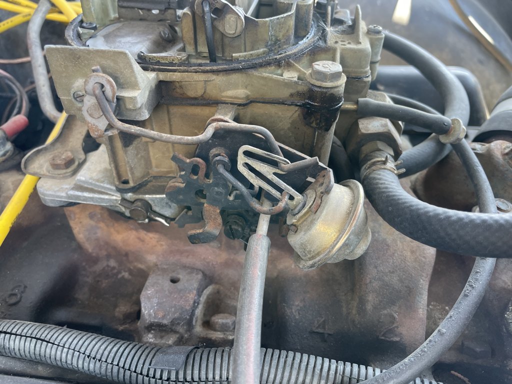

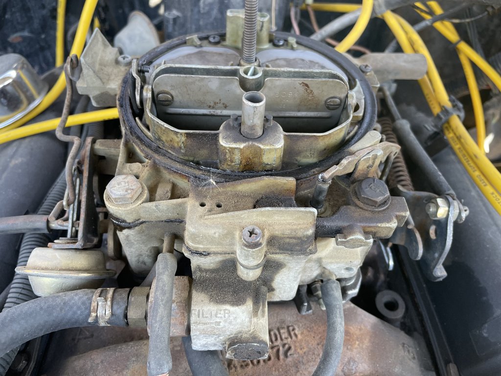

Hi all,
I am have a 1976 K10 with the sbc 350. I need to rebuild the carburetor because it appears to be leaking from the accelerator pump and other seals. What I’m confused with is the choke. It doesn’t appear to have one on it. Rather a way of actuating the choke plate. Am I missing something?
Any help would be appreciated!

Yes. Your choke is missing.
This might get you started but it will need a rod and works better with the little cover. Might have to hit up a restoration place or a junkyard.

To my knowledge they can't be converted. Several items need to be intact and working probably one of more failed and choke was removed.
working heat riser valve
Intake crossover not clogged.
choke thermostat.
choke coil cover
actuating rod
working choke pull-off
If heat riser is there, when cold starting heat should be felt on the choke pad in 20-30 seconds, if not either the plate in the heat riser is gone or intake is plugged or both. Intake can be cleaned out after removal. You can make an actuating rod out of a coat hanger. As noted previous there are several choke thermostats available. Might be somewhat trial and error. Also, the windings on the stat need to be in the correct direction.
Another option is changing to a different carb with electric choke.
