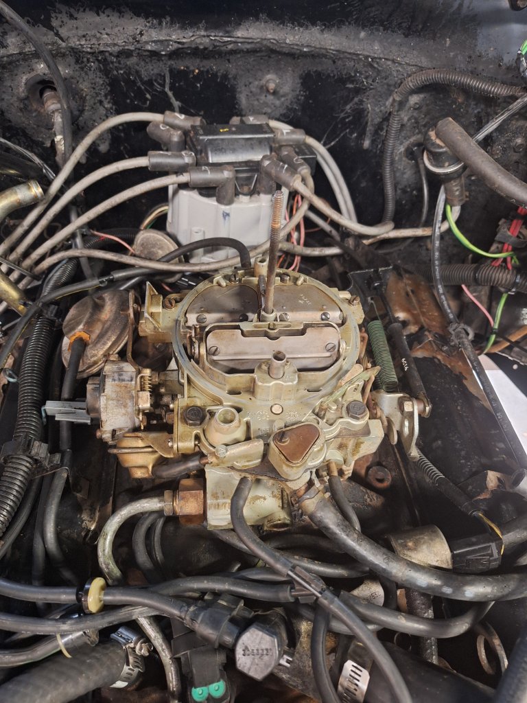

Yep, your right. Carb on it now (17056202) does feed from the left side, so it is Chevy. Another site now indicates Camaro and Corvette.
I have been searching now for what jets/rods may have been in the '83 truck from the factory. No luck yet with something absolute.
Thanks ! Current carb pic is because we all like pic's !

I think that carb is 1976 chevy truck with a 350 engine.I also think @Doppleganger has a rebuilt qjet for your truck. His may be a dual capacity accelerator pump version I dont remember,NBD easy swap either way. You can run the dual capacity as is or add the temp sensor to the water neck and add a power source.

What year is that carb with the computer plug in piece on the pass side front?
What vender is that one rebuilt from?

1985. Was a west coast (Oregon) truck so not sure if anything Cali comes into play. No idea what the plug is (someone here posted it once but I dont remember). The PO hacked all the wiring so I didnt even have a pigtail to look at.
Mountain Man Carb and FI did it. His reviews are stellar. Everyone says its bolt on and go with his stuff. Cost me $320.

The plug is for the dual capacity accelerator pump. No it's not California emissions. I wouldn't worry about the plug if I had a truck that didn't originally have one
