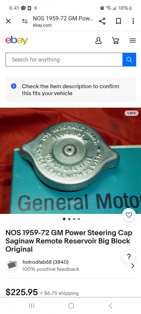

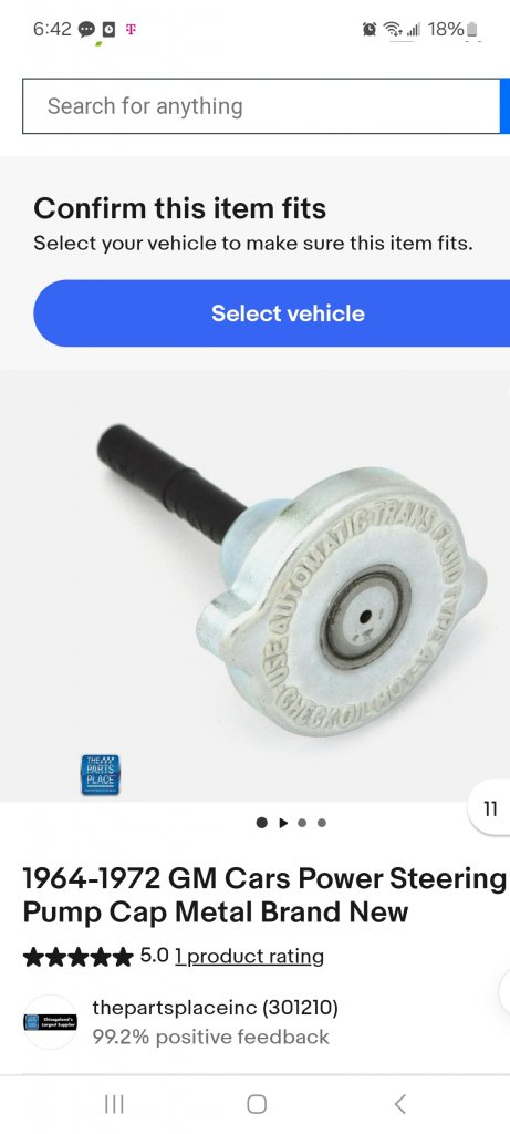

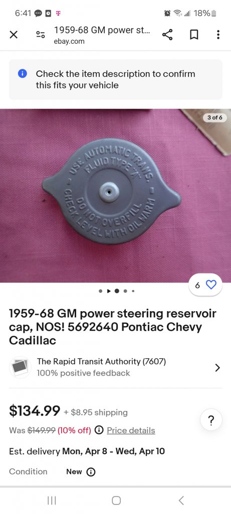

All power steering fluids are not interchangable,just because they say power steering fluid,many different varieties for different manufacturers. .Toyota,Ford and GM both recommended atf for years maybe decades,I'm not going to research it that far. But it's what GM used in the Saginaw power steering which is what our trucks have. The caps used to say use atf. I'm too lazy to go look at some of my power steering reservoirs right now,but I might later. Dexron replaced type A and continued to be recommended. As a matter of fact the label doesn't tell the whole story,I can't count how many manual transmission call for automatic transmission fluid.
