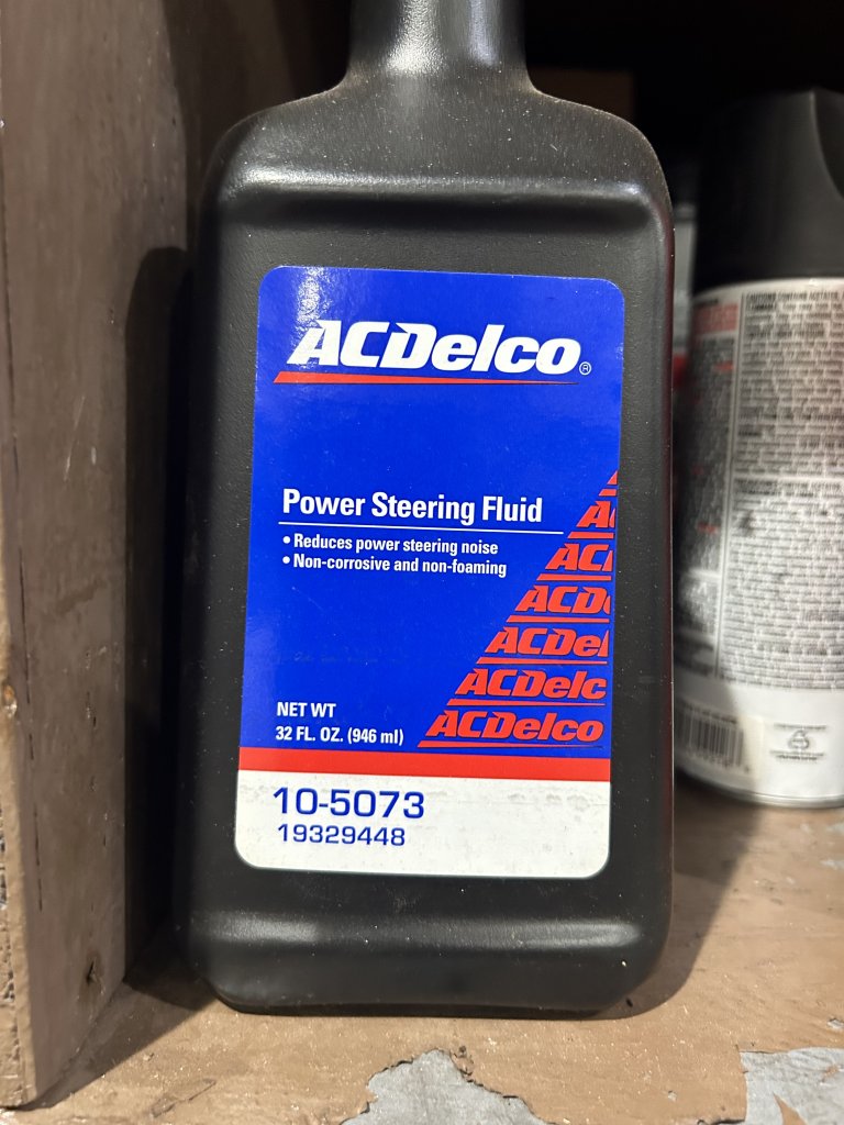

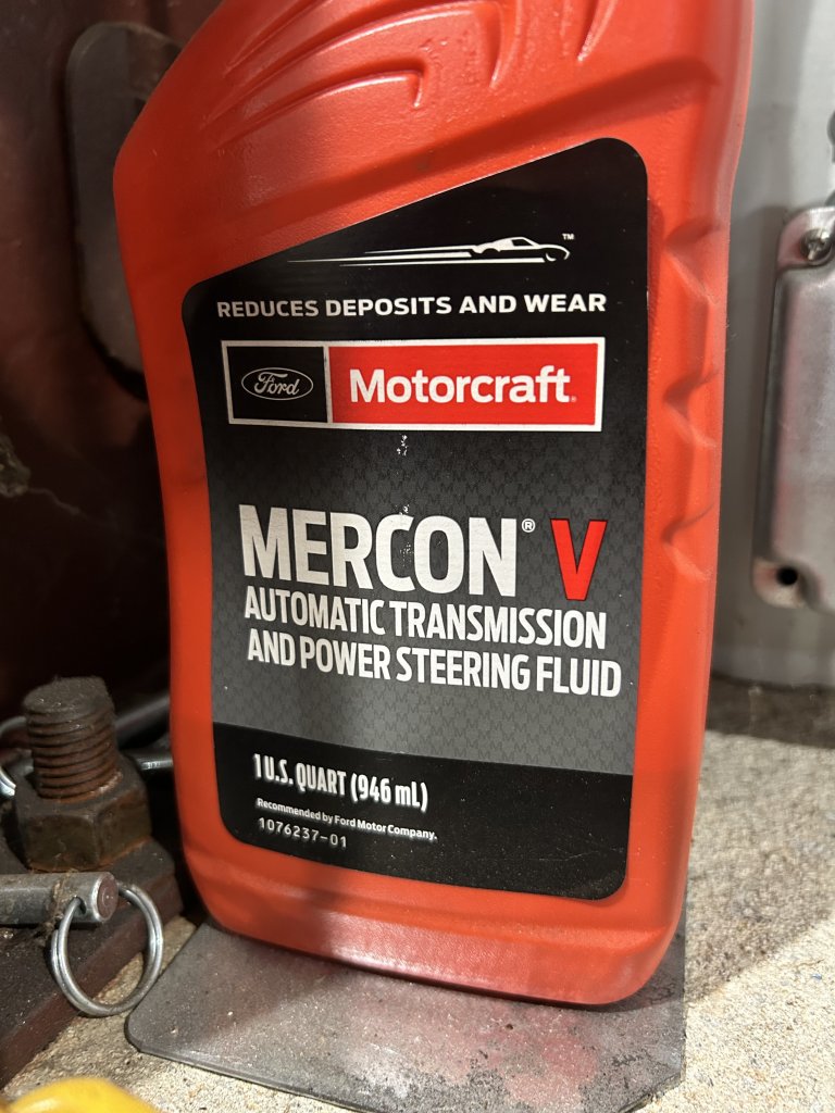

Well I like the ATF myself . I use these for the late model fords and this for the later GM.S I know there's a lot of people on this site that's why I like the input.. ups or downs great info on a lot of topics , tech info
Thanks happy easter
