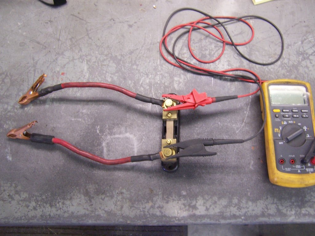

As an electrician this might help. I use a shunt with Fluke on the millivolt scale for draws. It allows anything to be turned on or off except starter. Max draw is .05 millivolt across the shunt.

I like that shunt - where did you get it? I have used an antique DC ammeter to hunt down phantom draws in British cars (it is a relic from my grandfather which he used back when houses were fed with DC current - measures up to 300 amps) - that shunt and a modern digital meter would be a lot easier and safer....

Picture is from Amazon. But the one I use has only one bar, cheaper. Don't think that really matters. Made leads for the battery. Good idea to use the neg side, won't short to ground. Below is how it's used.

Never used this before and I'm having the same problem. Where are you putting these clamps? Between suspected circuits that have a draw of on the battery leads? Sorry if this is a dumb question.

Disconnect negative battery cable. Set digital Mulitmeter to read "A". Connect one lead to the battery cable, connect other lead to the negative terminal on the battery. If you have a parasitic draw you should see something more than 0.5A on the meter with the key off. Start pulling fuses one by one and look at the multimeter after pulling each one. When the draw drops below 0.5A, you have found the circuit that has the draw in it.

Thats an option but have to be careful the load doesn't exceed the fast blow fuse. Last I knew they were about $10. After buying several I use the shunts.
Remove negative cable, one clamp on the cable other on the battery. I say negative because no grounding issues. That is unless it is an older British car. In that case positive side.
