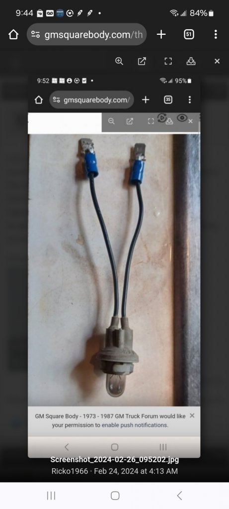

A couple of things I can add to this, in training ac/delco our instructor told us to make a fused lead for our meters with a fuse lower than the meter fuse,that way a failure was cheap and easy to repair. I usually just use a test light between negative cable and negative battery post. I think @fast 99 already mentioned that. If the lights lit disconnect the alternator,if the light is still lit pull fuses 1 at a time until the light goes out. When you pull the fuse that puts the light out replace that fuse with a 194 bulb,hook the battery back up and start taking loads off that fuses circuit until the 194 bulb goes out. I've got a pic of my 194 bulb I'll put up in a minute.
