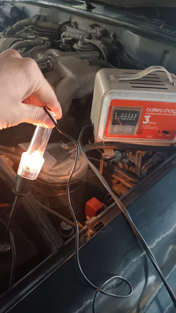

Put charger on this morning and it's done now. First test was the test light like @fast99 suggested and the light hyper flashes and I can hear a relay click in time with it somewhere under the dash. Now I'm going to try pulling fuses and stuff till i can make it stop then try to find the relay Itself and what it controls.

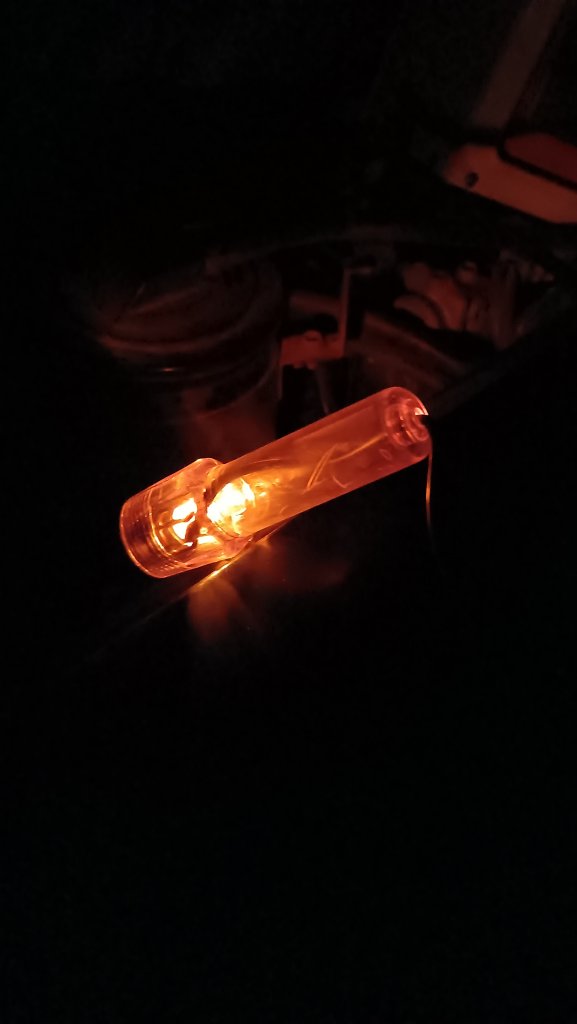

Came to dome light fuse and it stopped hyper flashing. Now it will kinda quickly burn orange and die when I touch the light to it so I'd say I'm getting close now and have it down to this one circuit.

Removed dome light fixtures and got it like this orangey glow With doors closes. That's why I'm removing and grounding switches.

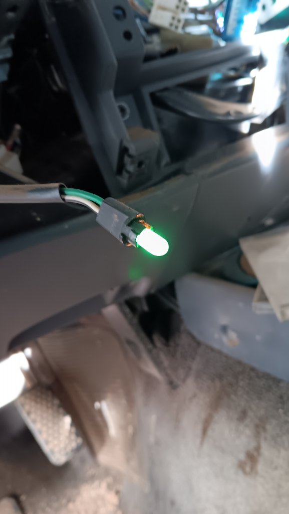

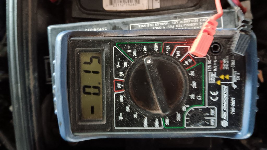

Found that there is a green light around the ignition lock cylinder that doesn't turn off and it's controlled by dome fuse. Grounded all doors and with green light out its zero on the meter. And .15 with green light in. Is this enough to kill the battery in a week? I'm sure other keep alive things are going but this light seems to be the culprit??

Weird. But if you know where the ignition is, why put a light there? A question for the bean-counters at GM. IIWM, I'd leave it out.

That might be good, unsure. What I use for draws is a shunt. With a digital voltmeter set on millivolt scale should read less than .05 across the shunt.
