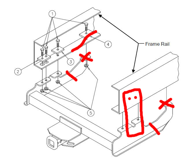

I picked up one of these for my K20. All the hardware and any diagrams was missing (which I read is typical). Got the mounting instructions online. They show 4 holes each side to hang it on the frame. The pattern of 3 of the 4 holes resembled the holes on the frame - but apparently they dont match (width). They also claim this fits Chevy trucks from 1963-2011.
Was wondering if anyone here has this hitch and if you happen to have ANY pics of how you mounted it. I am going to ASSume you drilled holes in the frame? They did mention relocating the spare - which isn't happening. Before I go all out on reinventing the wheel with the mounting plates, I'd like to know how they think its supposed to mount to the frame. THX
