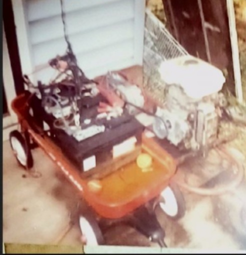

My setup was stupid simple,and cheap I thought. I was forced to live off grid for 7 months 1 year( long story). My setup was 3 group 27 deep cycles, a GM 12 SI alternator spun by a Honda 5hp Horizontal shaft.The battery bank,powered an Inverter wired into my main panel. Couldn't run the A/C,stove,water heater or dryer. Used to fire it up in the morning, to top up the batteries and again in the evening. I've put up pics before,will try to find them and put them back up. The inverter did have a low voltage alarm so I knew if I needed to top up the batteries. I always though it would have been cool to use an electric start horizontal shaft motor,so it could have been push button start from the kitchen or something,but this was made with junk I had laying around. Started with 1 group 27 and just started adding more as I thought I needed. It was cool though just walk in the house turnnon the lights,TV etc. just like normal.
