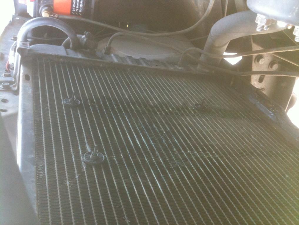

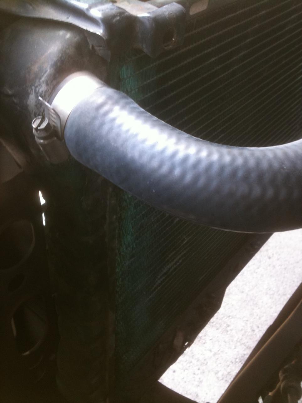

Here's a couple pics of the damage I found when I pulled the fan shroud and fan out. Drivers side tank where it meets the core is rotted and leaking all the way down. Also where the zip ties were run for the tranny cooler had 2 leaks there that were losing a good bit of fluid. Looking at the radiator from the front the cooling fins are all rotted to hell. Its like some of the commercial HVAC coils I've pulled where the fins just fall apart when you touch them.

I went through the same nonsense last summer with my truck. Alot of people forget that cooling systems work by pressurizing the coolant giving it more capacity to cool. If you have a bunch of pin holes or a bad cap the system never gets pressurized and it will run at half its capacity of cooling.

Yeah, the weather is so mild here that the only time it would overheat is going up long hills so I never noticed until recently. We've finally had weather over 85. Well, I'm not getting my radiator till friday (no hurry I'm on summer break), but since I'm going to be in there I'll spend the next couple days cleaning/painting and chasing down a couple of other small leaks. Good times! Thanks for all the help guys, I'm new to the square body trucks. Everybody drove them in high school (Oklahoma) so I always did Jeeps and Mustangs to be different. I've always loved these trucks tho
