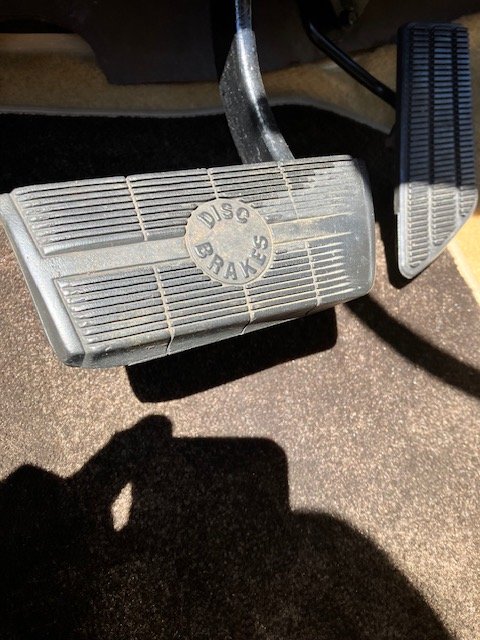

Does anyone know what the average/acceptable oil consumption might be for a 5.0L "H" series engine with 65k miles? When I started work on this original and stock truck (52.4K), a compression check showed #1 @ 175 and the remaining cylinders @ 180-190 psi. A small amount of soot accumulates in the tail pipe but there is never any visible smoke on startup or while driving, even when I open the secondaries. Early on, I replaced all sixteen valve guide seals. It currently uses about a quart between oil changes every 3-3.5k miles.The truck runs and shifts GREAT! However, there is quite a bit of wear on the right side of the brake pedal.

Looks like more brake pedal wear than expected for 50,000mi.
