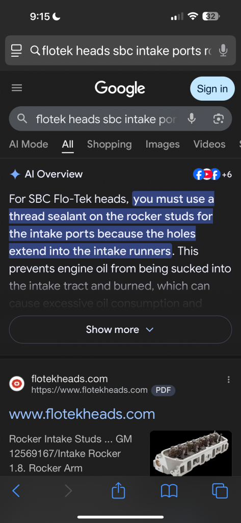

Does any bolts or studs protrude into the intake ports? Not 100% sure on a sbc if the rocker arm studs go into them ports.
I do know some of the big block aftermarket heads do need sealer for this reason.
After seeing you have flotec heads checking online. I found you have to use a thread sealer.
