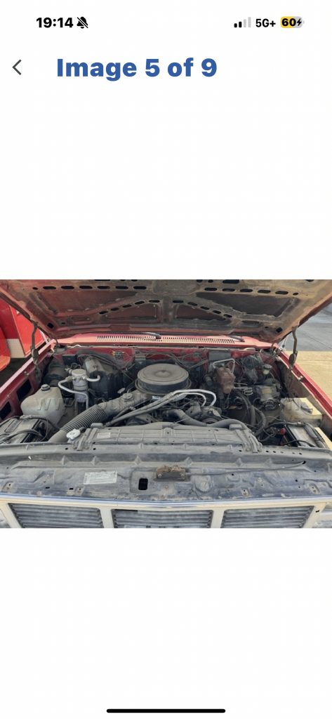

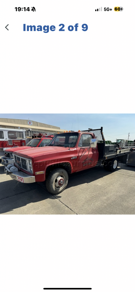

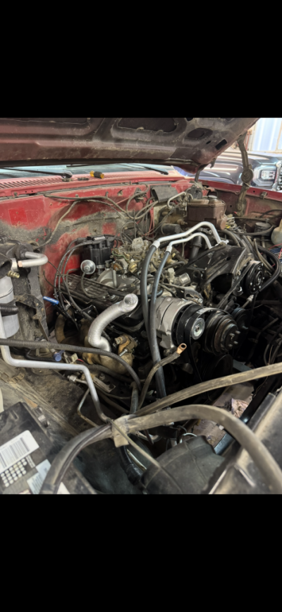

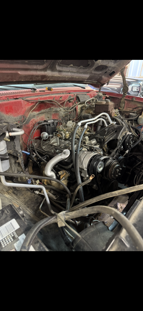

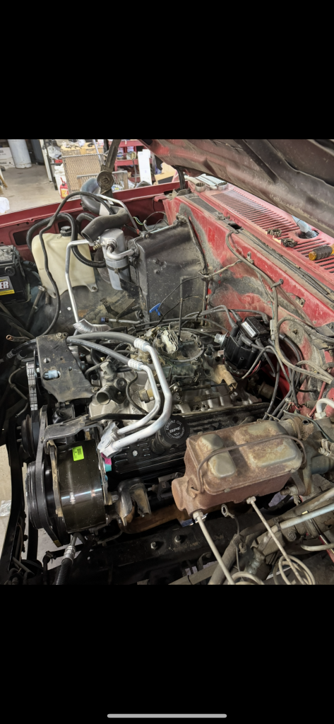

I recently purchased an 87 V3500 C&C truck on an auction last month. Had to drive from southern utah to northeast Oregon to go pick it up. Seller said motor was seized from running diesel fuel in it. When I got the time, I put a breaker bar on the balancer and I could turn the motor easily. I checked the oil and noticed it appeared to be over-filled by 100% or more on the dipstick. (Yeah not good) So i get my diesel oil drain pan and drain the oil out of the engine. Unfortunately, the first 4-5 quarts that came out first was orange dex coolant, then 4-5 quarts of very dirty oil. Pulled the oil filter and it didn’t look too bad. Refilled crankcase with some old 15w/40 i’ve had laying on a shelf for 20 years. I then pulled all the plugs and cranked the motor over, after replacing bad starter. It seems water is coming out of #5,7 and #8 cylinders. During the cranking the oil pressure showed about 50-60 psi and no major bad noises were heard. I’m hoping this is just blown head gaskets from a hydro-lock situation. Will be pulling the heads to investigate.
If the block isn’t salvageable, i’m looking at a Smeding 383 short block and then I’ll build it with some new vortec heads to give the old girl a new lease on life. Truck is a 49 state heavy emissions 350 and I believe was the last year a 350 could get a Q-Jet.
Updates to follow.

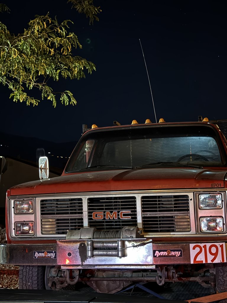

Please tell me about that winch. Looks like a Ramsey...
And yes, 1987 was the first year for TBI but I am not sure about the 3500 trucks. I didn't know a carburetor was still an option for '87 but I am happy to learn something new.
Yes Ramsey 12,000 lb electric winch. Still works fine. I believe 87 was last year for heavy emissions 350 >8600 gvw to get a q-jet. I believe the 7.4 carried on with the carb for possibly two more years with 49 state emissions and >8600 gvw. I could be wrong on that.

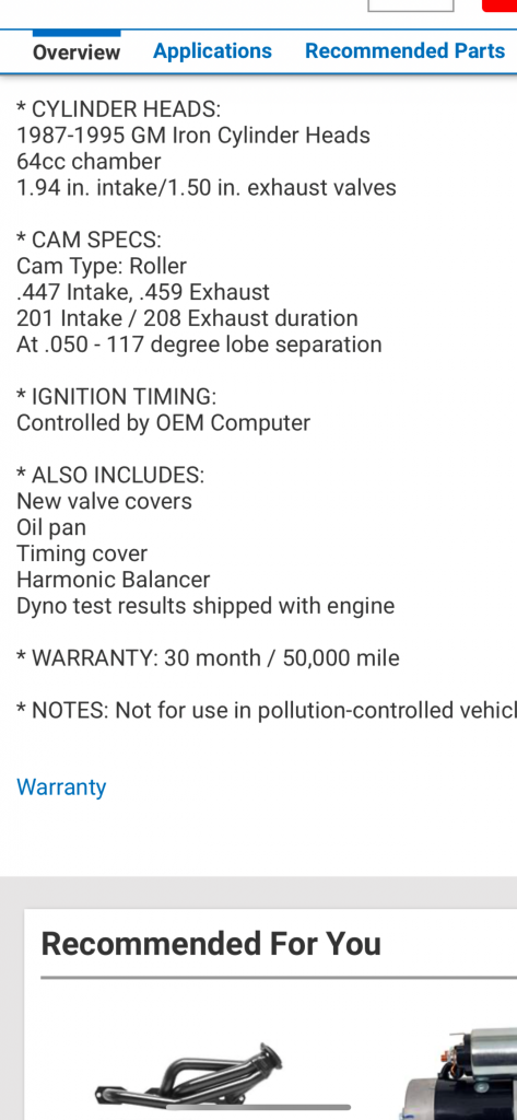

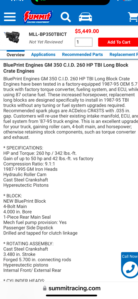

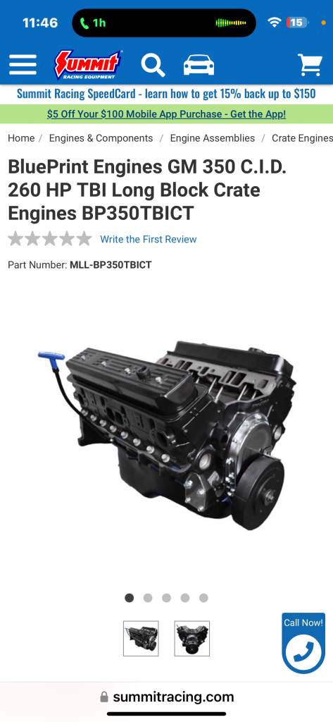

Motor that’s in the truck ended up having 6 quarts of coolant in the oil pan. I believe the block is windowed and or cracked. PO was a fire dept, they said some new recruits filled the truck up with diesel and ran it till it hydro-locked.

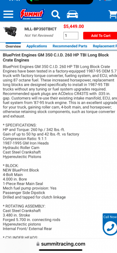

I’ve got a blueprint 350 TBI longblock coming for it. Basically an upgraded OE style replacement with a hyd.roller cam, new block and tbi heads.(Not a fan of flat tappet cam/lifters and the dreaded break-in) New longblock is Supposed to be 260hp and 342 lb ft torque. Stock LT9 350 4 barrel had 160 hp! I was going to get a 383 stroker long block but decided on keeping it a 350. It’s not a hot rod, just going to be my mountain wood truck.

I had entertained a 383 longblock, the Atk HP90 in particular, but decided to stick to blueprint 350 as the truck has 4.56 gears and really won’t be towing much, mostly will be my mountain wood truck. Also wanted to reuse stock exhaust tubular manifolds and factory dual exhaust, figured a 383 would need headers and new exhaust to breath more optimally. I do like the idea of a new block and heads, and not an unknown reman parts. This is first time i’ve ever ordered an engine, i’ve always built them before but times have changed and machine shops are not the value proposition they used to be in the 70’s, 80’s and 90’s.
I’m putting a tbi head compatible weiand spreadbore low-rise dual plane intake and stock Q-Jet on it. Didn’t want to drill out the center 4 holes on stock iron carb intake and have any cracking and or sealing issues. This block is machined for a mechanical fuel pump and the roller camshaft has the fuel pump eccentric. I intend to use my own mech. fuel pump for simplicity.

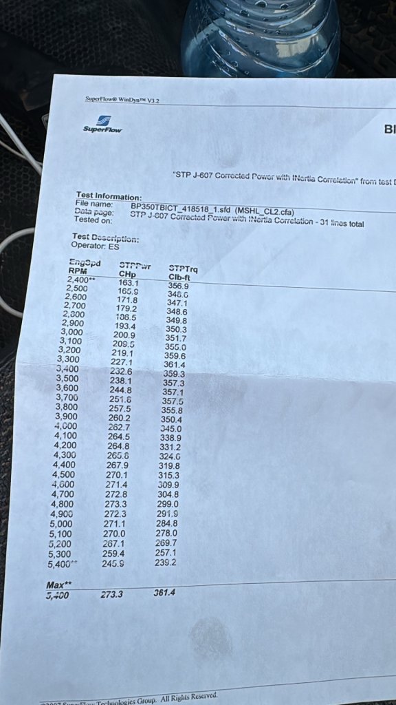

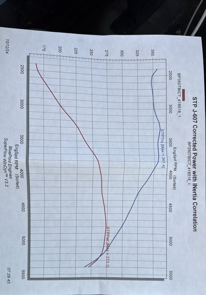

The engine showed up today at the freight terminal. Dyno sheet included. Interesting that the dyno sheet exceeded both the torque and hp for what was advertised for this engine.

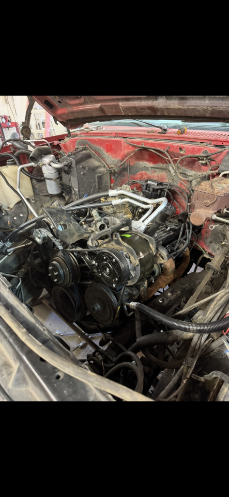

Sorry for lack of follow up lately. Lots of work getting done in the last few months. Have the BP 350 installed in the truck. Front seal replace on the SM-465, orig front seal lip was as hard as a rock. Last owner ran it that way and had 90w on the clutch and flywheel surface. Had to tidy up a lot of old fire radios and associated wiring, that was a fire hazard due to terrible install with no grommets and wires chafing at several points through the floor, and firewall. Must have removed 50 lbs of wiring and antiquated fire radios from the 80’s-90’s!
The dumbest small thing I ran into, as far as parts are concerned, was the driver side exhaust manifold studs. Apparently these things are as rare as hens teeth and the aftermarket ones were all wrong. I ended up finding a GM parts illustration and found the GM part number and tracked some NOS exhaust studs on ebay and we’re back in business! The studs on the driver side are unique in that they are extra long and also hold the EFE valve in place. This truck has the stainless tubular exhaust manifolds (85-87) and federal non cat dual exhaust system.
Picked up a new copper/brass 4 core radiator from summit, new AC parts, and much more. Goal is to fire her up possibly by the end of the month.
Put some HD rear greasable shackle hangars for the front leaf springs, from ORD in Co. These hangars raised the front end about 1/2 to 3/4”. The rear oem bushings were completely shot and the leaf spring end was touching the frame rail.

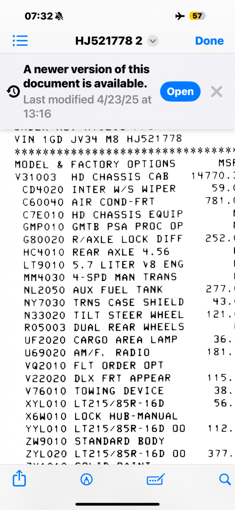

Next will be interior, new dash, instrument bezel and a lot of elbow grease cleaning. I did order the GM heritage site invoice sheet for the truck. Very interesting.

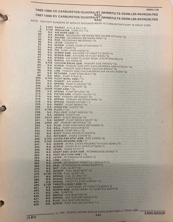

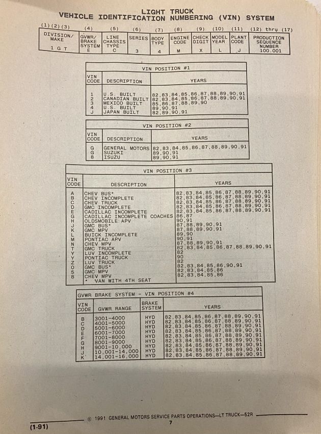

ButchM
Oct 19, 2023
63
97
Idaho
Butch
Jeff

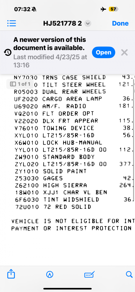

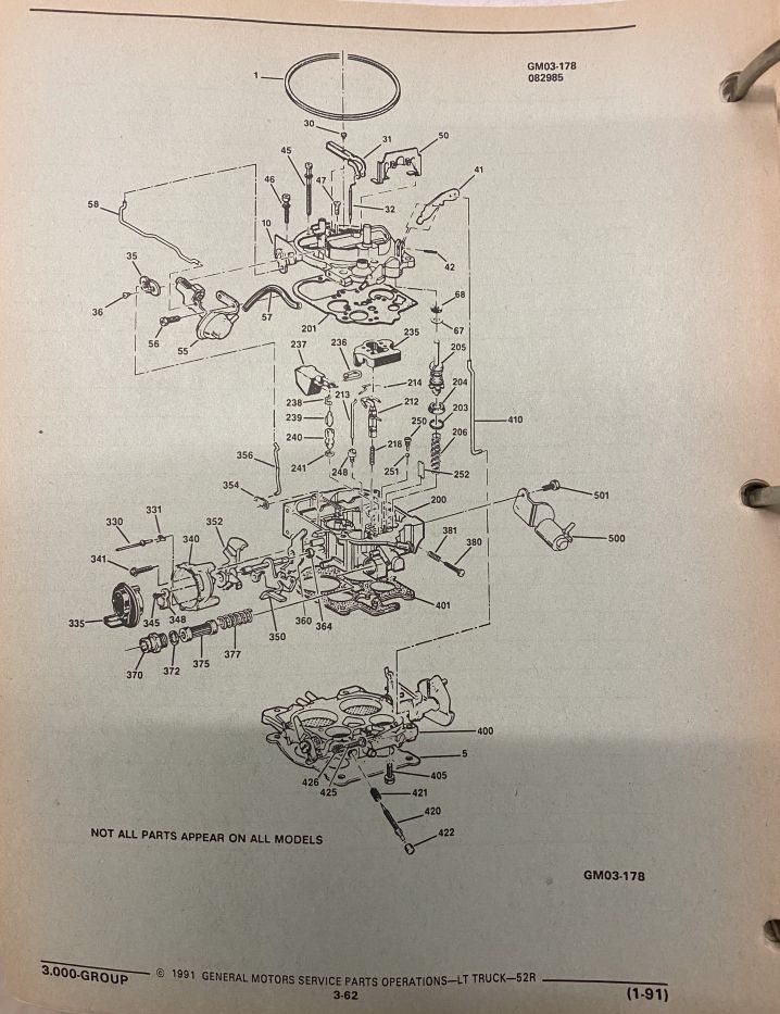

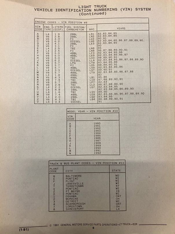

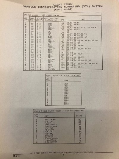

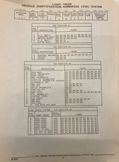

The LT9 350 and 454W were carbureted thru at least 1988. What all they were available in is debatable. If you have the SPID label showing an LT9 it was carb'd in 87.
Some of the pics below support this. If you have any further parts manual illustration/part number questions please reach out. Glad to hear the truck is coming along good.
