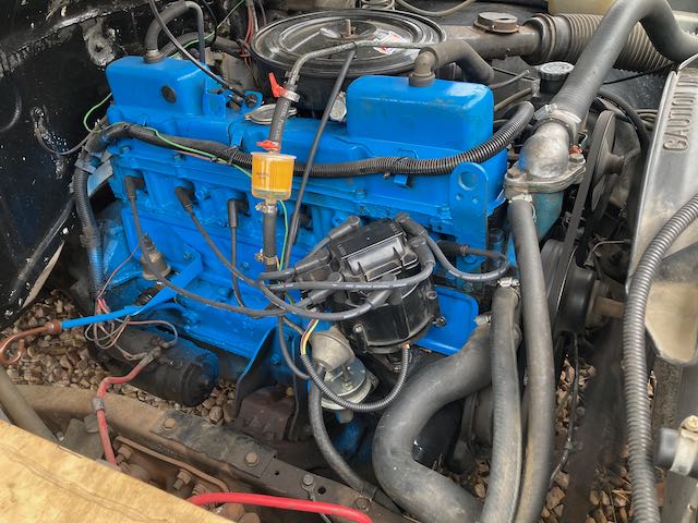

Purchased this truck about 10 years ago for $400, ran poorly but got it home 20 miles. We call it the "Beast".
Came from a farm in eastern Montana originally, via several owners. Has the long bed and 4 speed transmission. It has been on the back burner due to other projects until recently. Now I have time to work on it. Over the years I have replaced the tires, shocks, alternator, water pump, and rebuilt the Rochester carb. I knew that cylinder one had very low compression, so I decided in August to pull the head and inspect it.
As purchased, tired, dirty and ugly.
As I assumed, the exhaust valve was burned in several places. After a $400 valve and head job at the local machine shop, I spent 2 days reassembling the engine. I had to find a used exhaust manifold from Minnesota since mine was cracked in several places.
Stock exhaust manifold was pretty hard to find, no substitute for the 2 barrel dual exhaust model. Mine was horrible.
Beautiful integrated manifold head after repair work.
After deleting many unnecessary items and "simplifying" the engine, I gave it a whirl and it started right up and boy does it like to go now!
Cleaner and loves to run!
Even the granddaughters (9 and 11) like to ride with me. Future projects include adding 2nd battery, better horns, seat redo, maybe carpet, a radio, brake job. Probably going to keep the body damage and rust, it adds to the character!
