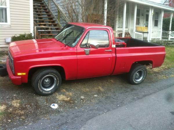

Hi, I just bought a 84 SB C-10. It has been changed up over the years with a different motor (350??) it also has a top loader 4 speed in it that I'm not sure if its stock for a two wheel drive truck? Dual tanks and a gauge that doesn't work. So please bear with all my questions. Also there are no badges on the out side of the truck but it does have a Silverado badge on the dash? I will try to add a pic. Is the daul tank common??Thanks Scott

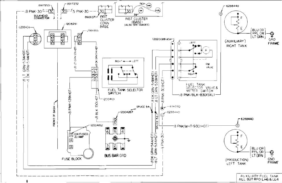

I (along with many others) can help you with that dual tank setup. I just went through mine in May to get it back up and running.
A present for you to enjoy...
