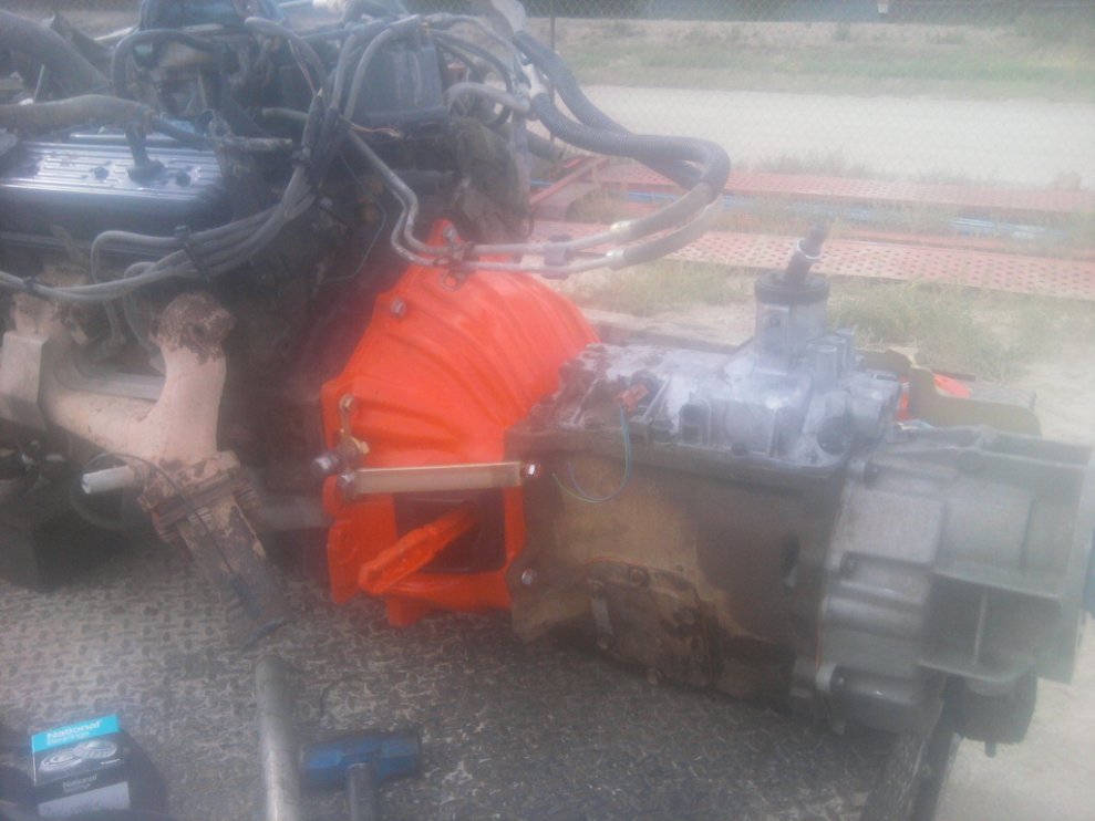

got it all bolted together today

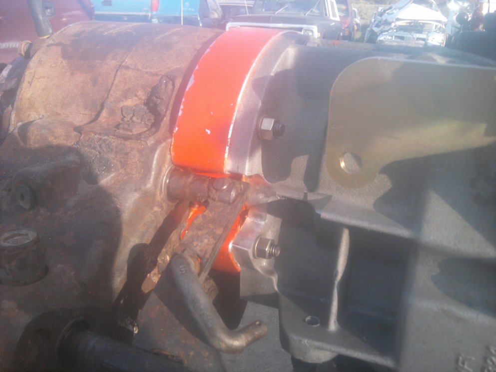

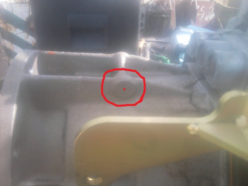

the advance adapters t case shifter bracket is flimsy
I am going to drill and tap a spot on the nv4500 tail housing and fit a tube across to the bracket so I can bolt the back part of the bracket to the tail housing(I circled the spot I am going to drill and tap in red in the picture below)
I need to make a new rod from the shifter to the shift rails still and probably going to find a different shifter handle

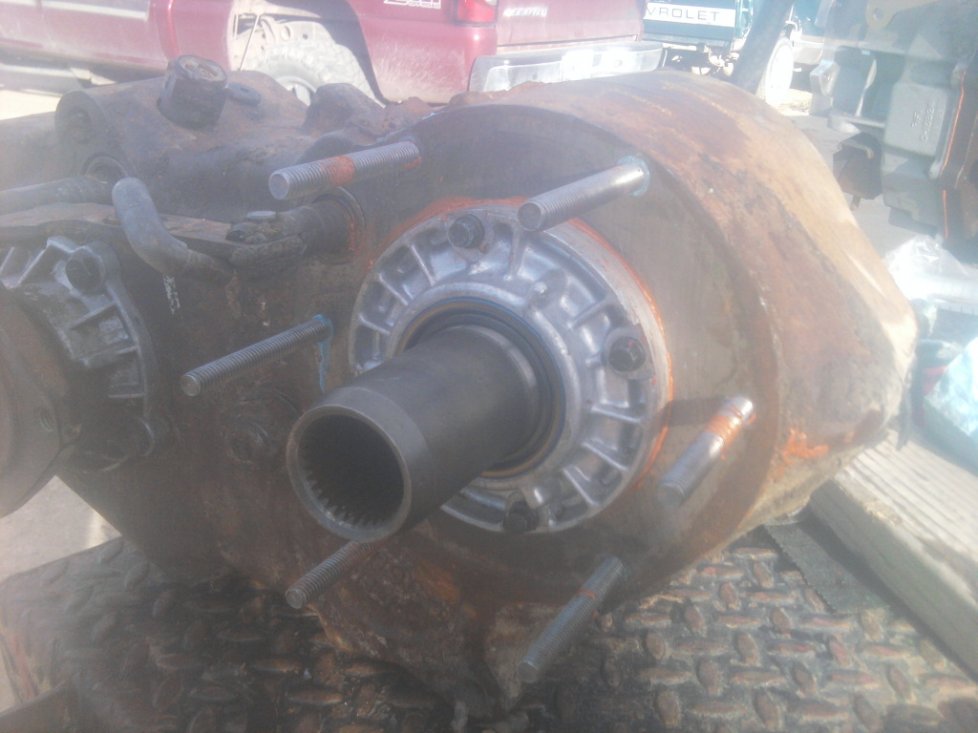

even with the spacer for the long input 205 I still had to notch the tail housing on the nv4500 for clearance for the 205 shift rail.
I took the tail housing off and took it to the machine shop he whittled it out pretty quick.
I went ahead and notched it out so if I ever need to I can run a short input 205 without the spacer.

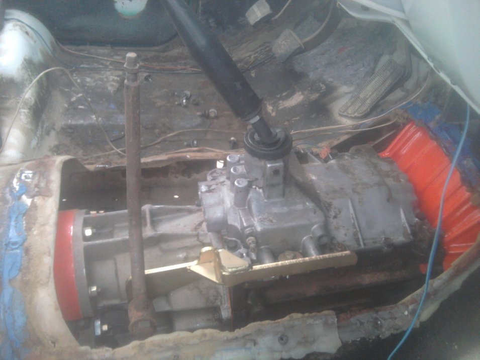

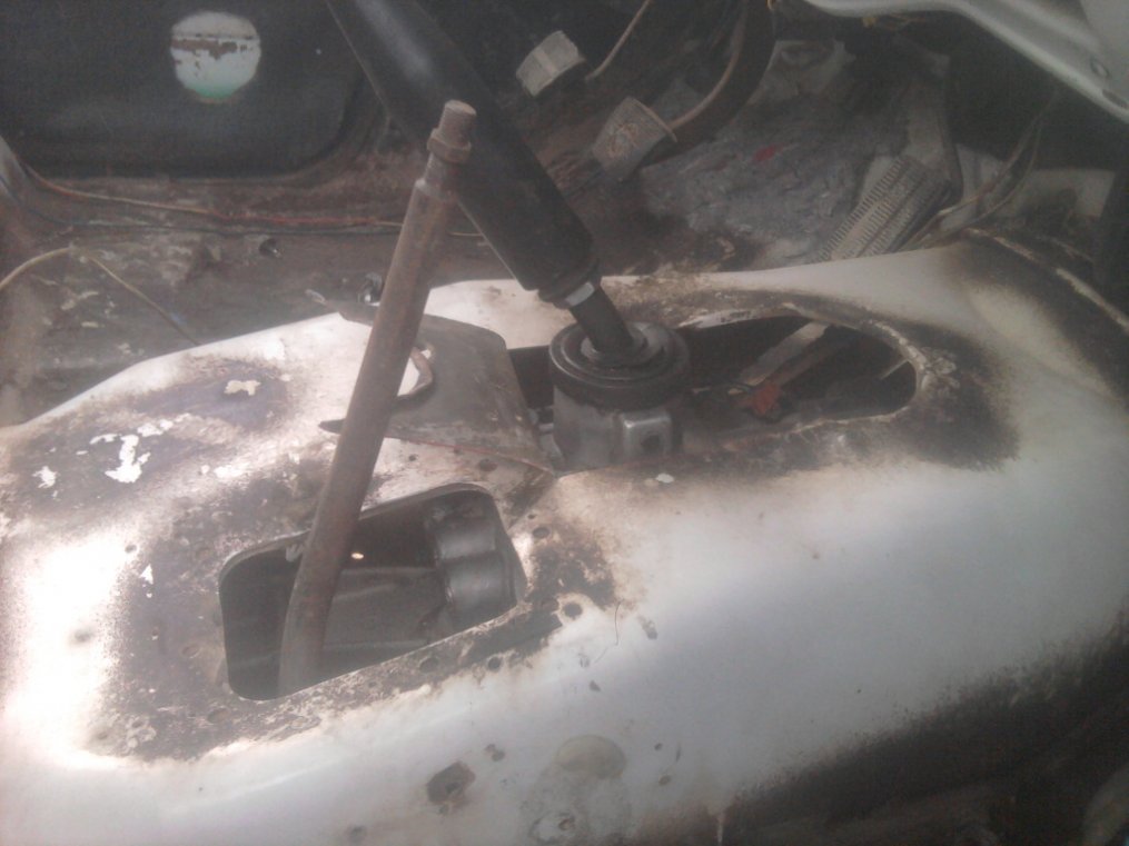

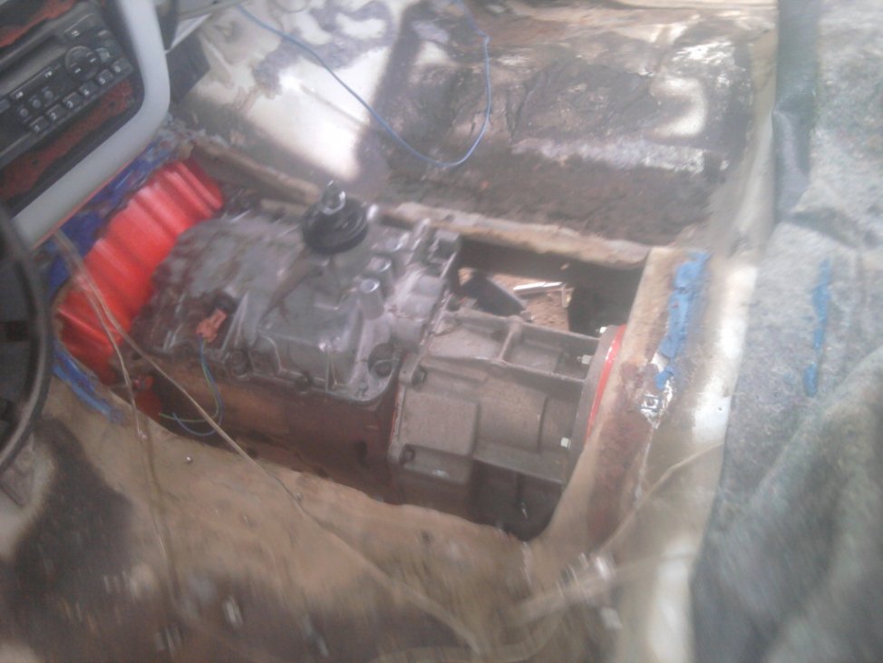

its in the truck now
I still need to hook everything up and rework the holes for the shifters
and I do not like the cross member hanging down so low. I used a cross member from a suburban. the 1 ton frame is 2'' taller under the cab so it hangs down more on the 1 ton. I had to space the transmission up.

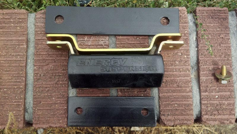

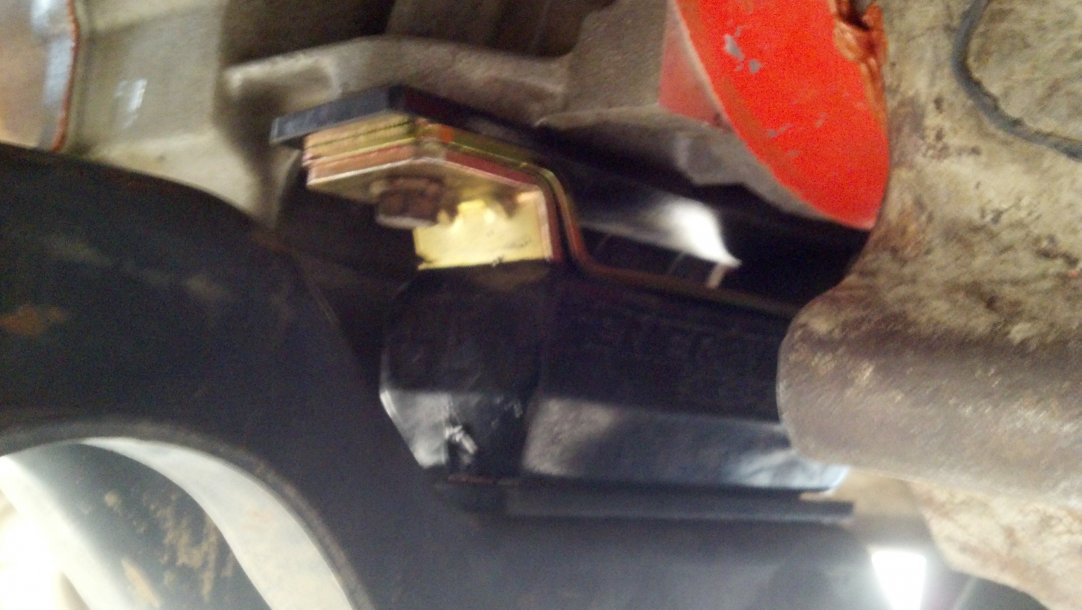

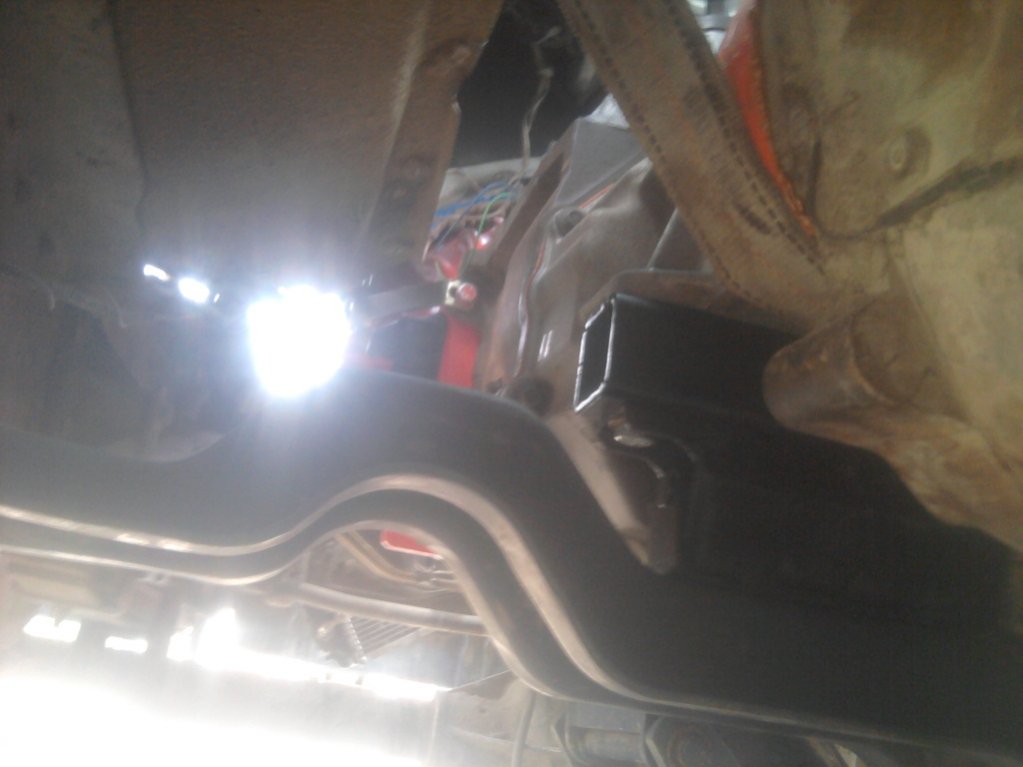

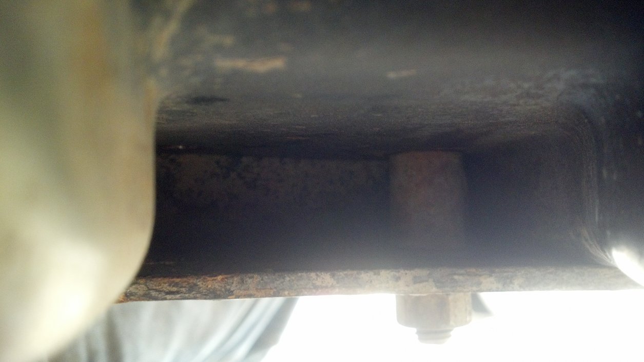

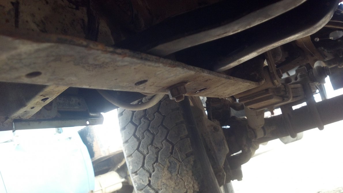

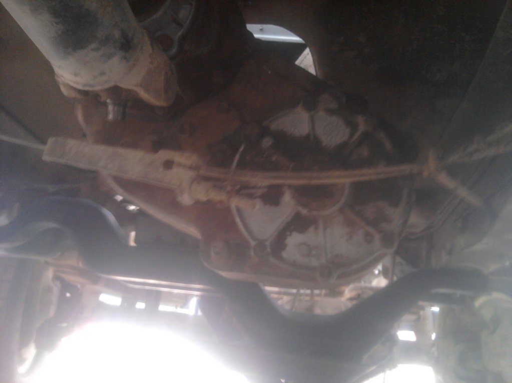

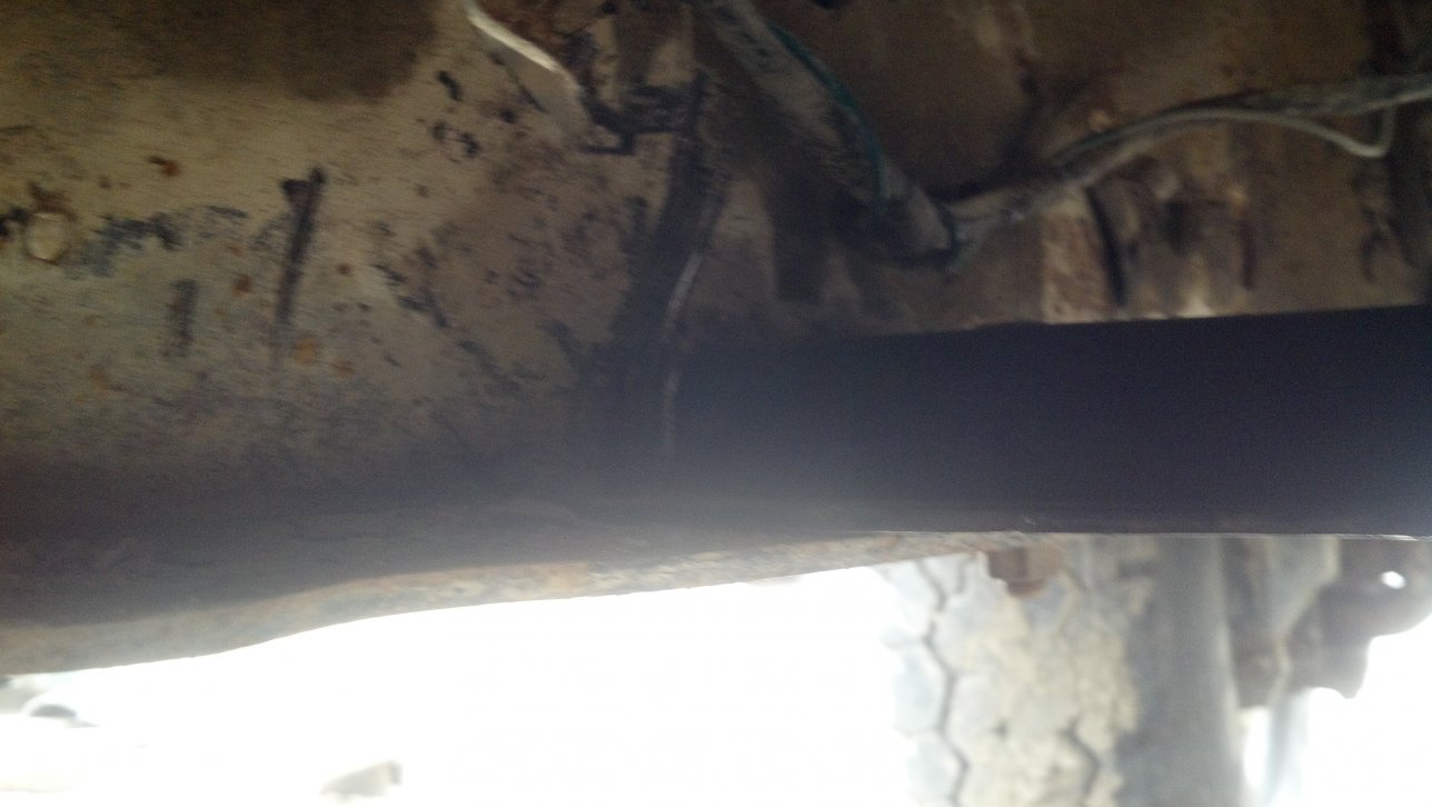

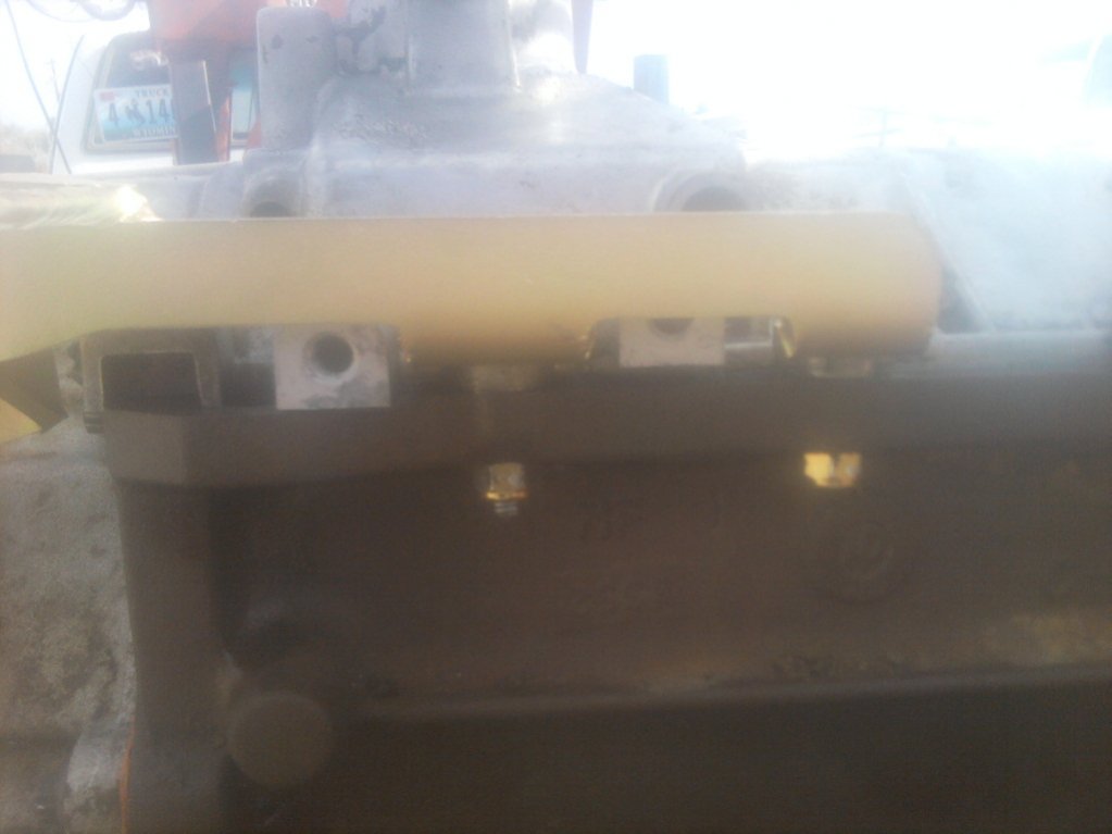

after going over a few ideas in another thread about the nv4500 cross member in a 1 ton.

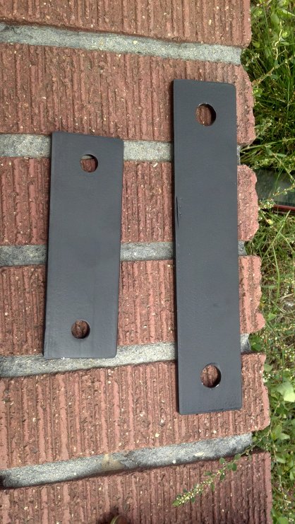

I came up with moving the cross member inside the frame. then using the spacer that was on the bolt and 1 flat washer to fill in the space between the cross member and the frame. it worked pretty good raised the transmission 1.5''
then I built two 1/4'' spacers one between the nv4500 and the mount then one between the mount and the cross member witch raised the tranny another 1/2'' 2'' total
this is only necessary on a 1 ton frame as they are 2'' taller under the cab
I only have 1 bolt on each side right now because only 1 hole lined up I need to drill the other hole on each side

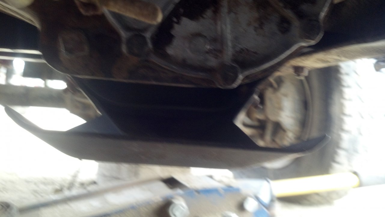

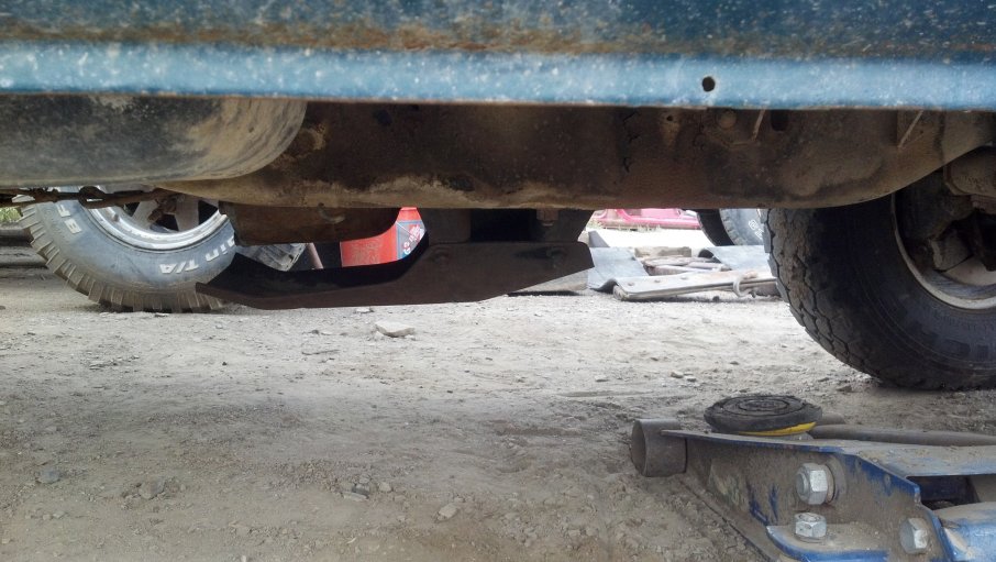

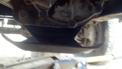

more pics
probably going to take the skid plate off
