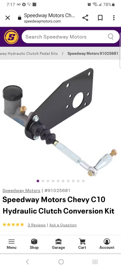

Look at kits to go hydraulic on old gm a f and x body's for a reference. You will have to engineer you're own master bracket,but retain O.E. pedals. Did a quick search for you here is a 68-72 C example.
