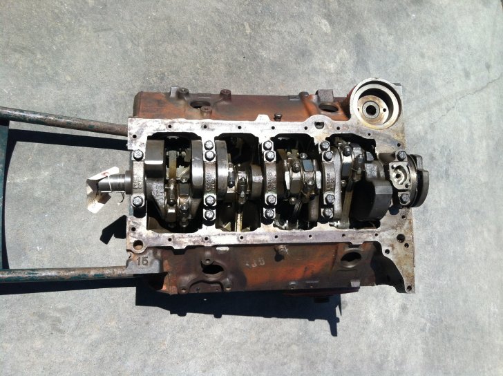

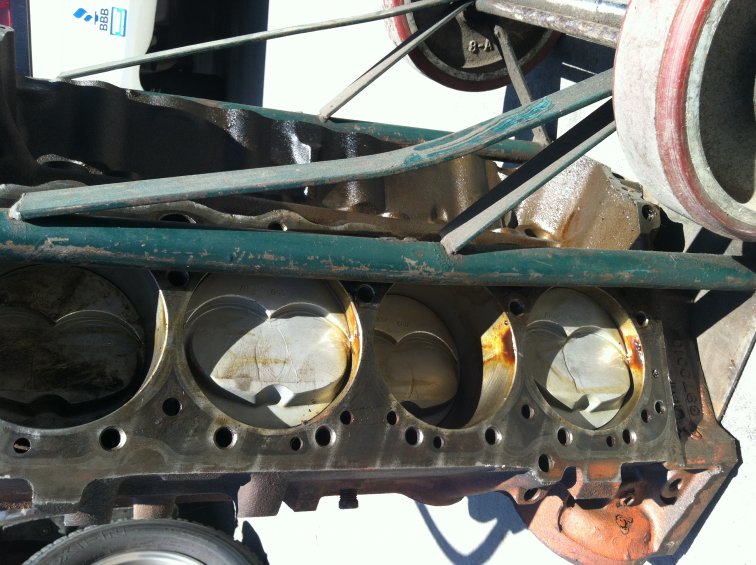

I know it's not a truck motor, but it is an old school type build.
Who knows what a 309 is??? I'll hint at the crank number.... 1178

Most odd numbered Chev builds are from the racing industry. This motor was designed when the 327 came out, they had a 310 cube limit on most dirt tracks. Some guys were lucky enough to run across the 302 motors. so, if you put:
#3970010 4bm block at 4.045 bore
#L1101 .085 Pop up pistons (060 over 327)
# 5.7 Powder Rods
#1178 crank (3.00 stroke)
#291 Heads
# 11.1:1 Compression
you get 309 Cu In and over 325 HP at less than 7000 rpm....
Why not use a 283 crank??? Journal size. 1178 crank is a large main crank.
At 6500 rpm the thing sounds like a formula car..... I'm excited. Can't wait to spin it..... teehee:party36:

Sounds like a bored 302. That is a DZ302 '69 Z/28 forged crank, IIRC.
Are you going .045 over, or .060? I can't do the math in my head right now. Your block specs show .045 over, but the piston specs say .060. Just curious is all.
Large journal bearings spin faster than small journal bearings, just sayin.
Do want videos of when it is running! Should be a fun motor. What are the cam specs?

Forgot ask, what is this going in? Dirt track car?

That is info I was not aware of. Very cool. Sounds like an engine that could bring big smiles.

The gm dz was never meant to make torque. They just needed it to rap to the moon. And cause there was a cube limit.
