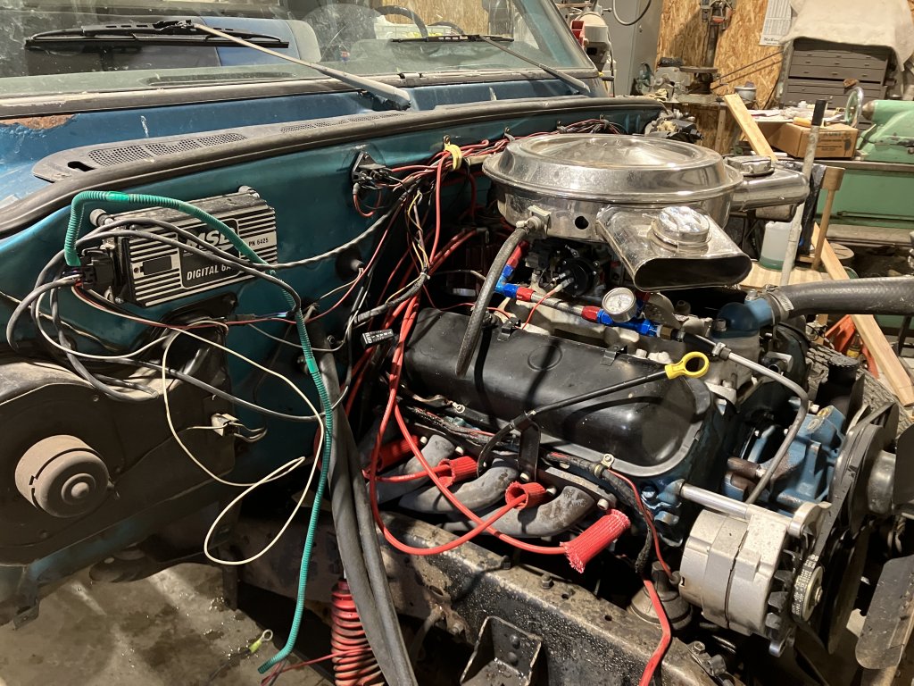

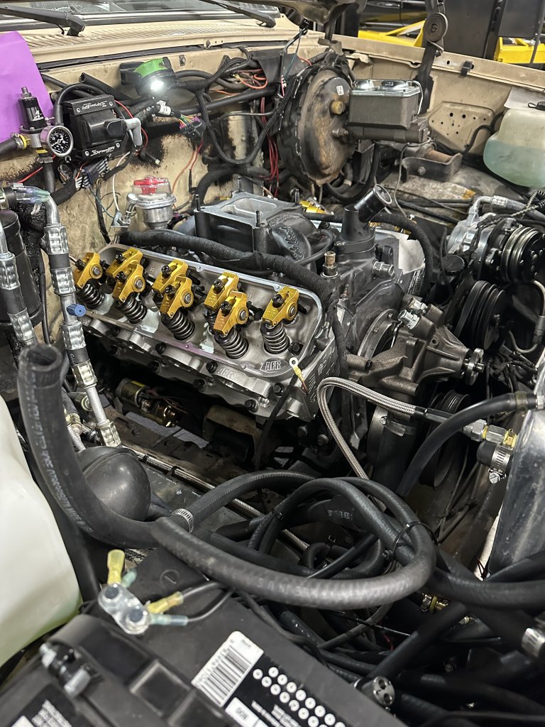

My build is almost completely stock. I took the stock L29 and had it cleaned and inspected. It had 288,000 miles on it when removed from the 97 K2500 Suburban donor. I was able to get the bores completely cleaned up with only a .020" over bore and then used stock replacement sealed power pistons. Final deck height was ~ .003-.005" and I used a factory replacement felpro gasket kit with factory style head gaskets. I think final quench was in the .055" range, which is perfect. Heads were just cleaned up and refreshed. Heads were just surfaced and only took ~.003" off to get flat. I polished the rough flashing off the combustion chambers and polished the exhaust ports. Rough port matched the intake ports to the intake. Only real improvements have been to the cam, valvetrain, EFI system and ignition. I blocked off the factory regulator and installed a remote adjustable one. Converted the injectors to Bosch Gen III 30lb/hr injectors and converted the ignition and ECU to P01 Gen III LS. The moroso coil mount brackets let me use the Gen IV coils from my 2011 LC9 Suburban engine.
Just last night I finished removing some of the unneeded wiring on the factory harness and got the new 3-wire AC pressure gauge ran. Ran the coil wiring across the harness and pinned in the oil pressure sensor so I can read that through the OBD2 scanner instead of just looking at my dash gauge. Still need to finish ringing out the wiring harness and then bundle it all up and secure it to the right spots. Hopefully some time tomorrow I can do a trial fire up of the engine on a makeshift stand before I start swapping everything over.

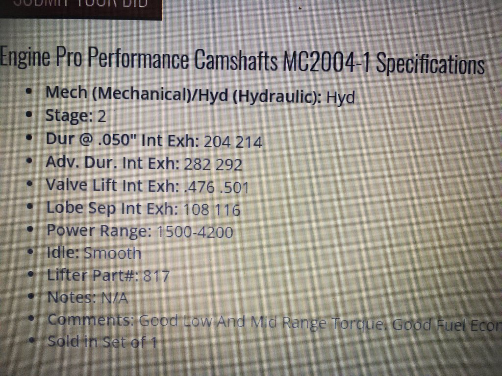

After digging and digging for info i did come across a (article) hand ported vortec headed 489ci engine that made 420hp/555TQ with a 204/214 crane cam.
Should i copy that combo ?

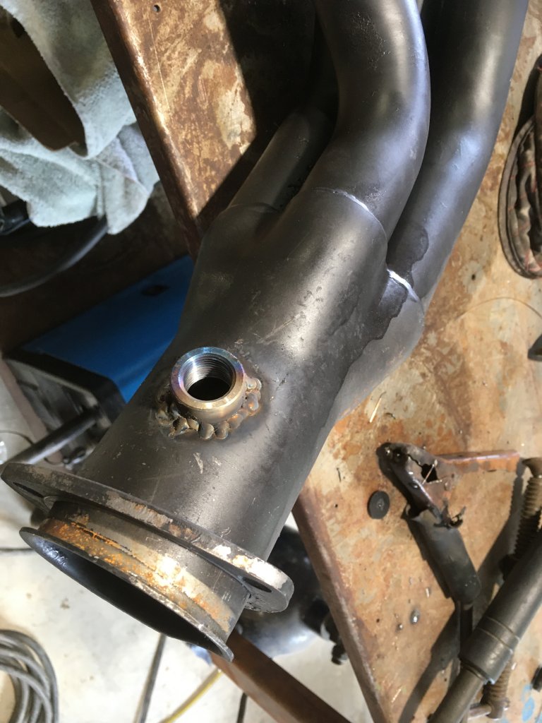

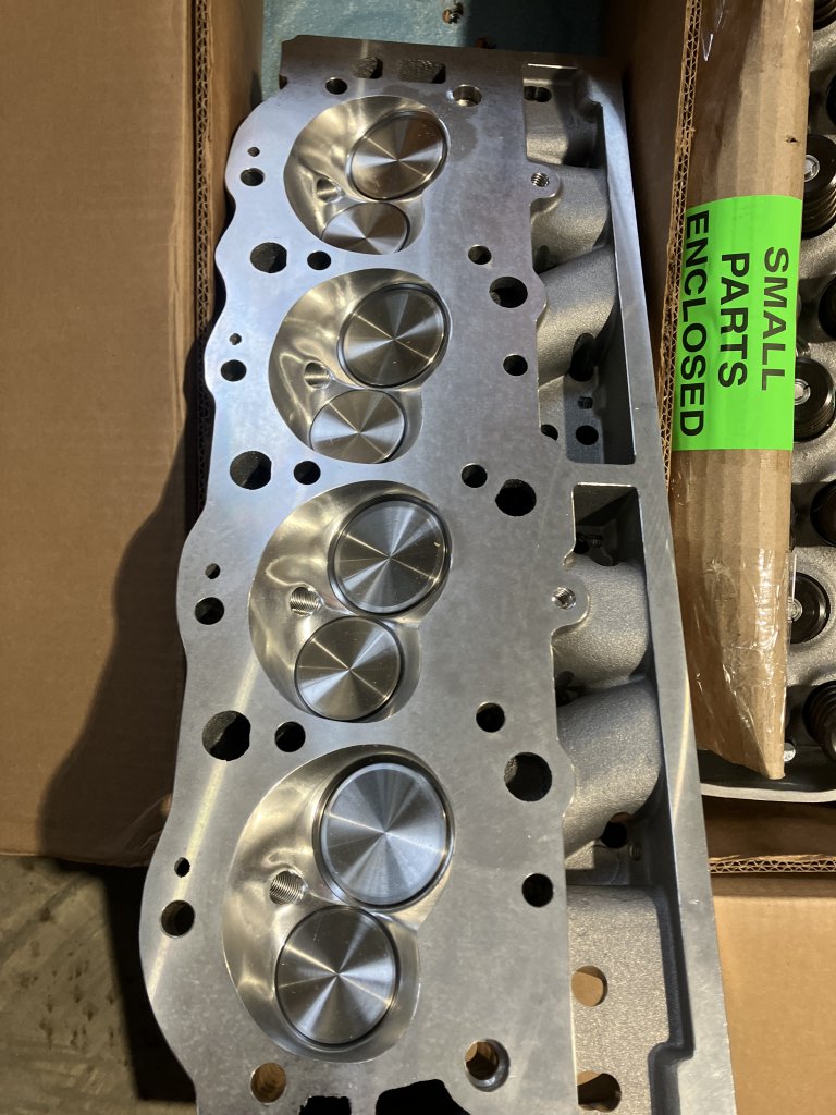

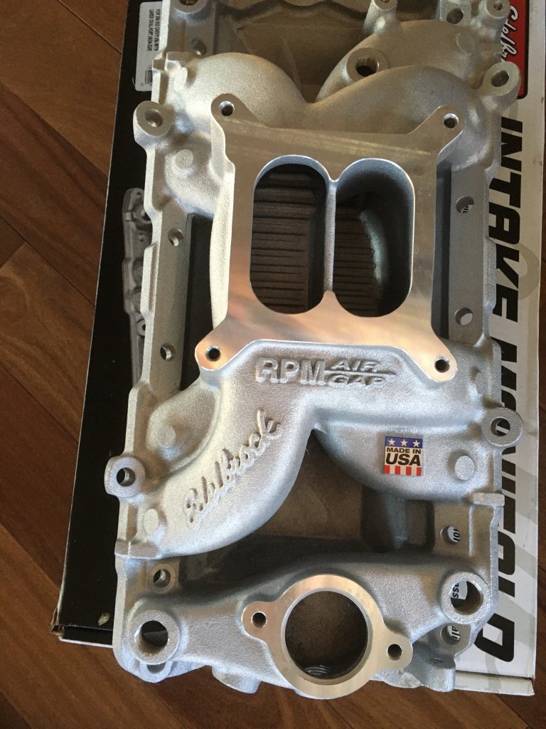

E-Brock oval air gap intake, headers 1 7/8 tube for chevelle, short duration cam no more then 280 ([email protected]) 750 holly. That’s about $1000. Bucks and best bang for your buck. I had that combo and hauled 20 foot trailer with 3 1/2 tons of hay easy, total weight little over 8000 lbs……for years. Excellent throttle response, burnout city. Good proven heads are $$$ forged internals not necessary, stock rotating assembly plenty good. Do the above, and you will love that combo. Down the road and itchin for more, get a top end kit, mid 500 hp and torque. The build above was a I need it build. Build I am doing is an “ old and always wanted it” build. For reference, the AFR 265 were $2600 on sale.

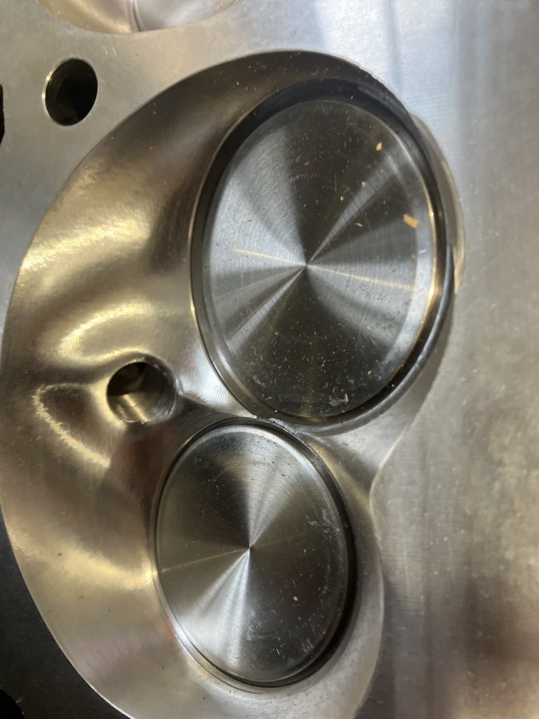

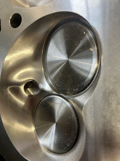

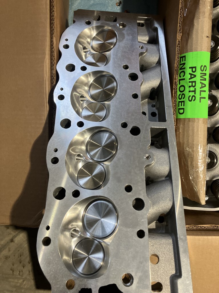

We just put the Afr 265’s on my 454 last week. This thing is a different truck with these heads.

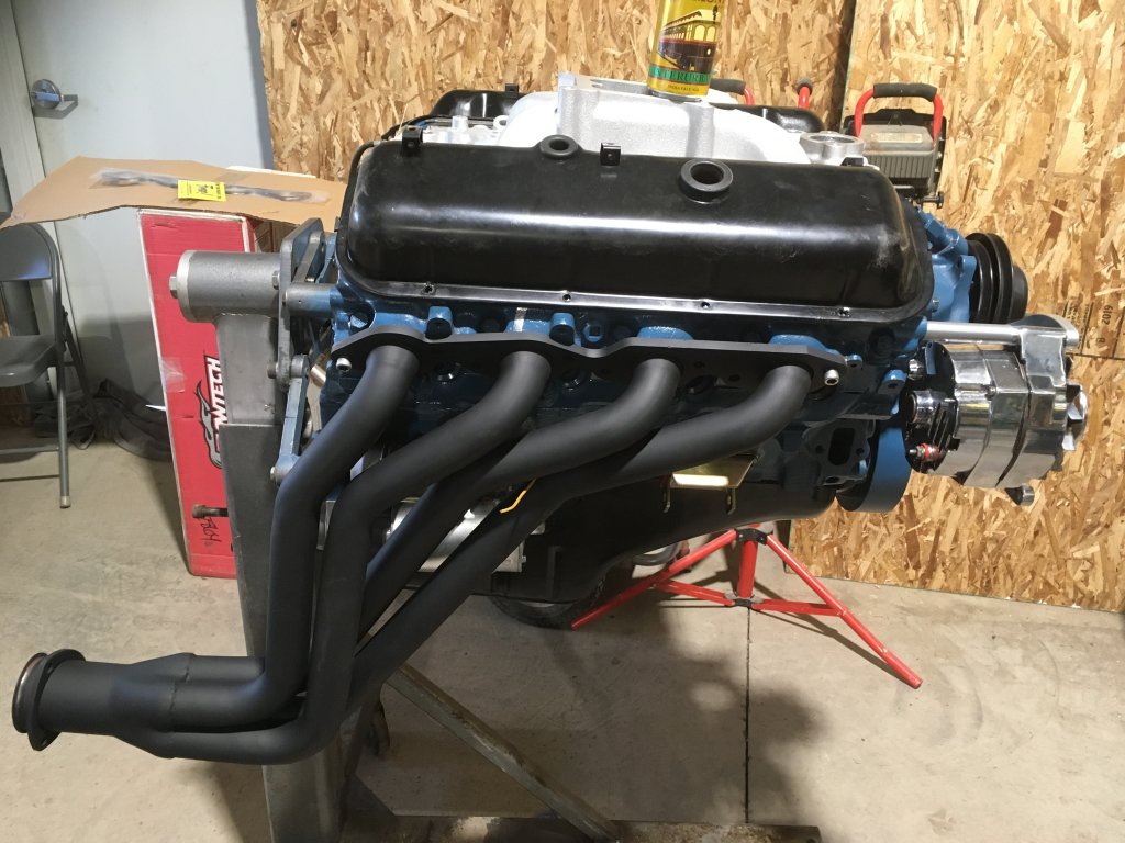

here is my 489 build, not budget, but middle of the road. https://www.gmsquarebody.com/threads/bbc-489-build.45389/

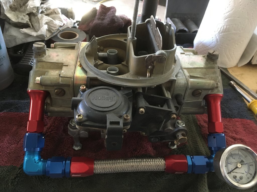

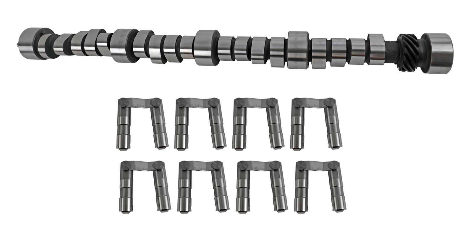

For what you want to do, cam, Elderbrock air gap, these headers have been great, fit and never leaked. This cam is a inexpensive choice, 114 lobe separation, slight amount of lope, all done at 5000 rpm. I am a Holly guy, so I used a 4160 converted to 4150. I tune with an AEM A/F ratio gage, and love that ability, no guessing now.

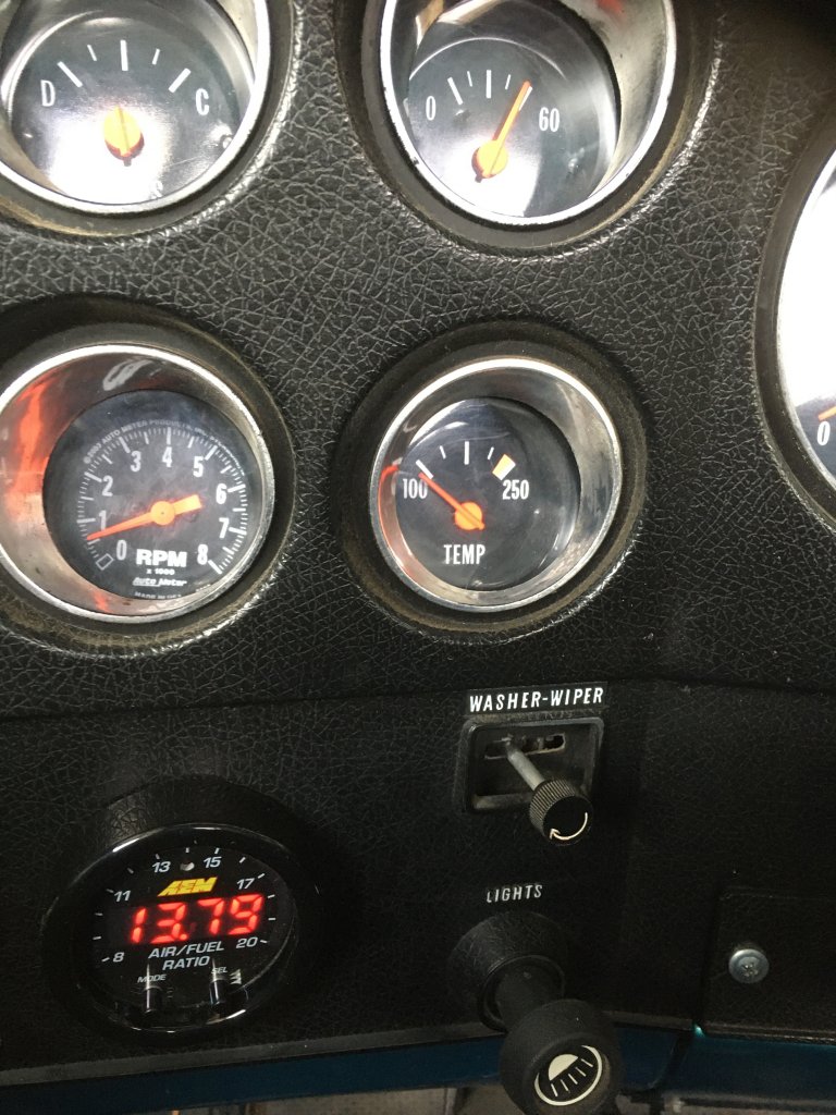

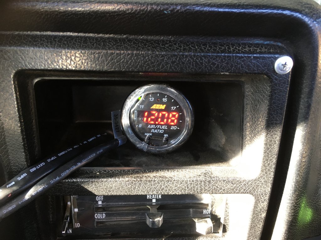

I installed the AEM gage right in my stock cluster. Yeah, we all like the results...
