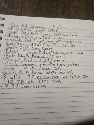

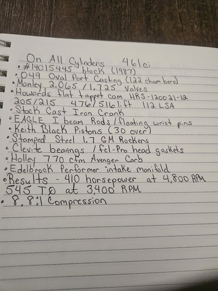

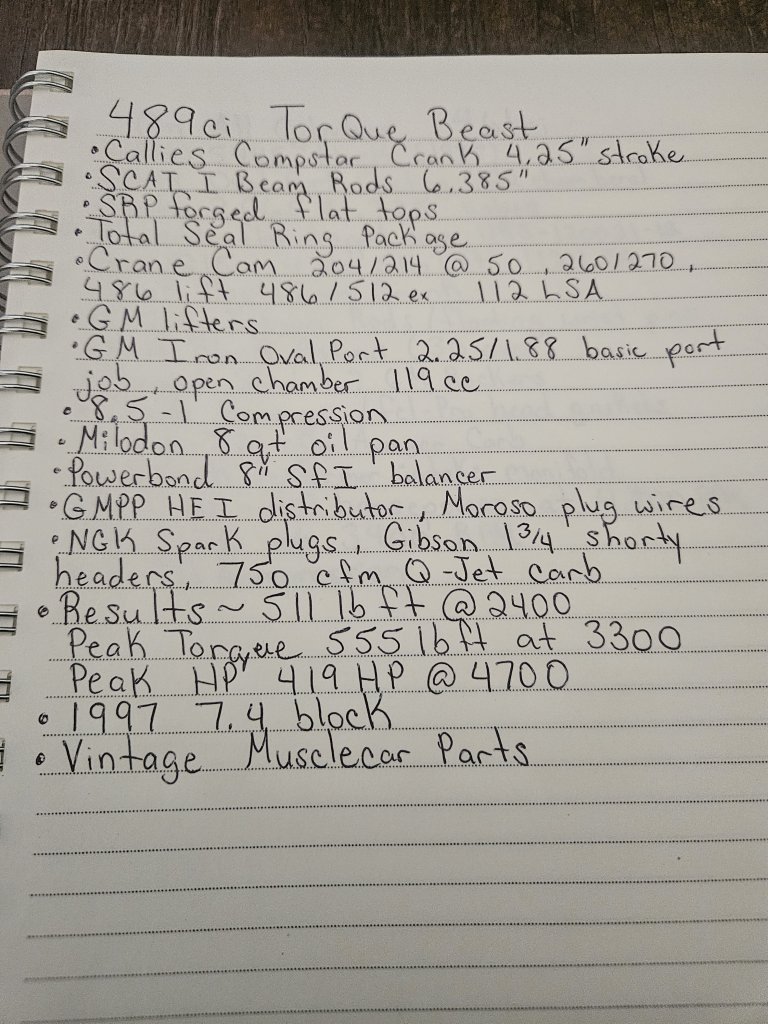

well that sounds like interesting build. Im taking notes and learning daily for sure. I never knew you could run LS coil packs on a L29 with some tweaks. Thats awesome. Keep me posted on how your builds turn out.
Speaking of notes i want to share these with yall and want opinions.

I would stay away from keith black pistons. By the time you acquire and rebuild any of those heads, you could have just bought better aftermarket ones. If you are going to put factory iron heads on anything, your best bet is to go to a junkyard or find an L29 locally and just get the block/heads as cores to start with. There are 2 or three of them on facebook marketplace right now locally to me for ~$400 asking price as just a parts core. I had the entire heads cleaned, inspected, guides replaced, valve job, and new springs installed on my stock L29 heads for ~$500. They flow better stock than even reworked 049 heads will and they will bump your compression ratio up to a reasonable number. You are going to want to be in the 9.0:1 or higher with iron heads. You can get an entire stroker rotating assembly, already balanced for under $2k. You can get a good set of AFR enforcer heads for another $1500-2k.
Best bang for buck would be to get a Gen VI block, the more complete the better. Have it bored .030" over. Run a cast balanced 489 stroker kit. Get yourself a good set of aluminum oval port heads. Call up Delta camshaft and tell them your setup, then send them the stock L29 roller cam core and have it reground custom for your setup. It was ~$140 to have this done for my setup and then you have a high quality factory billet cam core that is custom ground for what you want. You will need to measure your block and order a rotating kit that is going to give you a good quench and correct compression ratio for the chamber cc and shape of the heads you are going to use. Alternatively, have the factory L29 heads rebuilt. They will flow enough for ~600hp with a good cam and intake combo.
A stock Gen VI or Gen VII with a cam, dual plane intake and carb is going to make your numbers you are shooting for with literally nothing else done to them. A Gen VI with a stroker kit will make almost exactly the same numbers as the Gen VII. Here's a shootout with dyno numbers on stock Gen VI and Gen VII by Holdener with readily available cams.

Bextreme~ i would love to see your build on paper or simply just laid out with all the specs on the cam etc.

I wouldn't (didn't) spend the money on new pistons (forged or other) and stay at a low 8.5 comp, I'm not saying shoot for the moon but I'd go for 9:1. A stroker rotating assembly is a decent investment to still end up with a low compression motor when you have choices.

I've recently been watching a bunch of head porting videos and have learned something from it. If going with stock or reworked iron heads, make sure to use valves with a back cut. It helps tremendously with low lift flow.
One option that I have not seen mentioned yet is a top end kit. The Trick Flow combo seems very appealing to me. It operates past the stated goal of 4k rpm performance, but it's no big deal to shift later and take advantage of the power. The torque down low is good too.

Bucket~The 280 TFS heads are bad to the bone. Eric W... a famous head porter and youtube tested a line of oval heads and the AFR 265 and TFS 280 head makes the best torque in the imdusty hands down. Now you got me thinking about that youtube video/channal.
On the pistons... how much compression can we run MAX and get away with 87 octane ? Gas stations are not consistent and we have to think about detonation...
