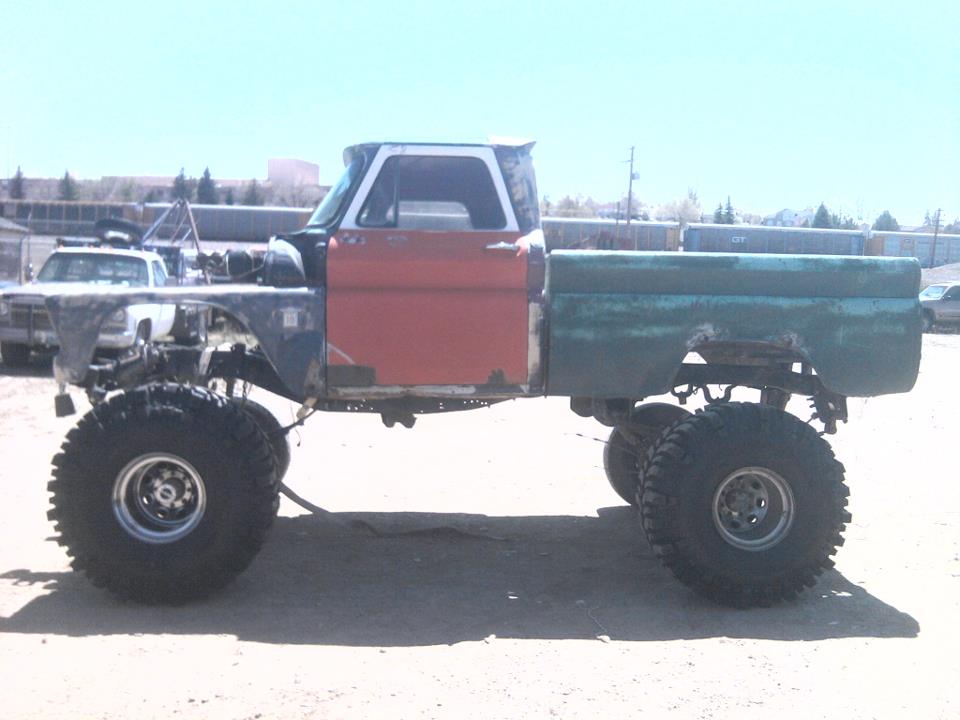

i had that problem when i bought my 44'' boggers
my truck only had 9'' lift so i bought a 12'' lift and have a 3'' body lift

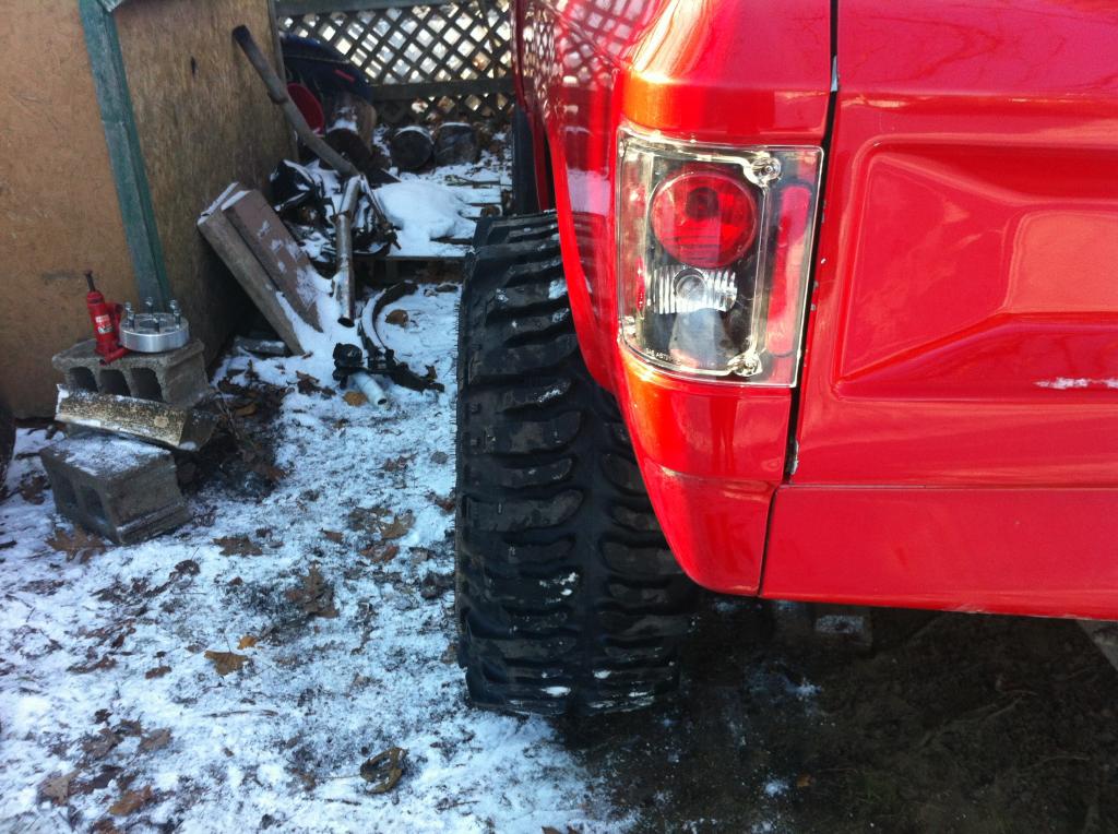

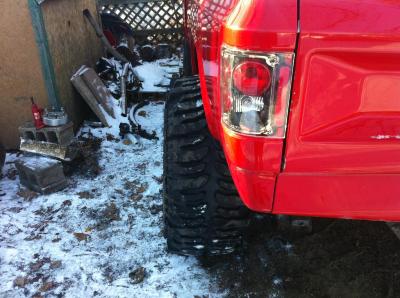

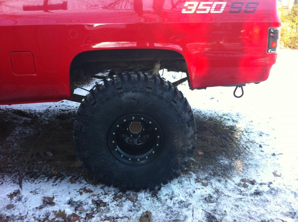

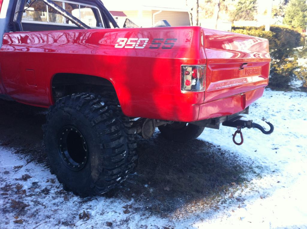

well today one came .. spent all its time at the tire shop. took them all day to figure out how to mount it. they used a tiger torch to get the tire a little warm so it would spread out to the rim...
here are some pictures let me know what u think about it

Is your state ok with the tire out so far?

cops don't say much around here .. if they stop and give u balls i bet there trucks are jut as bad
