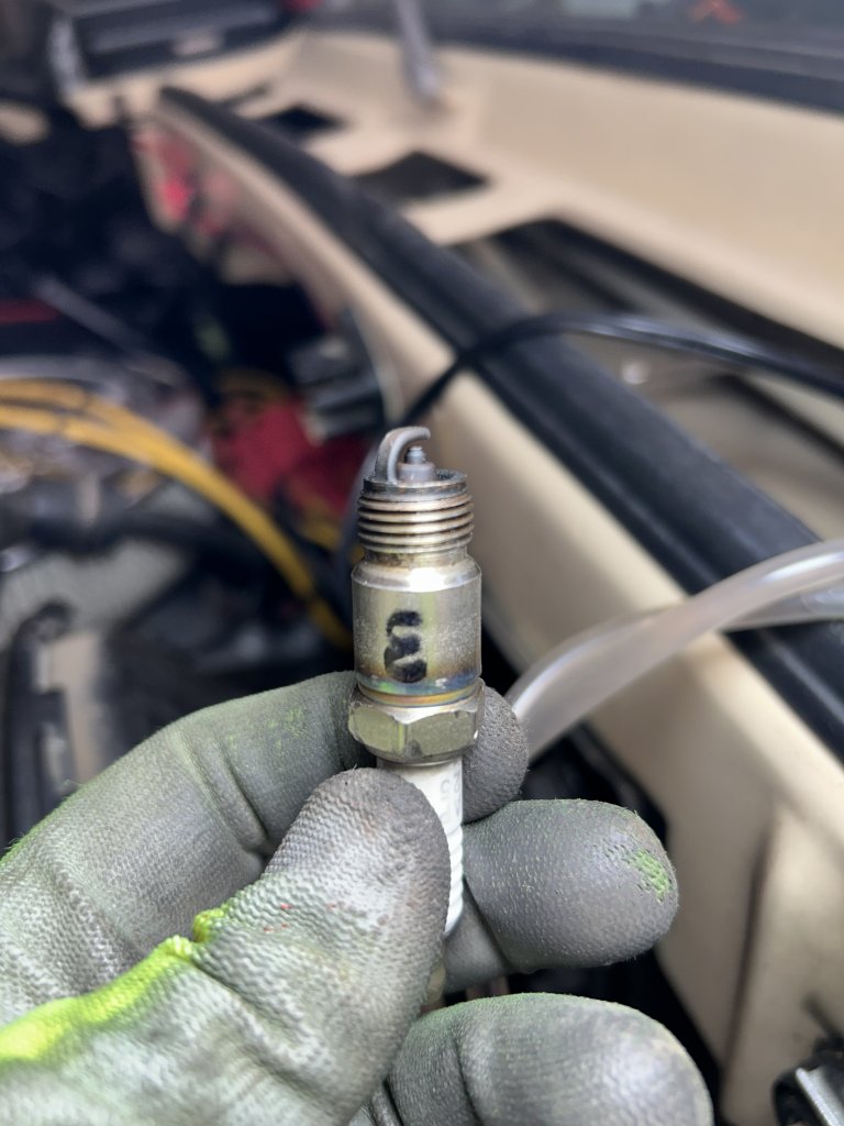

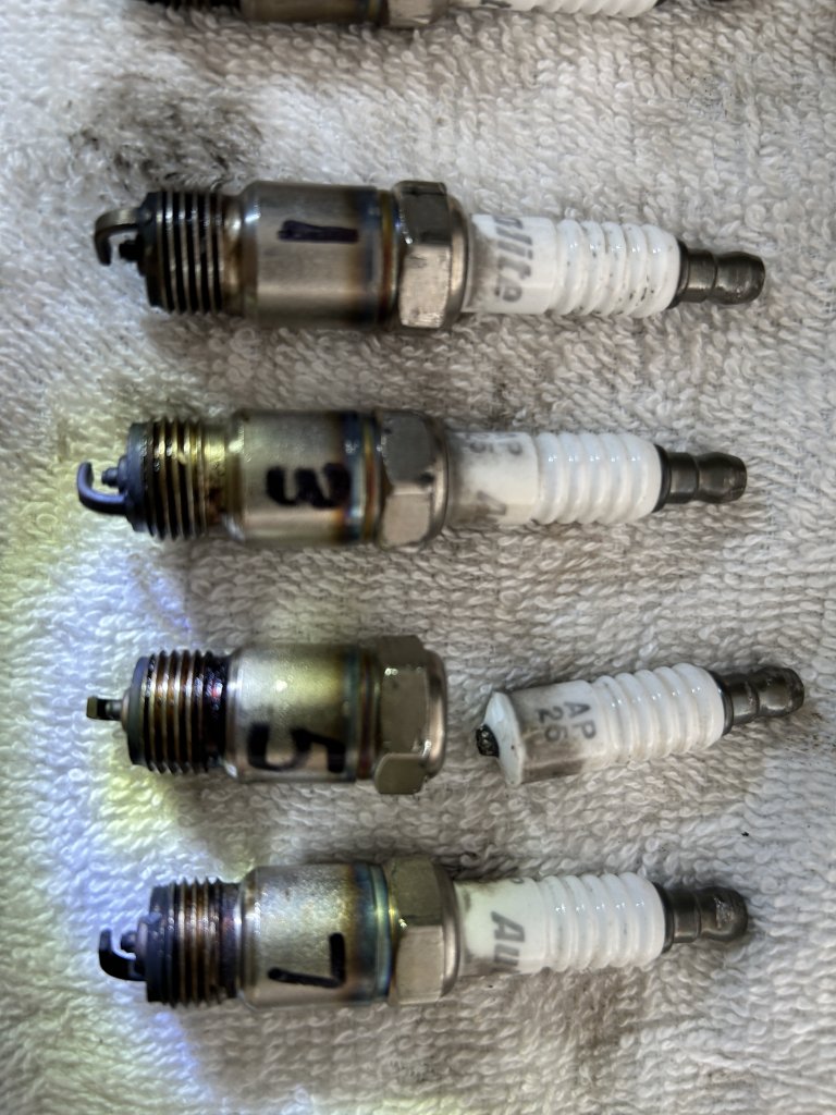

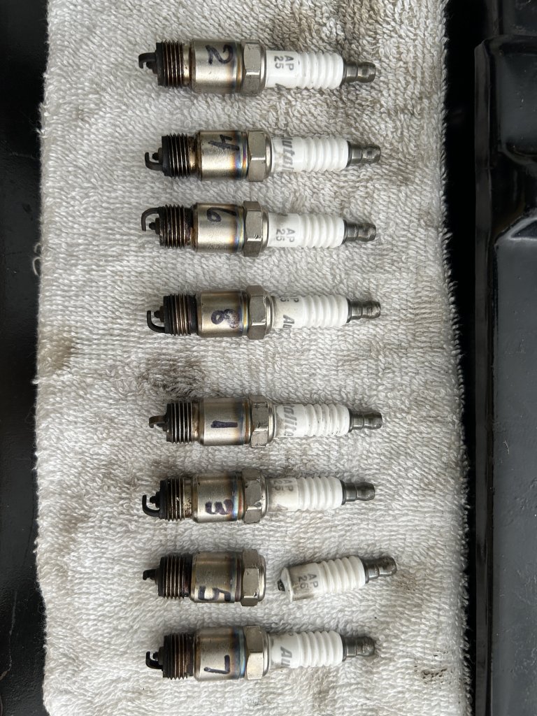

Have you looked at the plugs? Usually if something goes through the combustion chamber,you crack a head into water. Milk shake oil,or you beat up a plug,or you knock a hole in the top of a piston.
Here’s the plugs. Broken one is my fault (socket slipped).
10,175
19,675
Take a hard look at #3 plug are there any metal particles on the porcelain?
