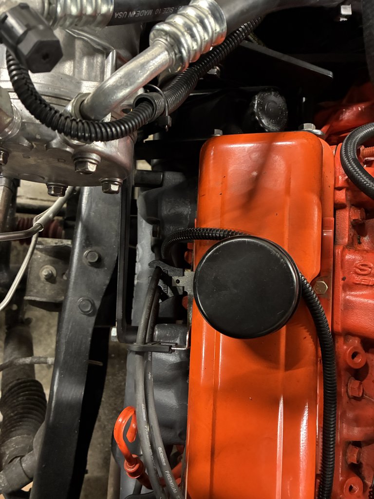

Several of the Vintage Air brackets appear to be the same design as various Alan Grove brackets.
I used Alan Grove brackets with my stock iron manifolds when I mounted a Sanden compressor, and then later switched to a different Alan Grove bracket (which had spacers to allow for the difference in manifold vs header flange) when I installed headers.
IIRC, I took the piece for the PS bracket and cut off some extra material, and reused it with the new Alan Grove brackets. My truck is currently sitting in a snow bank, but I may be able to get a picture of the brackets in the next day or two. My original PS brackets are not the same as yours, maybe because I also had the big A6 compressor on that side.

Awesome. Thanks for that info. Any chance you could snap a pic of that Vintage Air bracket? I’m not sure how close it is to the OEM bracket. This is the OEM bracket:
The factory AC brackets were long gone from my truck, I was replacing it with VA anyway.
You will probably have to add washers or grind/fab a spacer... but that's a requirement with vehicles this old.
