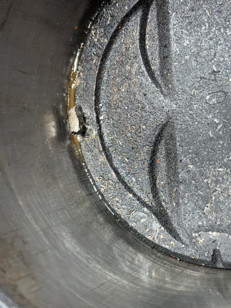

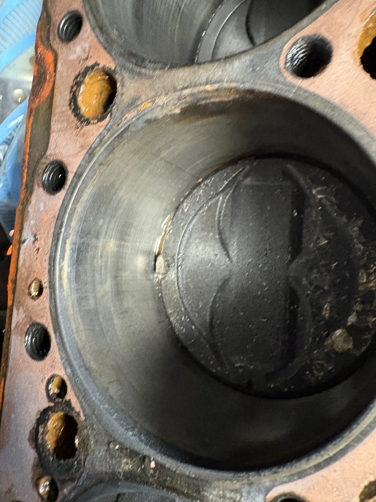

Sorry for the delay in posting. I believe I found the culprit (what's left of my razor scrapper nut) in cylinder 6 (see attached photo). Top of piston looks pitted but not destroyed (see attached photo). Cylinder walls and valves look unscathed as well. I am hoping I do not have to replace the piston head.

I'd pull that piston,make sure it's not cracked to the ring land and make sure the top ring still floats free in the ring land.
