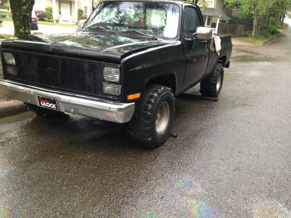

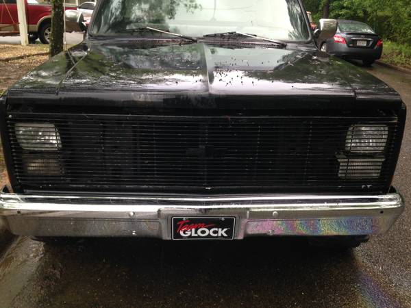

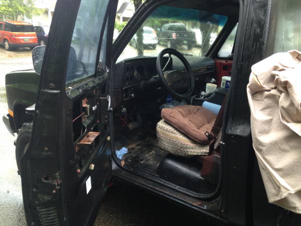

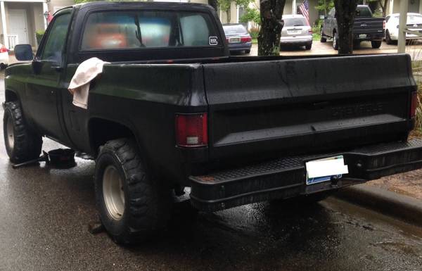

Per the owner
"the main drive shaft/bushing broke two weeks ago... $150 junk yard fix but dont have the time... Truck ran strong before just needed a transfer case gasket kit (which i have and you can install)... Truck cranks but has an engine rattle"
should I not be able to disconnect or hang up that drive shaft to drive it on a trailer under it's own power, or at least be able to tow it with my other truck? How would you transport one in this condition, or would you take a pass with this to begin with?
here is the pics he provided, what do you all think? It's from a local Craig's List ad, I can link that here if you all want. What would you offer for this truck?

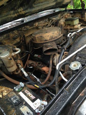

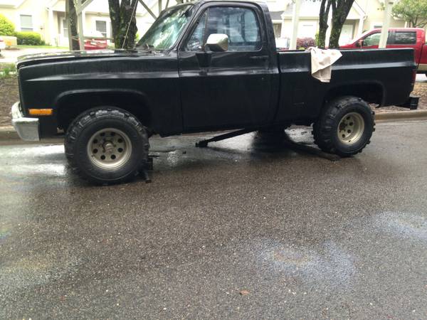

Here is a couple more pics.

I would purchase it with the thought that the entire drive line needs rebuilding or replacing. If its that simple why didn't the seller fix it ???
Its most likely a project and NOT a truck that's gonna be up and running with just a few simple fixes
Never pay very much for broken junk. Think of it as though your buying a parts truck

Yeah, judging from the bald super swampers and mud under the hood, I can guess as to how the drive shaft got broken and why the engine has a rattle. It's probably been pretty abused. Parts truck at best.

That "engine rattle" is probably rod knock. Always expect the worst and hope for the best. I wouldn't pay over $1200-$1500 if you want to mess with an engine and possibly tcase rebuild. $800 for new tires, at least $800-$1000 in things like brakes, electrical, and anything else that might be wrong. Good looking swb, just needs a lot of work.

Thanks for the replies, great catches on all that mud under the hood. Yeah, someone has been beating that truck up, and it broke. Probably more than that is ready to go.

The transfer case pumps fluid out the rear drive out put shaft so with out the rear drive shaft hooked up it will pump all your transfer case ATF fluid onto the ground in very short order. You could put the yoke in but the fluid pressure will push the yoke out and again will pump all your transfer case ATF on to the ground in very short order.
Load it on a trailer or have it towed.
$500 is probably max value for that thing. As I can almost guarantee you that the entire drive line will need overhauling at the very least if not replaced.
