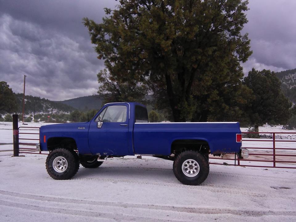

just finished '75 k10
.030 350 flatop, comp cam, eldelbrock, holly
sm465, np208
rough country lift
35x12:50 bfg's
elasticoat blue coating

Cool color. Definitely don't see too many around. But the real question is, how much lift ya got going on there?

i bought a rough country 4" kit
it turned out to be a full 6" in the front. there are 4" blocks on the rear.
had to lengthen front driveshaft and brakelines.
i've installed a bunch of 4" kits and never have to mess with driveshafts/brakelines
every 6" kit required longer driveshaft and lines.
i think they shipped me 6" front springs and 4" blocks
but....
it drives great and actually rides smooth.

Yup, it's the lifted thread, we got all the details, even the overbore on the engine but left out the only detail that pertains to the thread. :shrug: Sup with that? So how much lift? Suspension or Body?

suspension--call it 6"

It looks good. I like that color too. I hear 6 inch is what you want with 35's so they don't rub. I wanted to do 35's but I only have a 4 inch so I guess I'll have to go with 33's. Unless maybe I do a 1 inch body lift, then maybe it won't be a problem if I'm not to aggressive with it.

Did you get a set of HD springs meant for the big block or a winch bumper? Could be a high spring rate pushing you up extra high.
