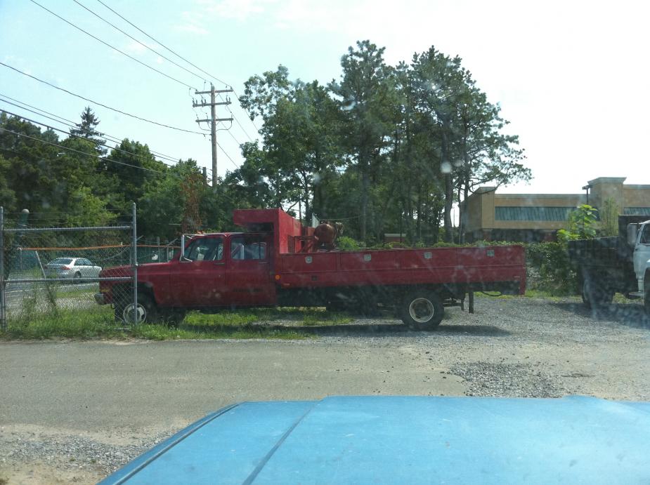

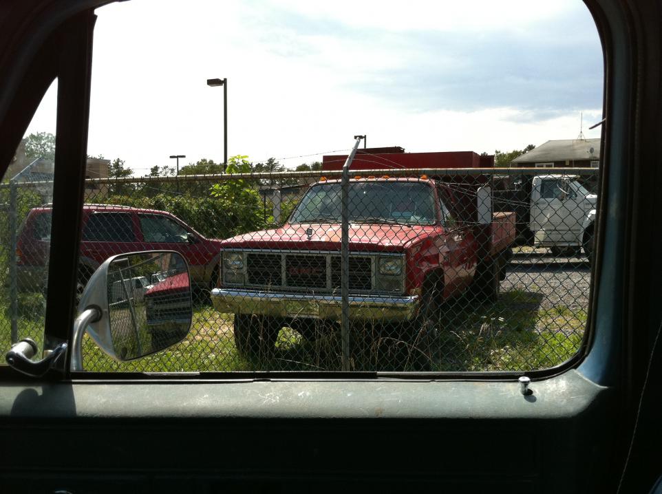

Just got back from going to see the trucks. I have some good news (for you guys) and some bad news (for me).
After the investigation, it turns out:
  • They're both standard
  • They're both 4x4 (huge suprise to me)
  • They're both diesel (but I don't know what engines are in them)
  • I don't know the years
  • They're both longer than a normal crew cab longbox would be
  • The one without the GMC grille is in better condition with both the metal and interior (the interior is actually pretty good but it's completely stripped down to be a work truck)
  • They're both in pretty fair shape overall
Unfortunately, these are not for me. But I did take down the number incase anyone might be interested. The number is (516) 250-1099. That is a Nassau County area code but the trucks are located on the eastern part of Long Island which is Suffolk County. There was no price on them.
And sorry about the ****** picture angles. I couldn't figure out a better way of doing it with the fence and other truck in the way. And I didn't take many because I was being watched, lol.

Assuming that their motors are stock from GM, they would have had the 6.2L Detroit Diesel
The beds appear to be 12ft.
You *could* shorten the frame.

Good god those things are long!
