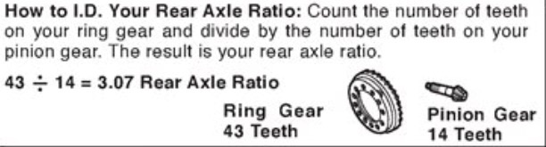

I have a 1976 Chevy K10 that has had a rebuild engine and transmission put into it. the transmission is a TH350 (For what pictures and other posts are showing) and the engine is a 5.7 350. I am running the truck with a 2" lift and 33x0.50x15 BF Goodrich A/T KO2 tires. My issue is that my Speedometer reads about 15-20 Mph under what i am really going. I was stopped for doing 65 in a 45 when my speedometer was reading 45. i need help figuring out what steps i need to take to find the correct speedometer gear.
I hope someone out there is able to help me figure this out before i get stopped again.
