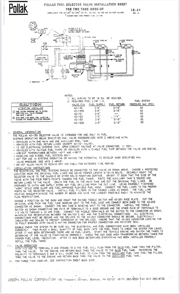

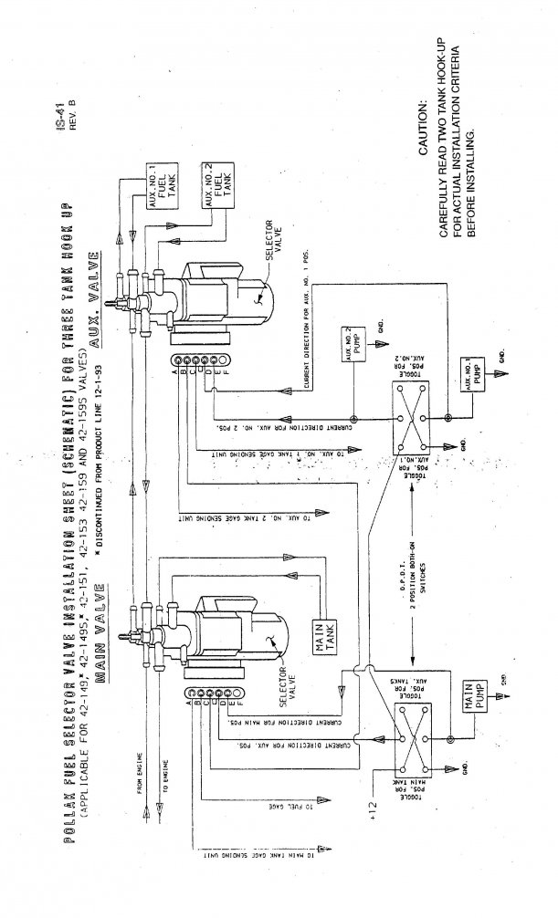

This should help. 454 and towing. Go for the third tank

I never heard of a 3rd tank.
My dad had a 73 surb with 454 and tow package. It had twin tanks...Man, I don't know where you could tuck a 3rd tank in...lol

It would go in the rear of the frame.

On a K or C the third tank would replace the spare tire in the back with a Suburban or K5 tanks. Suburban tanks are around 40 gallons.

Oh, I do remember that tank being huge.
