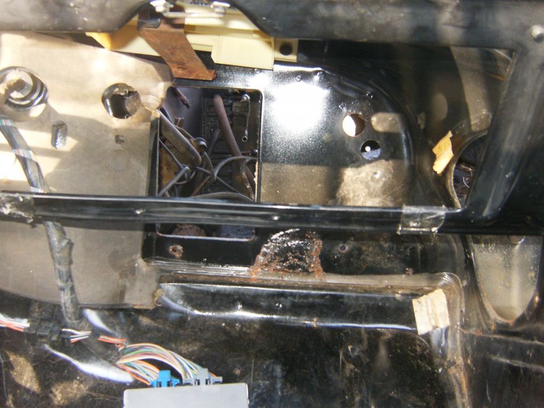

Found an 87 Sierra Classic that's being parted out. I'm halfway through the A/C system ($20) disassembly.
Going back up today to finish the A/C system and wanted to double check on a couple of things.
Also grabbing the power window/locks. Complete system harness, glass regulators/motors, lock solenoids and all switches (including a real nice set of Sierra Classic door panels) $30. The door panels and inserts are red but I can make them black.
Quad headlight system - buckets, springs, adjusters and harness from the fuse block to the lamps - $0 (free I think). Already have the radiator suport and a mint grill (the kind with the parking lights behind it).
A set of "GMC" cab trim corner wraps

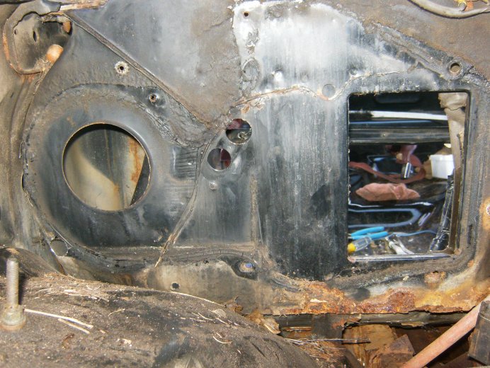

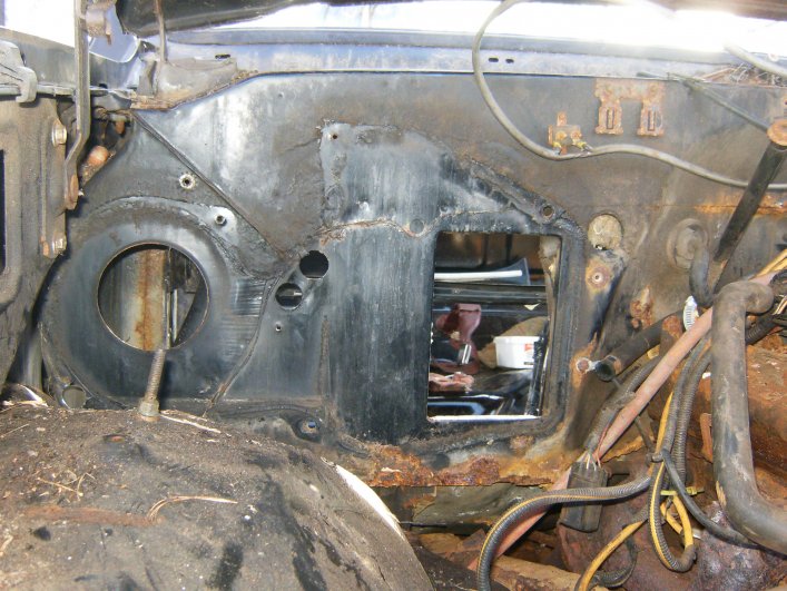

Jerry (chengny), it was a pleasure talking with you on the phone last night. Posting the image you emailed me per our discussion of your current project:
1,029
Some more:
1,029
And the rest:
1,029

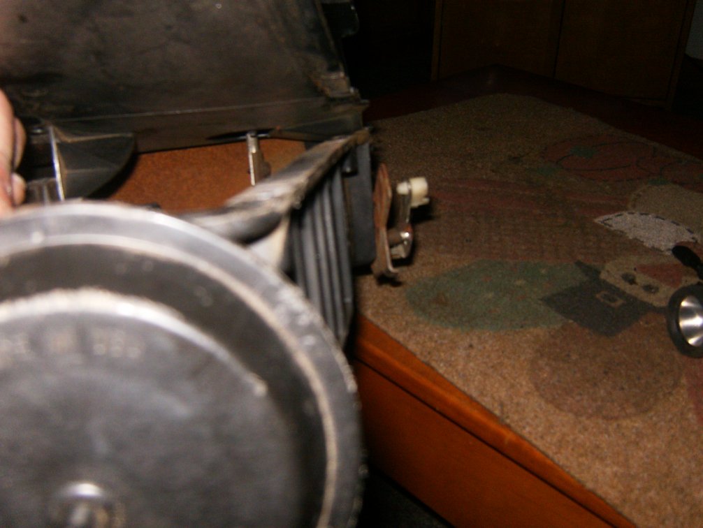

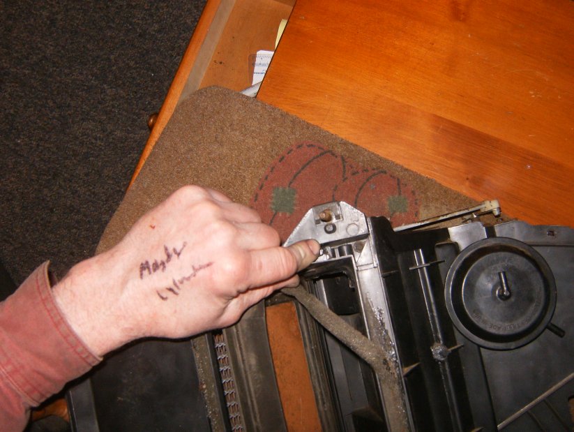

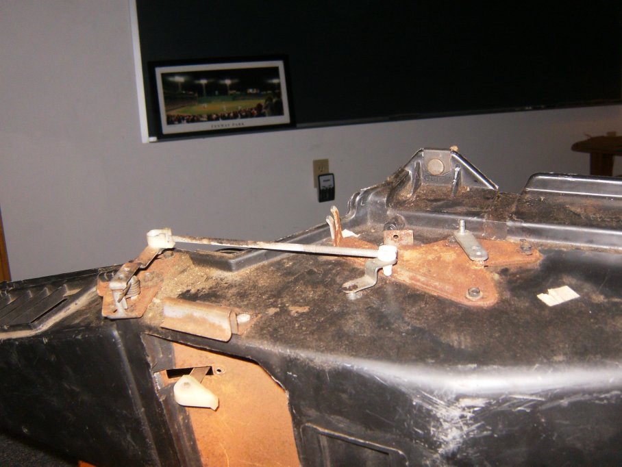

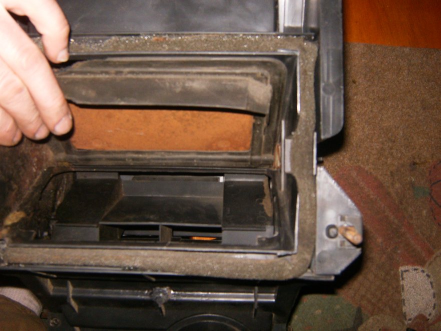

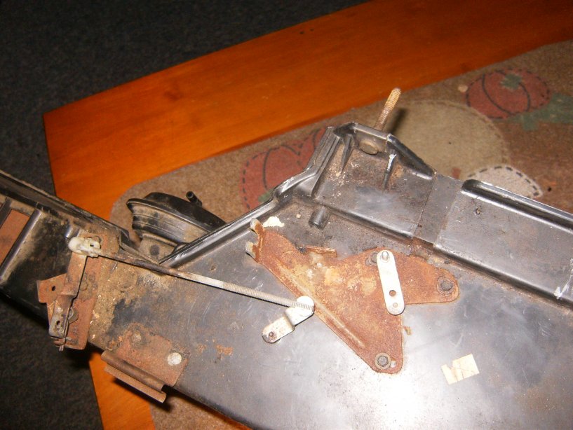

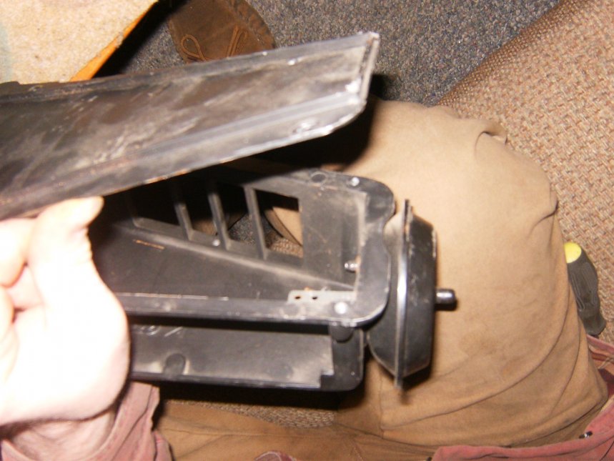

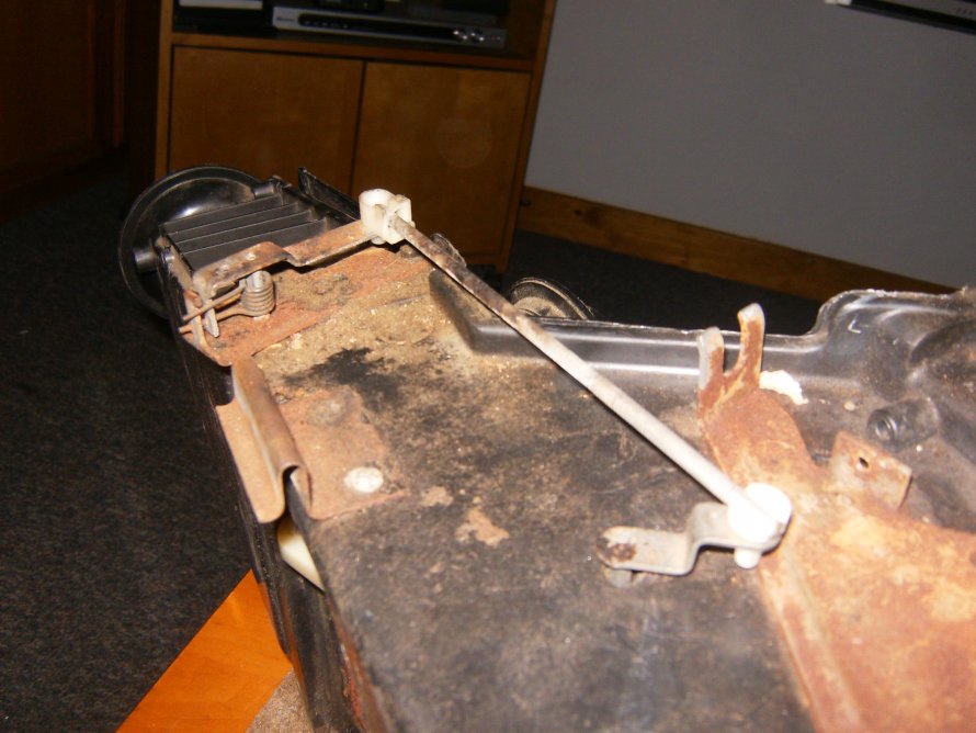

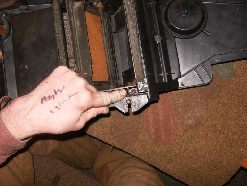

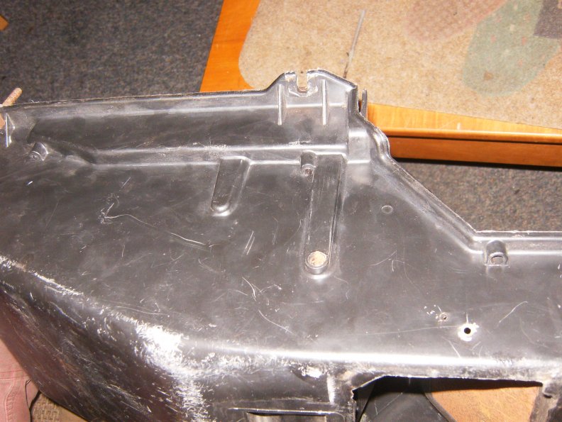

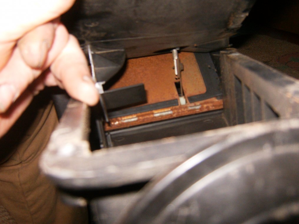

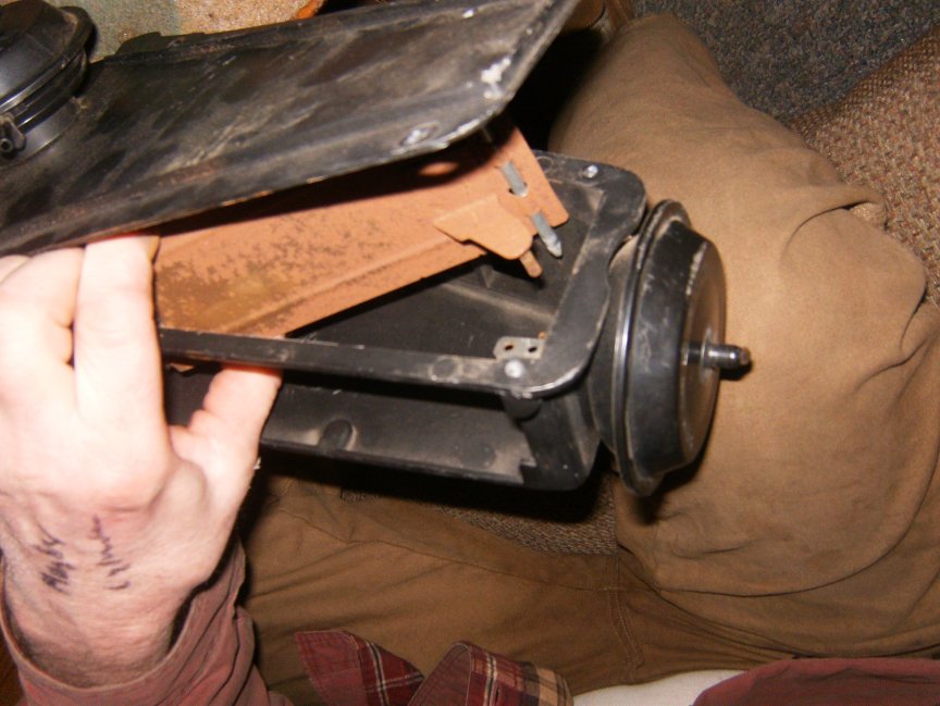

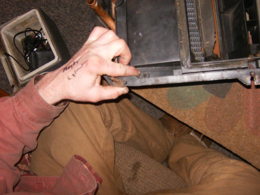

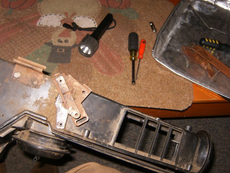

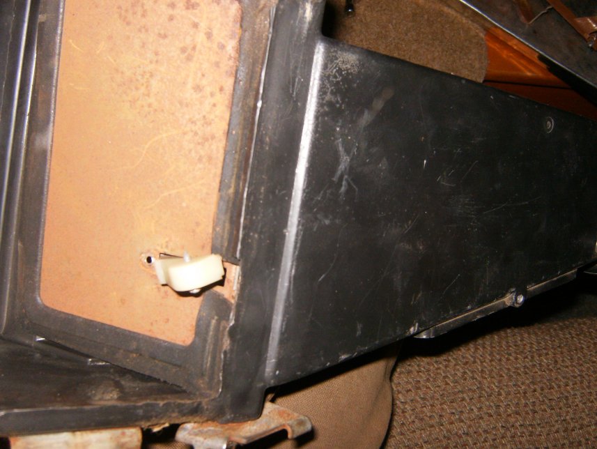

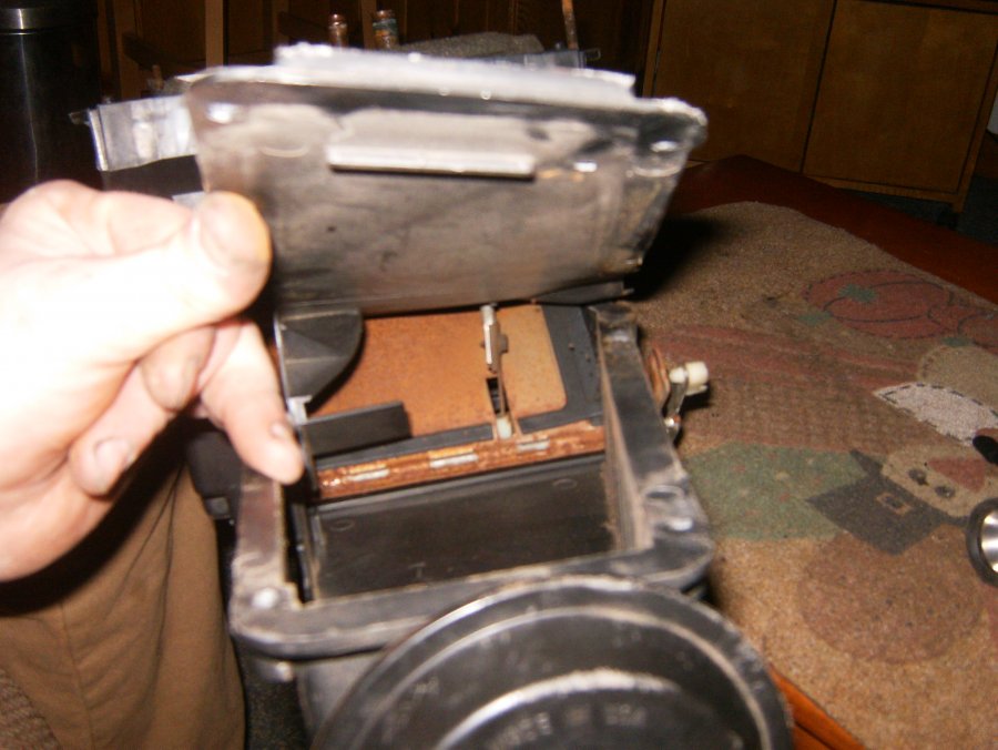

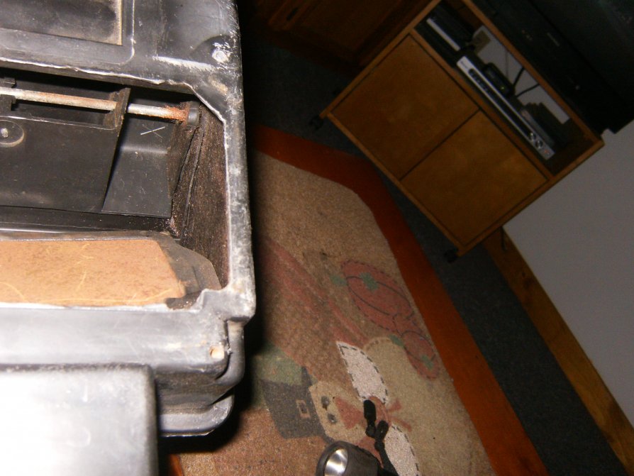

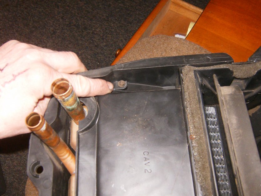

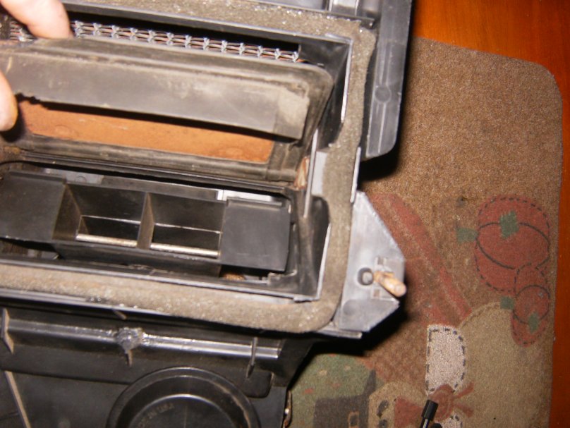

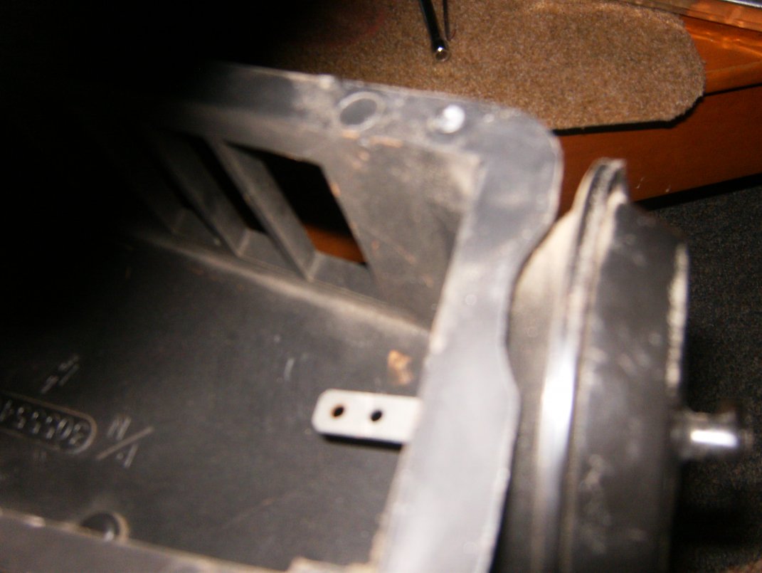

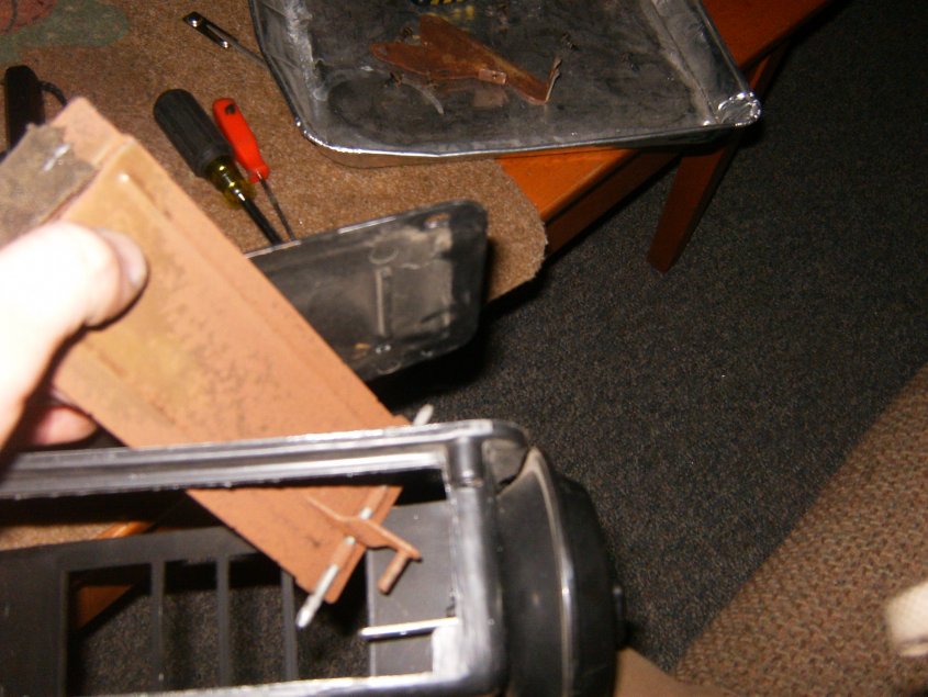

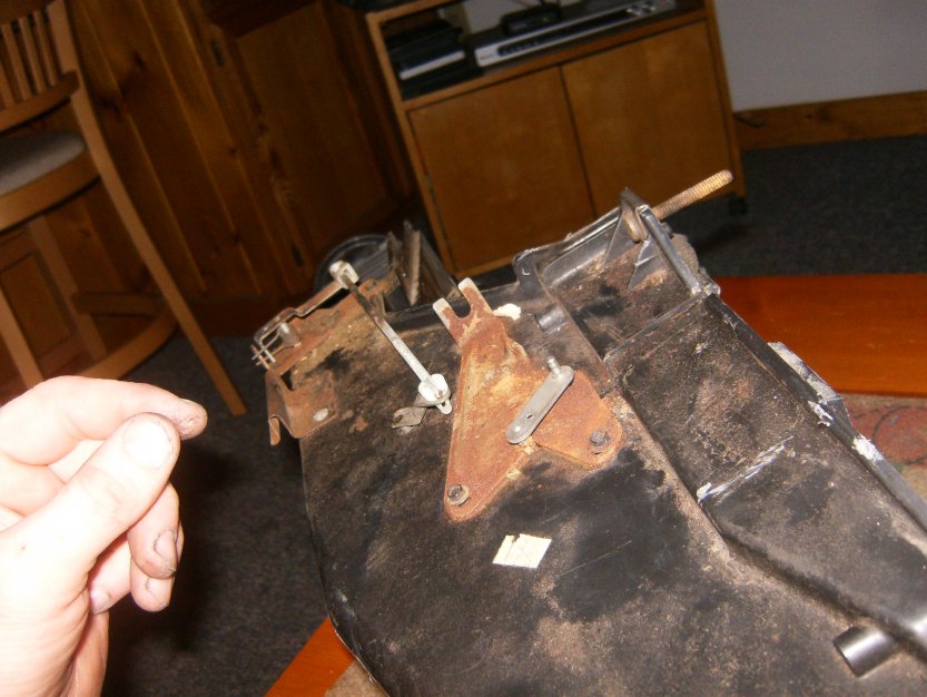

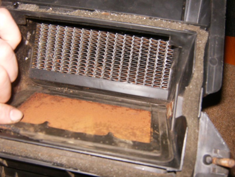

Some additional views of air handler
Just some views of an A/C equipped air handler being disassembled:
1,029
I guess 5 images per post is the max. Here are 5 more:
1,029
5 more
1,029
And another 5:
