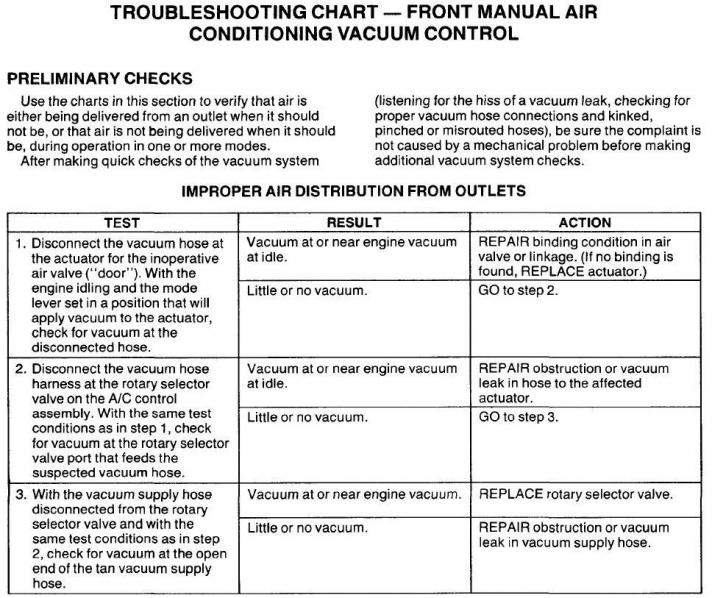

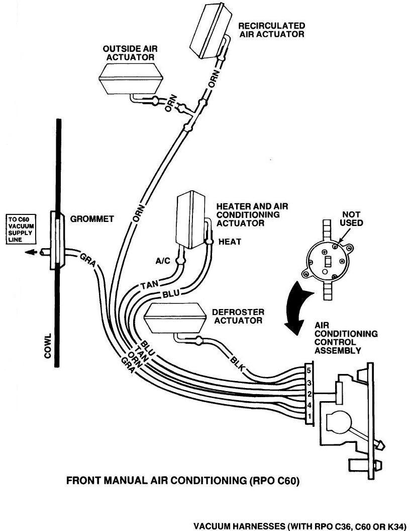

Vacuum operated A/C troubleshoot and vac diagrams

That's awesome ****. To bad the test is to small to read. I need to figure out what you were talking about to adjust your defrost door. If I use a vac pump, mine works good, but I don't seem to get enough vacuum to open the defrost blend door, so I still don't have defrost.

Which one, the 3rd one? Or both of the last ones?
