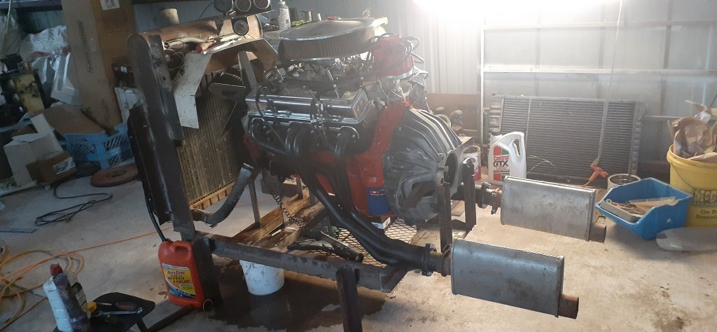

This is what I came up with to do first start up on rebuilt engines. I can start them up and break in the cam and check for leaks and everything else, before I put the engine in a vehicle. That way, at least if it does wipe out the cam, I dont have all the time and labor of installing and removing the engine.
It seems like every time that I put an engine in a vehicle, there is always something that I don't like about it.
On this one, I had a slight leak on the back of the intake (because I pulled the intake off at the last minute, because I thought that I dropped a valve cover spreader through the head, but I didn't), and I didn't put new silicone on it. It was easy to pull the intake and re-seal it while it was on the stand, instead of in the truck.
Not to mention how fun it is to just start it up and hear it run in the shop.
