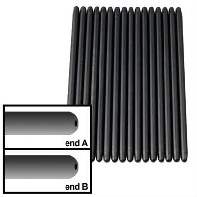

After I put the truck away tonight, I came inside and started taking a look at pushrods for this engine, and rocker arms. Most all the pushrods I see are chromoly material, and hardened and can only handle anywhere from 300 to 350 pounds of valve spring pressure. Mine valve springs are 402 pounds as stated above. Crap. I can guarantee my stock pushrods can't handle anywhere near 402 pounds.
I found these here (not available until November!!!) that should work (higher spring pressure mentioned);
Now I need to find some good rocker arms & pivots, just unsure of what to get. Prior to doing any of this however, I need to pull the valve covers, and remove the rockers & pushrods to see whats going on. I plan to do this in the next couple of days.
With reading the above, would you guys also be looking into the valvetrain like this too? I "think" I am on the right path. I have not had this happen in prior builds with this kind of valvetrain noise.

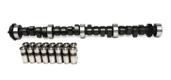

I have a higher compression (stock around 9:1 to 10:1) 1969 Olds 455 with C heads. Here below is the cam that I have.

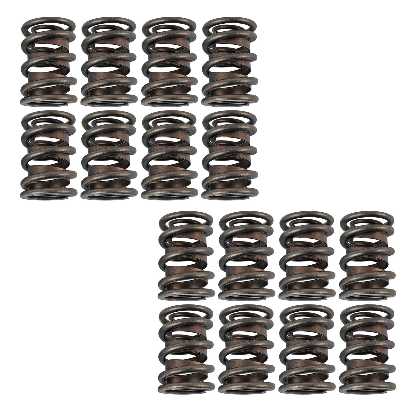

Here are the springs that are supposed to be installed with the above camshaft.
The above is why I "think" I am hearing noise. I am starting to think my pushrods are bent, or bending, or flexing.....something is wrong. I plan to remove valve covers tonight.

Now I wish they had listed a suggested pushrod too. From what I have read, most pushrods can only handle up to 350 pounds of pressure. Wonder what my stock ones would be rated for then??

Its a thumper cam, so they have big duration and lower lift in order t ogive it a "lumpy" sound without actually making the dynamic compression too low. It replicates that "full race" lumpy idle without all the downsides of having an actual racing cam and crazy high compression on the street. They are generally considered a show, not go, type of cam.

I'm reading that spring spec as 402lb/in of spring rate. Since you have less than 0.50" lift on that cam, you shouldn't have anywhere near 400lbs of spring pressure open, unless you have 200lbs of seat pressure. Who set up the springs and installed height? Did you actually measure seat pressure and open pressure?
The comp cam spec calls for an installed height of 1.700". At that installed height you would have a seat pressure of 115lbs. With your cam, that would then give you an open pressure of:
Intake: 115lbs + (0.491*402) = 312lbs
Exhaust: 115lbs + (0.476*402) = 306lbs
Which puts you right in line with what the chromoly pushrods can handle. Hardened isn't for strength. You need the hardened pushrods if you are running guideplates. Are the stock pushrods 5/16"? I see that several companies make valvetrain kits to convert to full roller rockers with guideplates and 3/8" pushrods.

It is also worth noting that those are dual springs. It has been mentioned on a few sites that it is a good idea with the issues with lifters and flat tappet cams going flat lately, that it is a good idea to do the cam break-in with the inner springs removed to give the cam and lifters the best chance of living. Once cam break-in is complete, you can then reinstall the inner springs.

I will probably still put in those heavier 3/8 pushrods from the link above also, just to be sure.
