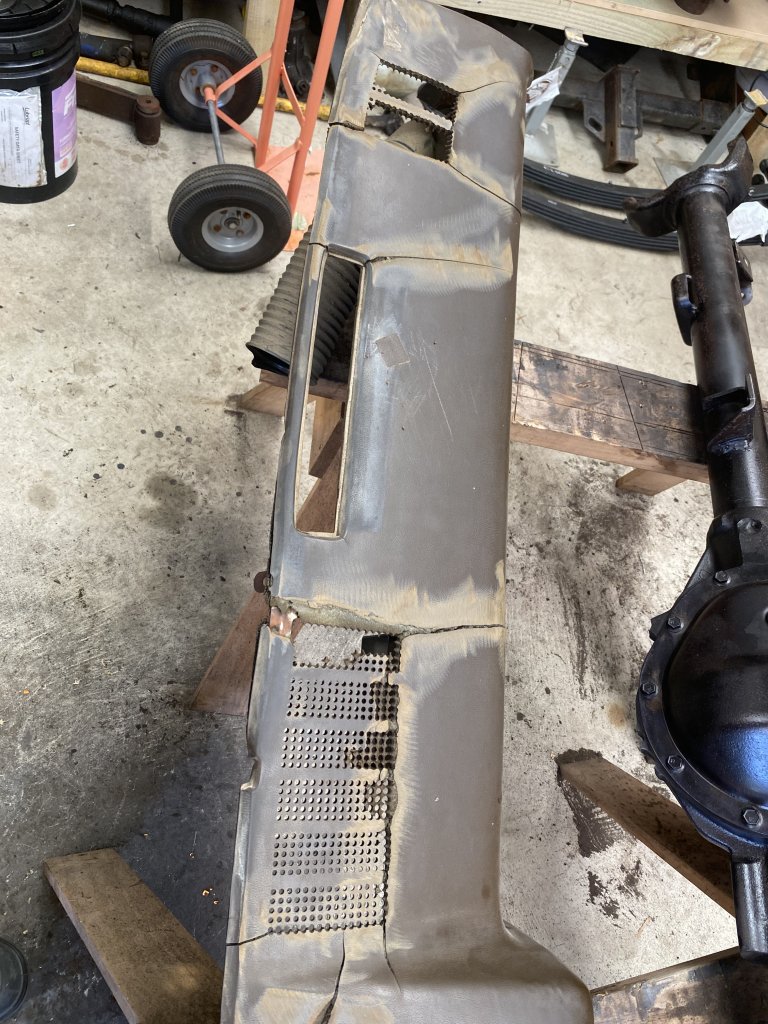

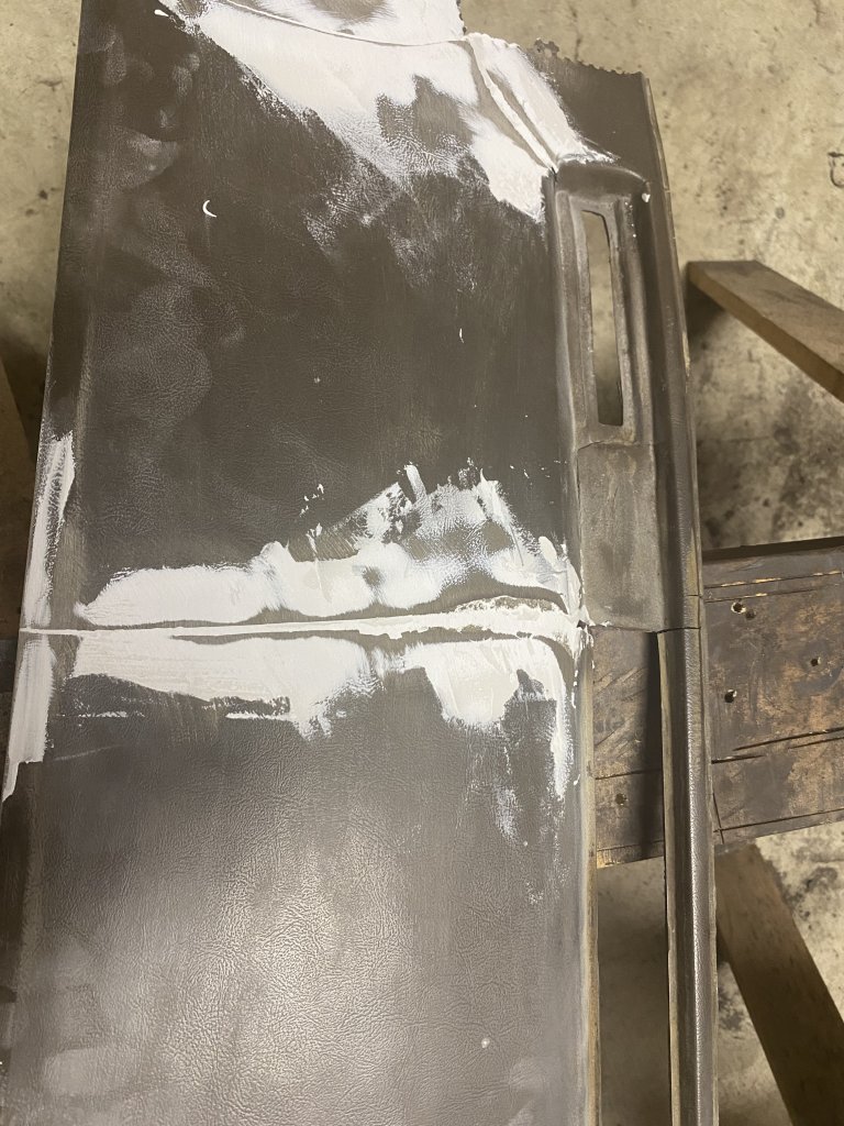

I went with coverlay from summit. They had a good deal that came with decent door cards. I filled the cracks and sanded down the high spots, treated the little bit of rust underneath and then glued the coverlay over top.
