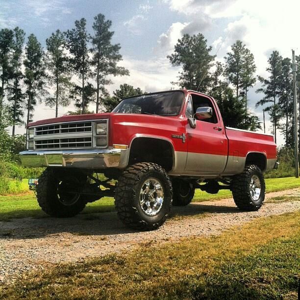

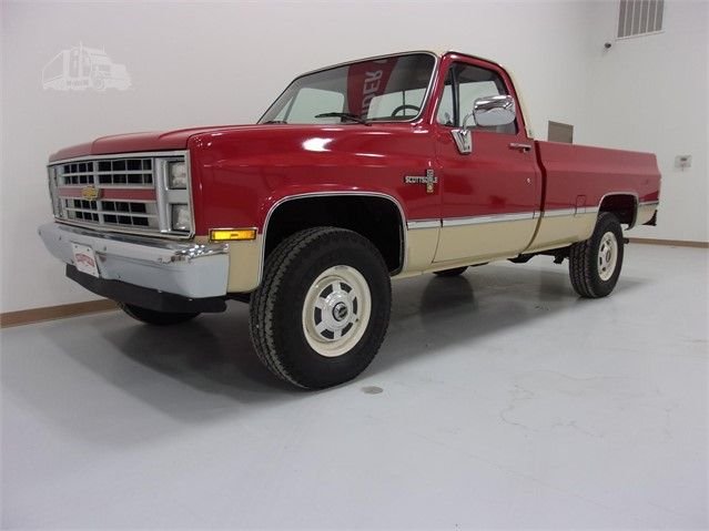

Here's exactly what my truck looked like when the paint was still perfect 15yrs ago, still got the stock wheels and caps on it with Co-op Grip Spurs still on it.
The red and grey scheme on this 87 with some similar Mickey T's is what I'm thinking mine will look like when I'm done.
