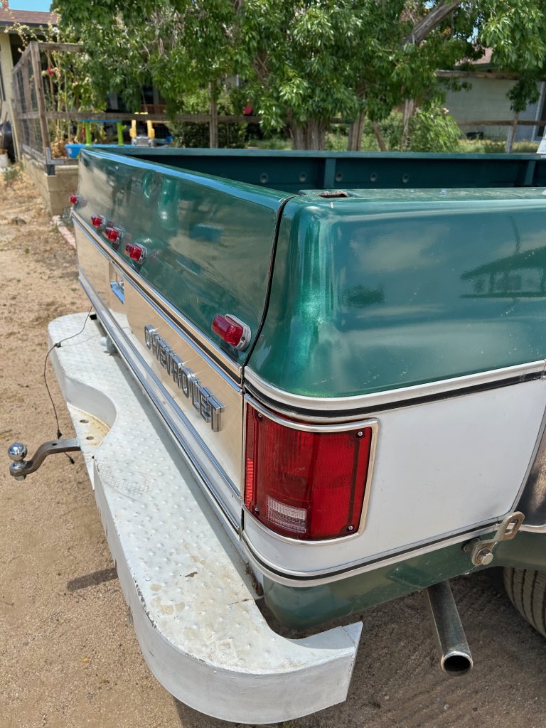

The tailgate didn't sit right since I bought the truck. Turns out the previous owner (who bought the truck from the original owner) said the tailgate was never installed on the truck. There were no trunnions or straps. I did a little research and found out that from 73-75 the straps were 15.5" long, and 76-80 they were 16". The previous owner installed hardware but they were the 76 and later variety so the tailgate hung too low when opened, and sat too high when closed. It was clear they weren't right, as he obviously had to beat them to get them to fit.
I replaced them with LS Fabrications stainless steel trunnion kit that incorporates a Delrin bushing and cable type straps. The tailgate closes much nicer, sits in the proper spot and doesn't rattle around while driving, or opening.

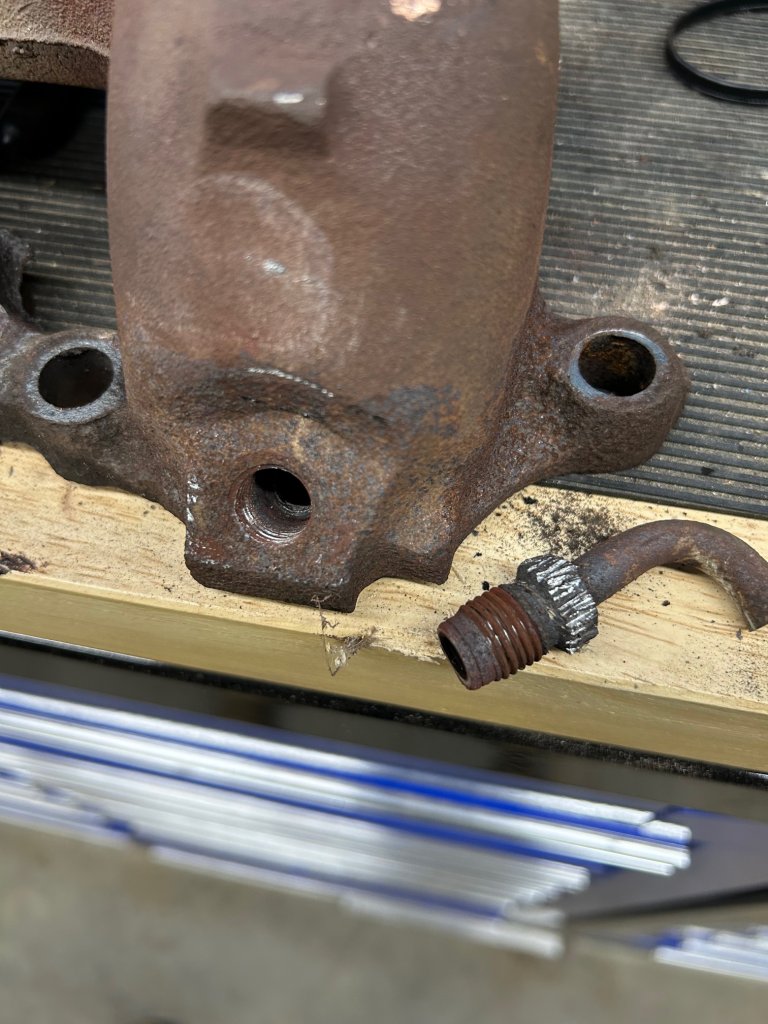

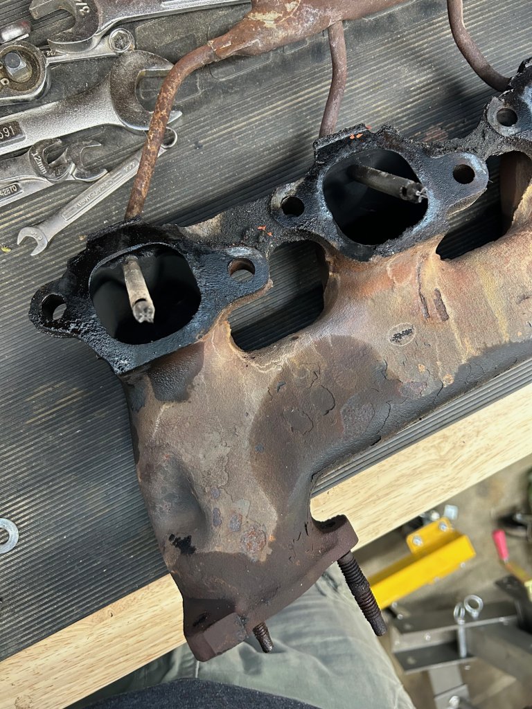

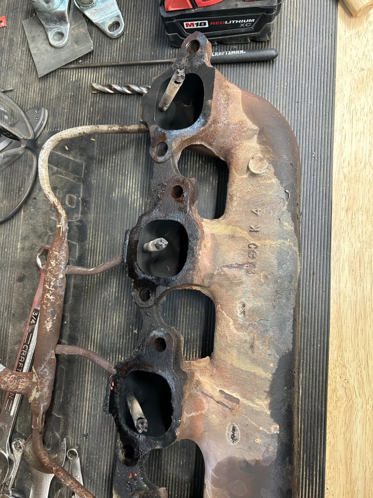

I chased down an exhaust leak from the left side of the engine. Seems there were a couple of problems, 1. the manifold wasn't tight at the rear, and 2, the number #5 exhaust port on the manifold side looks to be a little deteriorated. I'm hoping a thick gasket with metal around the port opening will seal up the issue. If not, I'll likely have to replace it.
I removed the smog tubes. The #1 cylinder was frozen in place, I had to soak it, and use vice grips to alternate tightening/loosening in order to get it out. I'll install some steel plugs to close up the holes.

If there is anything worth using, I'll offer it up on here. As it stands, everything has been seized and isn't coming off whole. The smog tubes on the manifolds did not want to come out. I had to use unconventional methods to remove them. They're trash. The previous owner had removed the smog pump as well as the factory intake and carb, so those are gone as well.
