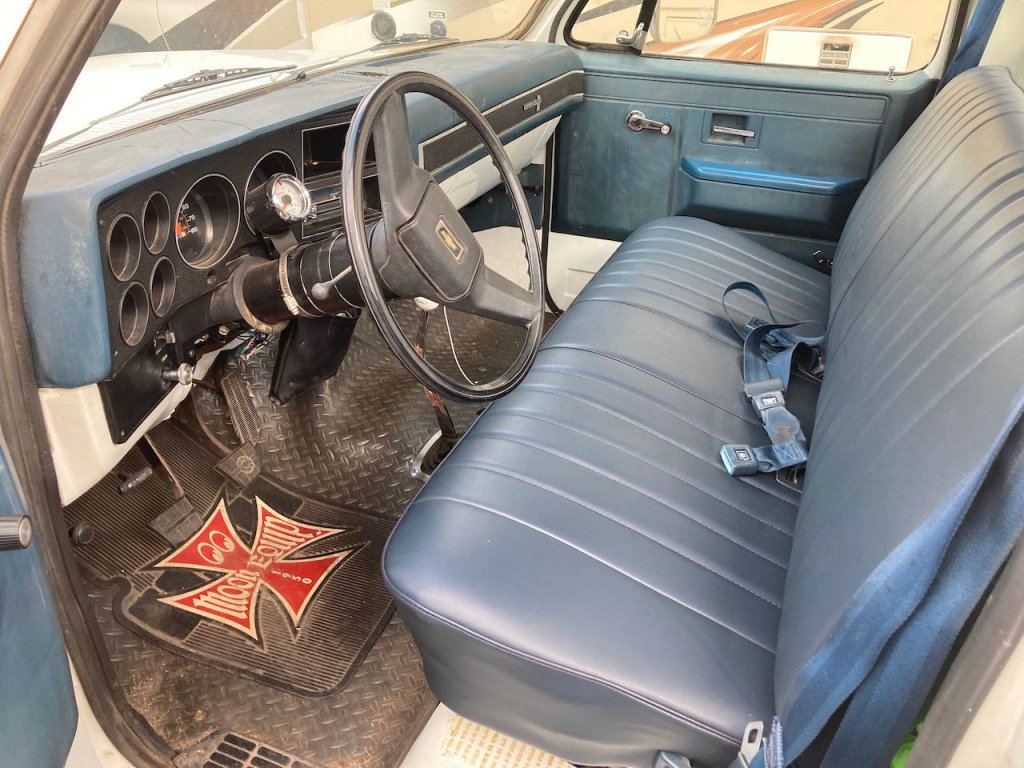

Great procedure. I think I will try it. I like your tach placement
That pic is the exact same tach in the exact same place and mounting as the one in my truck! Lol
Got one too right there. Lol
Mines held on with bailing wire. Lmao
Got a couple mounted there myself.
Same sunpro tach too! Lol
