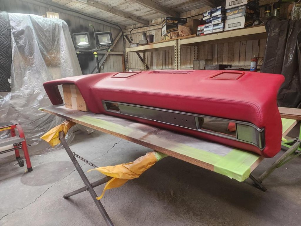

The brown one that I did awhile back sat in my front yard without a windshield screen protector (cardboard) and it did mess up around where I had redone the factory speaker holes. I am almost redone with that repair. I did two different dashes, the brown one and another red one that I covered in red leather which still looks fantastic.
The next one that I do, I will strip all of the old foam off and add some thin foam, then either cover it with FRP or Epoxy. Eventually I will figure this out!
For most folks that want a hard shell dash, I would suggest one of the replacement shell covers and be sure to remove the old one using a heat gun prior to installing the new one. I think that I might even do that before I cover a dash again in leather due to the amount of labor involved in a leather cover.

That is probably your best bet as once that original foam is dried out, it is all dried out and will continue to crack.
I now wish that I had stripped my entire foam off prior to covering it with leather which took quite some time.
