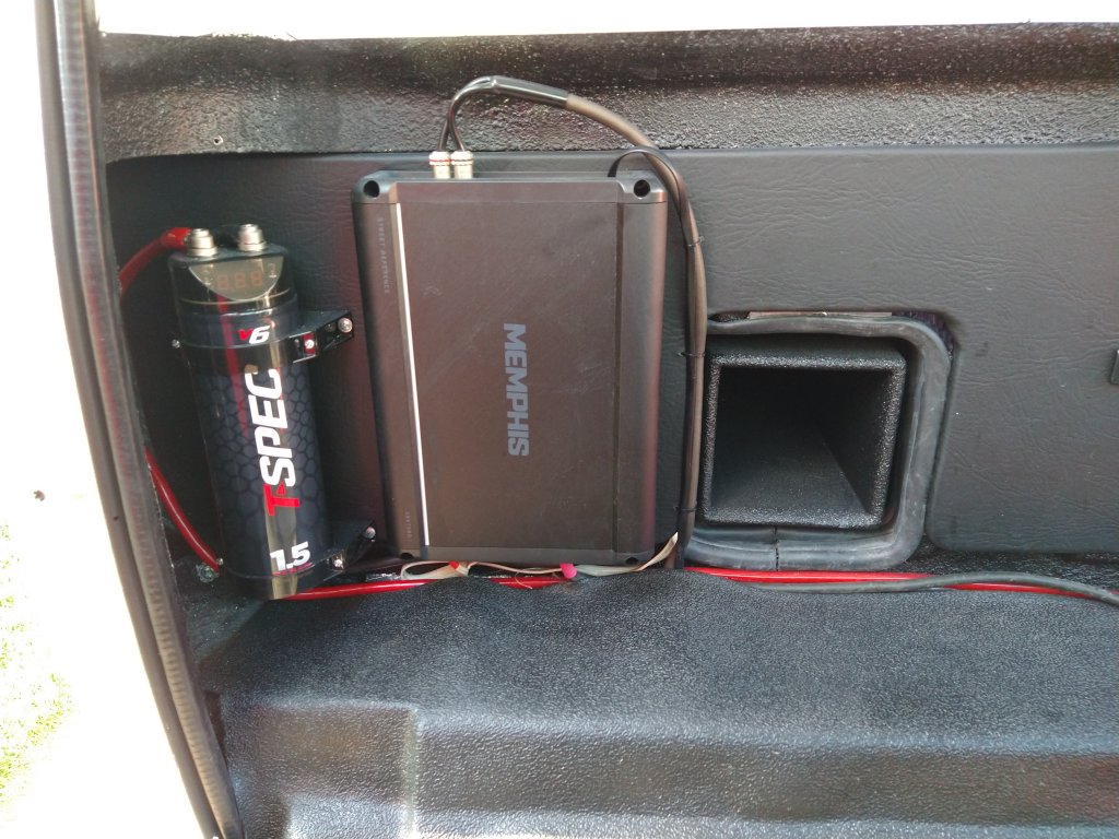

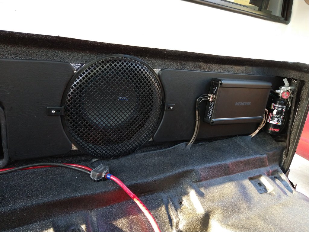

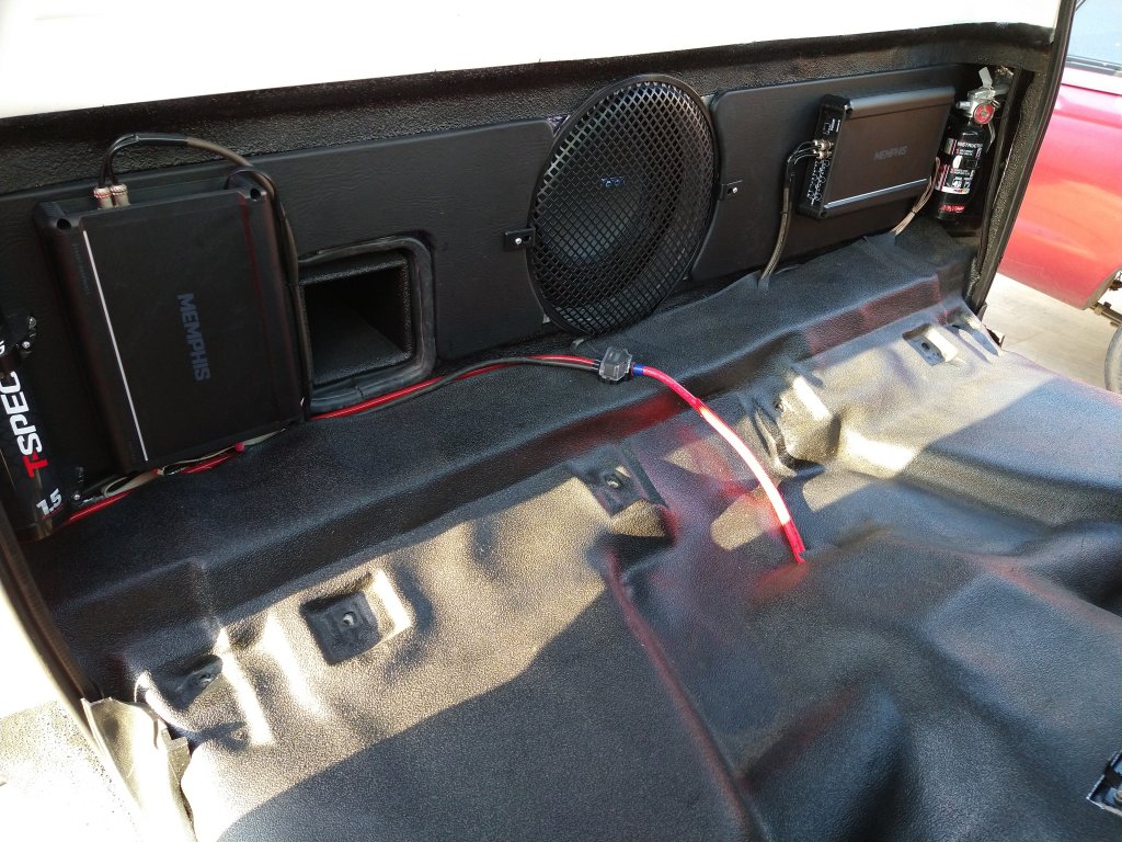

This is how mine is. It works but I'd also like to add either another strap or some sticky velcro to the lower side to hold it against the cab wall instead of letting it flop around.
Edit: in the past I had it mounted to a board and just set it underneath the passenger seat. That worked well too.

Thanks for the help. First time I've installed an amp and sub. Great pics. looks great.

Thanks for the reply. My amp and sub look to be about the same size. Great pics.

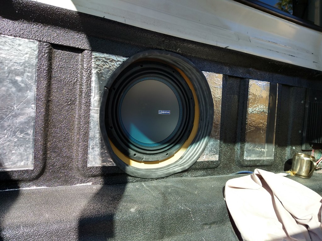

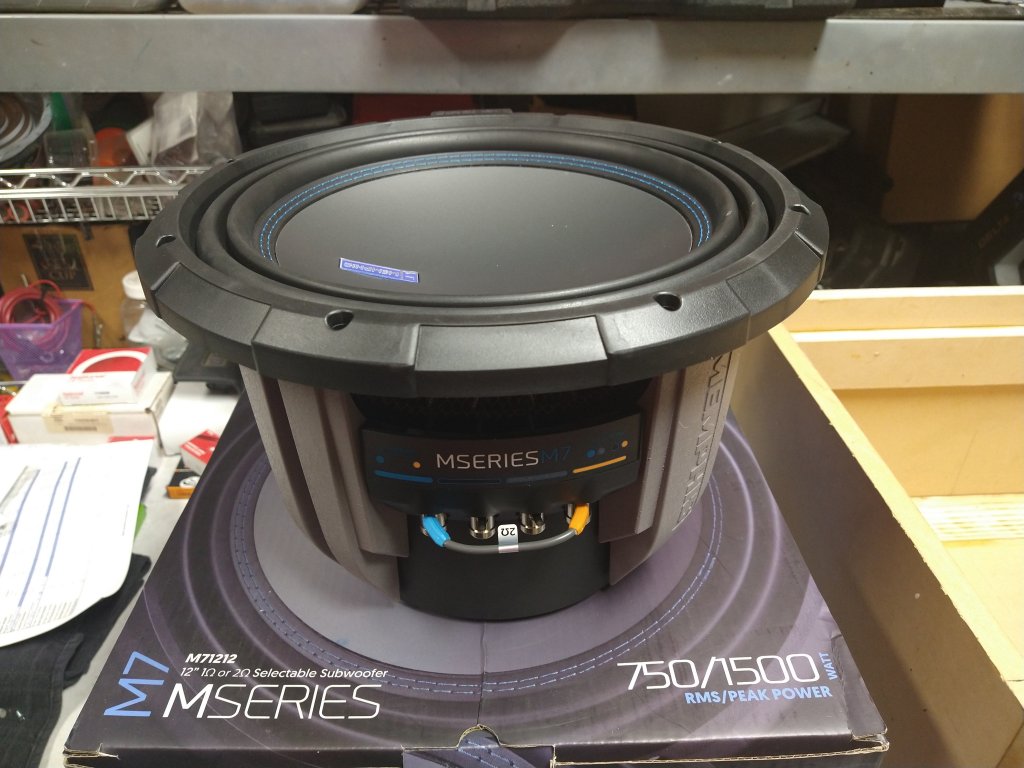

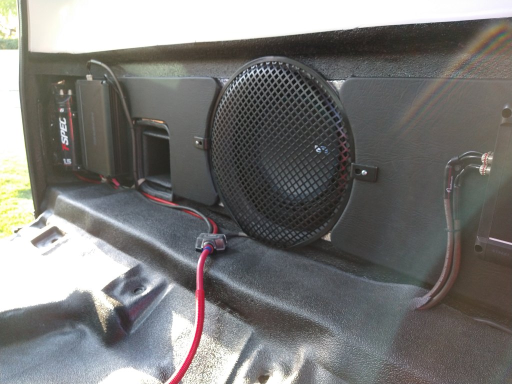

The sub is a 12" shallow kicker personally I'm not a fan of the shallow square box. I just placed an order for an angled truck box that I'm going to try out. I'm really hoping to reclaim some rearward seat movement but we'll see how it goes.
Here is the other side. Don't mind the junk.
3,740
6,770
Didn't you build a box that went into the bed? Could swear I saw that on here. Those are some REALLY shallow subs otherwise. :hat:
Ahh, busted! Lol.
