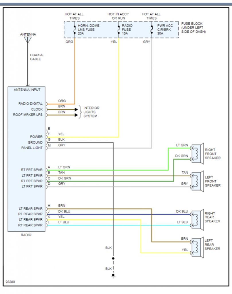

Electrical amateur here, getting that out front. Hooked up old wires that went to the stock radio to an amplifier. Only change was there was a ground wire going to the old radio and no spot on the amplifier for the ground, so just let that hang free. Figured it was just a wire grounding to the chassis so it'd be fine on its own. The amplifier works as is, but as soon as I turn on the headlights the sound cuts out. This is a 1977 GMC Sierra Grande. Looked at the wiring diagrams in the Haynes book and can't see why the headlights would affect this particular circuit. What am I missing?
